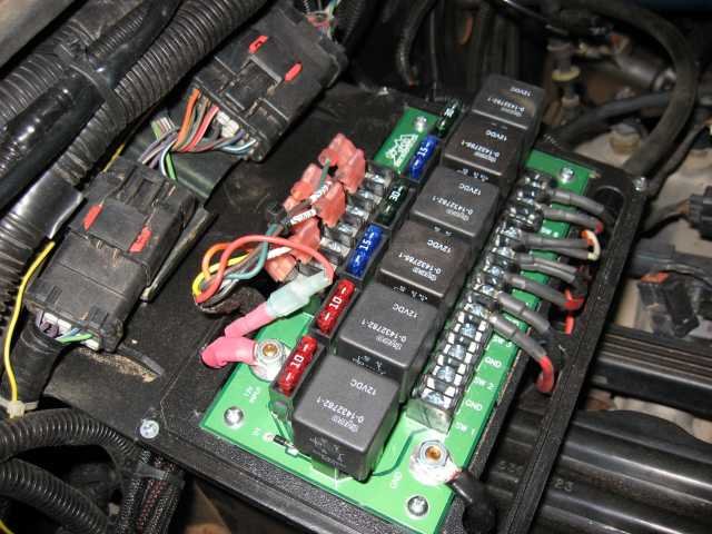

    To use the in cab switch, you need to extend the switch harness into the cab where you want the switch. You will need to run a switched power wire and a dash illumination wire to the switch. Then the out put of the switch will go to the red wire of the ARB harness. And you will need to run a ground wire to the switch also.

    What about in the above video? They are using an sPod.

    Spod is totally different

    If you have an SPOD I would just use that instead of a regular switch

    I have the OTRATTW switch in the cab, with sPod in the bay. I will look, but i want to figure out what part i will need to cut on the ARB harness, to be able to connect a positive and a negative to the sPod. Probably for the one labeled "switch 1" ?

    Switch one is for a solenoid. You want the wires marked isolation switch. Red wire. Why so you need a negative to hook up to the SPOD?

    A positive and negative go to a fuse and a relay. There is 1 pair for each switch, even though on the back of the switch there are multiple attachment points for wires. I think? Dont ask me to explain wiring haha

    Just use the red and black from the harness for the isolation switch
