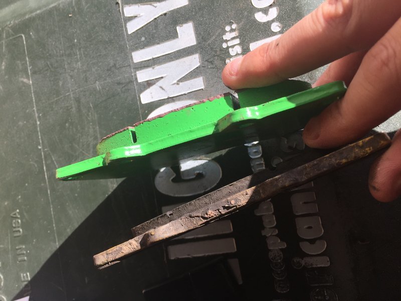

    I think these were ready to be changed?

    What does it mean if the other side was worn more?
    ChadsPride likes this.
  8. Jan 26, 2017 at 4:49 AM
    #708
    stairgod
    stairgod NOOB
    Aug 16, 2015
    #161924
    7,965
    Jo n
    PA/NJ
    2011 MGM Trail Limo
    Locked Boosted 35s
    Caliper issue. Typically I would say yhe calioer sliders needed to be lubed, bit ours have pistons on both sides, so it is a fixed caliper. Pistons on one side could be patially or fully seized, coukd be due to lateral runout of rotor. I would siggest braking harder. A light foot on the brakes can cause the pistons on one side to move more than the other (again if the one side is partially seized)
    Edit. The pads on my pass side did the same thing. I swapped calioers too when I did my brakes.

  11. Jan 26, 2017 at 5:09 AM
    #711
    AR15xAR10
    Apr 13, 2013
    #102024
    56,968
    2013 TRD Sport 4x4 V6 ACLBFTMFW
    Most trucks and SUVs do that. Especially Toyotas. There is more weight on the Driver's side, plus it gets more fluid pressure faster than the passenger side because its closer to the brake booster

    Figured he meant uneven pad wear from same caliper.

  17. Jan 26, 2017 at 11:27 AM
    #717
    stairgod
    stairgod NOOB
    Aug 16, 2015
    #161924
    7,965
    Jo n
    PA/NJ
    2011 MGM Trail Limo
    Locked Boosted 35s
    Keep it up Floyd.
  18. Jan 26, 2017 at 2:08 PM
    #718
    AR15xAR10
    Apr 13, 2013
    #102024
    56,968
    I knew what he meant because mine does it too.
    Years ago, I thought maybe it was a bad caliper on mine until i saw his was doing the same thing
    stairgod[QUOTED] likes this.
