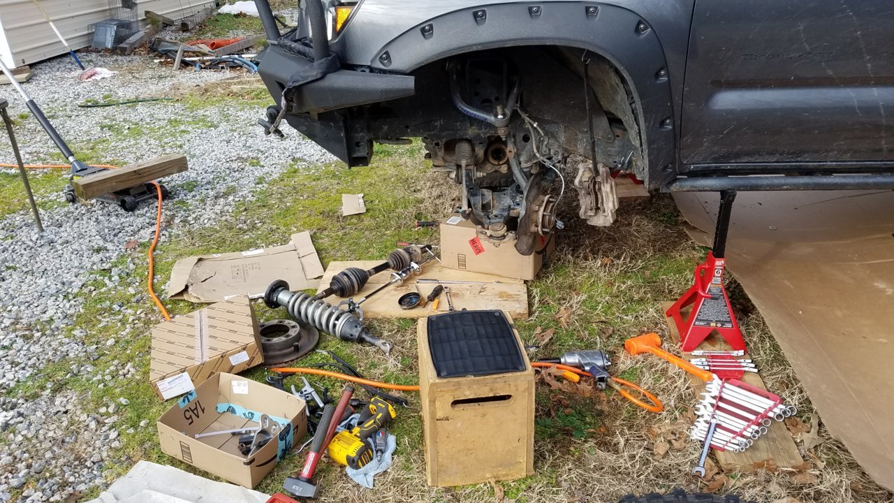

    I unbuildeded today.... Gonna rebuild when its warmer fuck this coldness.

    What is happening? LCA?

    700# springs. Cv reboot, Brake pads, rotors, tie rods.....finally fixing some long overdue items.

    Full refresh. :thumbsup:

    I have heard good things about them, normally I buy OEM used ones off of ebay and then reboot them as needed. I bought some low mileage 2017 cv axles (same axle as ours) and then took the inner boot and slipped it out more and worm clamped it to keep it from rubbing. Leave the outter boot alone as it'll make contact with your strut if you put a worm clamp on it.

    Thats how i have mine now. I have 2 spares that I need to rebuild, but was thinking of getting CVJ

    It was really perfect until the sun hit the treeline. I called it quits after struggling to get the rear 14mm bolt into the top of the shock tower. Turns out you need unfrozen fingers to find that hole o_O
