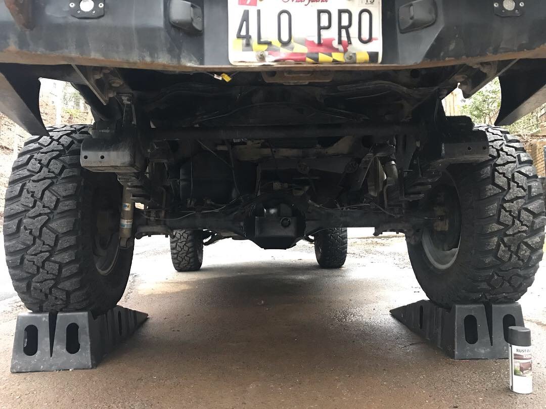

    I took his question to mean if i had hammer hangers.
    They are from @ARCHIVE. Beefy versions of how the rear leafs mount to the frame.
    Another version is a shackle flip, which rotates the shackle and how it mounts to the frame. I don't have pictures of my stock ones. But im sure @EatSleepTacos and @TaKoToy do

    The hammer hangers replace the rear leaf spring holder with a much beefier counter part. It also moves the mounting point rearward and down a little bit, resulting in an increase in articulation. Ride quality is vastly improved because they’re so rigid and allow the rear suspension to act as they should, whereas stock hangers flex a bit.
    Shackle flips get more articulation but have their downsides as well. Those are more geared towards a lightweight truck who’s main purpose is wheeling.

    So Flips and or h.hangers give trucks rear end more wheel articulation ?

    Yes. And @ARCHIVE has both
