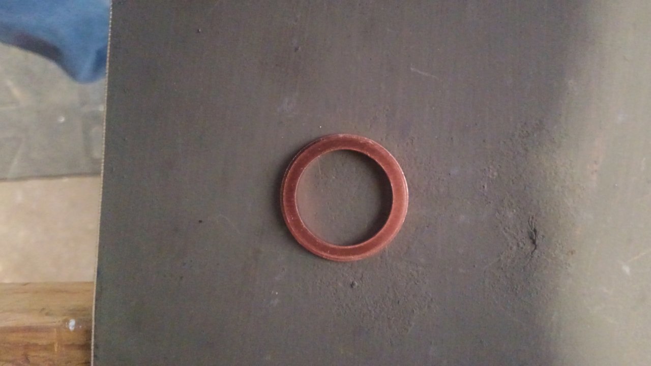

    So I learned that the copper washer for the bottom plug on the front diff is the only copper washer you use.
    All the other plugs on front and rear are metal.
    We made some copper washers at work today and I noticed it was a similar size.

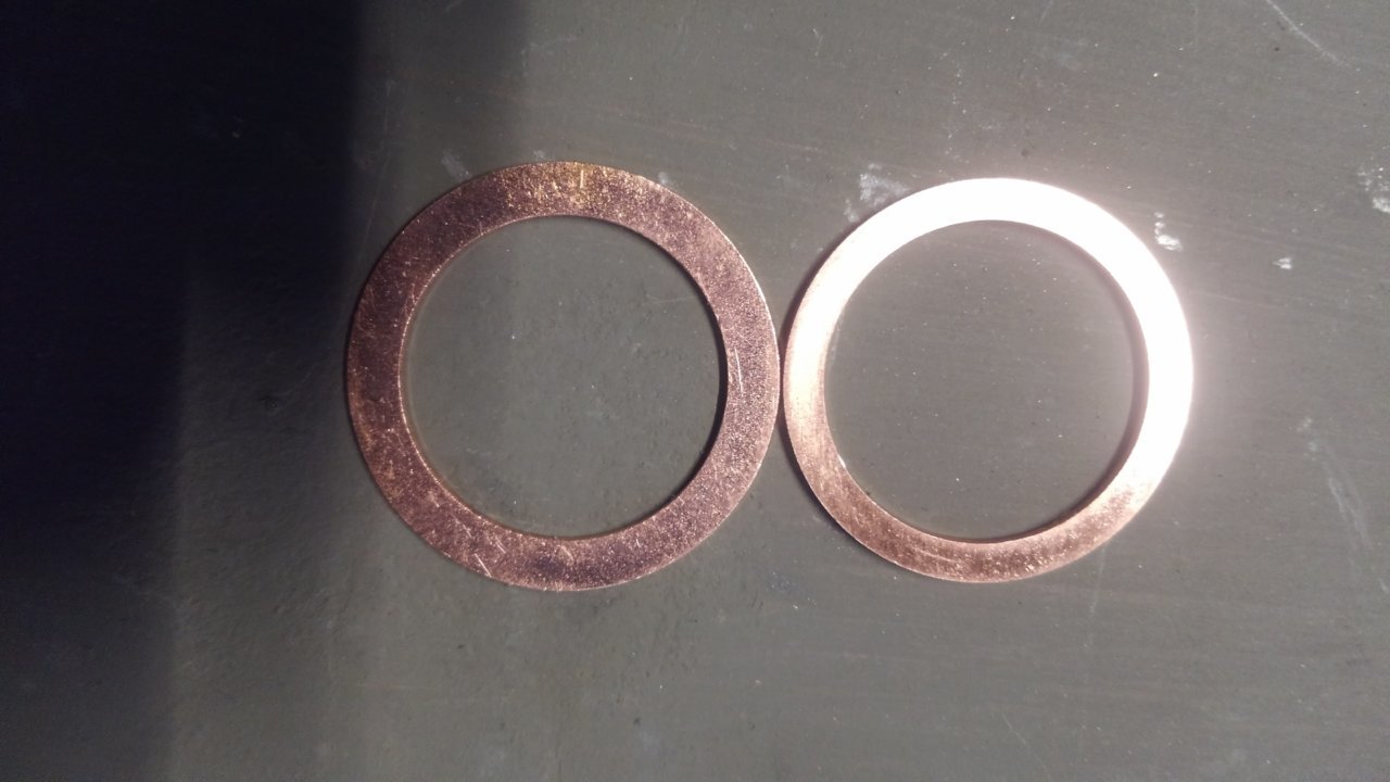

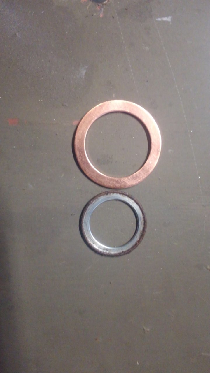

    OEM on the left.
    OEM on the bottom.
    The washers I have are also a few thousands thicker. But Inside diameter is exact.
    If you need exact size I can measure at work.

    Are you sure the rear diff copper washer wasn't stuck to the plug?
    When i went to the dealership, i asked for the washers for f/r diffs, and that is what they gave me. 2x copper, 2x silver crush washers

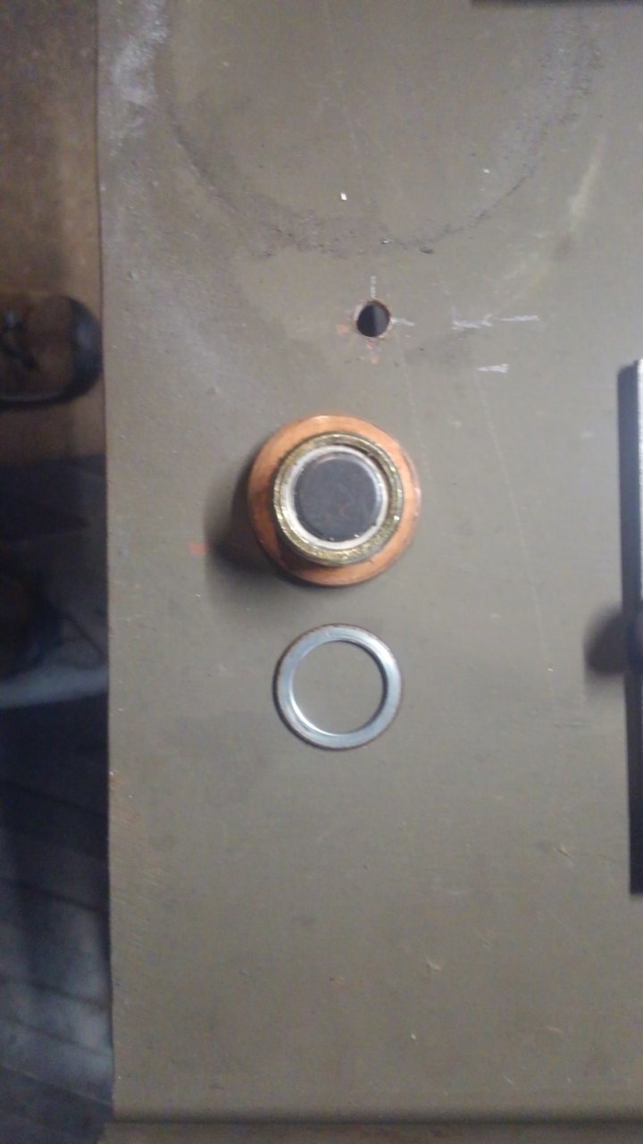

    Yes very sure...the all the plugs on the front and rear diffs are smaller than the front diff plug on the bottom.
    My old front diff plug.

    I don't have the rear, it's in the diff.
    I just tore it apart and that's what I found maybe it is wrong all I know is the big copper washer only fit the front bottom diff plug.
    It doesn't fit my rear bottom diff plug, it was to big.
    The small sliver washer came off the bottom rear diff plug which is shown in the picture.
    Maybe they changed 2010-2011?
