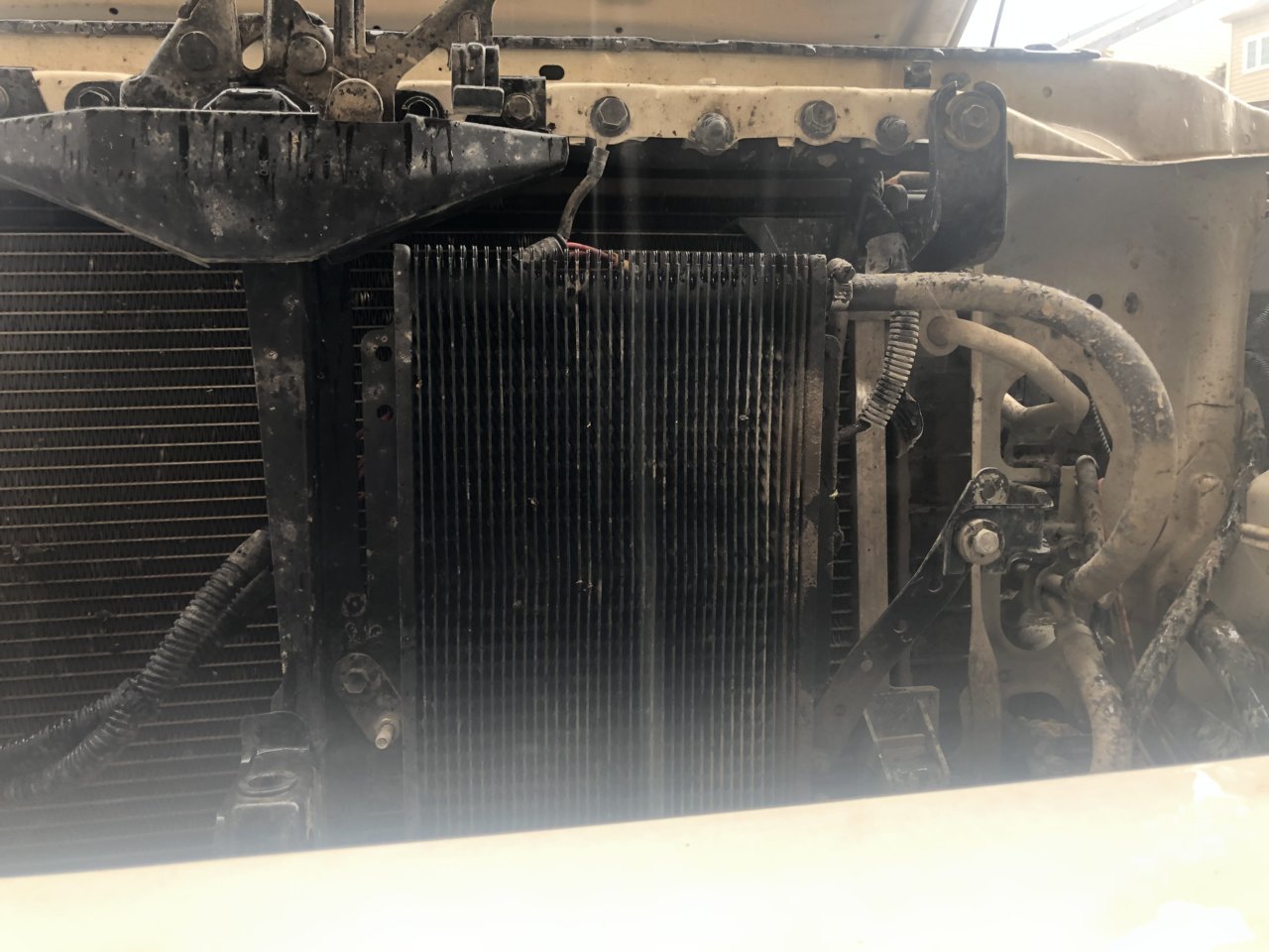

    I have the 18,000 cooler. Normally its 160-180. On hills, it gets to 200 but also by then, i slow down/pull over. Ive burnt the trans fluid before at the beach. So much so, that the AT/Oil light came om

    The CSF should help a bit with that. The larger capacity and design is superior to oem so it should dissipate heat a bit better.
    Do you have a shift kit installed?
    It sounds like your trans is always slipping (at least with 35's).
    In the supercharger tips and tricks thread there is info on the shift kit. With all the weight and big tires you need it!

    Do you have a pic of your trans cooler mounted?

    Ill go get it now for you.

    Cooler looks good.
    Yes, Ratiotek makes one for auto. Look in Supercharger Tips and Tricks thread.
