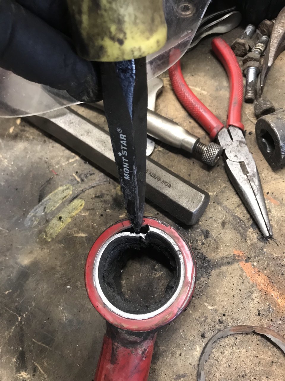

  10. Nov 14, 2019 at 3:39 PM
    EatSleepTacos
    Mar 24, 2015
    #151688
    59,838
    Randy
    West Valley, AZ
    2017 4Runner
    Careful with this method. You can widen the lca by putting too much pressure. I tried this when I rebuilt mine and none of them popped free like expected.
    I took a sawzall and cut off half the bushing.
    Bought harbor freight propane torch that hooks to 20 on tank and burned out the bushing until it was firey rubber dust
    After that, all that’s left is the sleeve. One one side the sleeve rounds out and forms a lip over the lca. Grind that smooth.
    then take a sawzall, cut a slit in the sleeve.
    Hammer and pointy chisel and it comes out.
    These were my uca but same exact process.

    2017 4Runner
    Grease is supposed to go between the poly bushing, and the metal sleeve in the middle. So you have to drop the lca, hammer out the sleeve, clean it up, grease it and put it back in.
