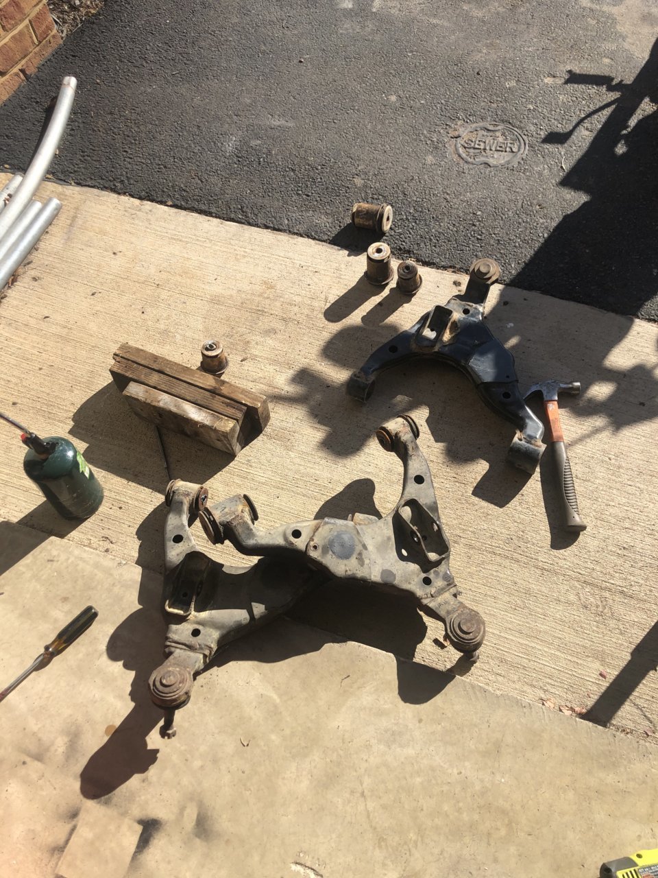

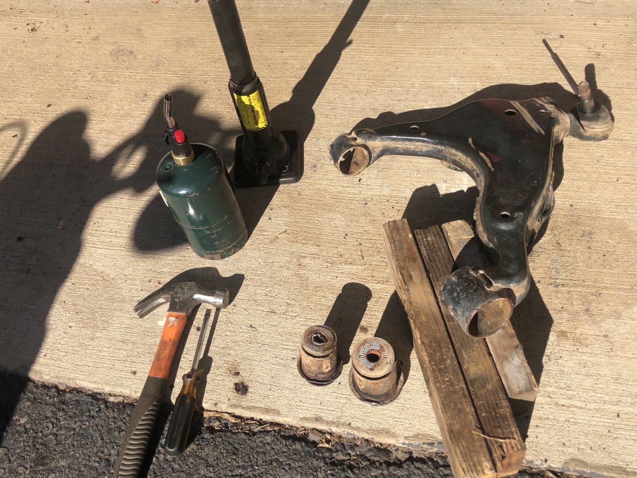

  5. Nov 16, 2019 at 9:08 AM
    fatfurious2
    fatfurious2 [OP] IG: great_white_taco
    Jun 28, 2014
    #132884
    49,824
    David
    Ashburn, VA
    2010 TRD OR Access Cab
    If you take your time, and a little effort turning the knob on the stock jack, the whole bushing comes out. Including the sleeve :yes:
    now to do this to 3 more
  6. Nov 16, 2019 at 9:11 AM
    EatSleepTacos
    Mar 24, 2015
    #151688
    59,838
    Randy
    West Valley, AZ
    2017 4Runner
    Nice, I’m jealous AF that it worked for you!
  7. Nov 16, 2019 at 9:50 AM
    fatfurious2
    Jun 28, 2014
    #132884
    49,824
    David
    Ashburn, VA
    I guess today is LCA day..
