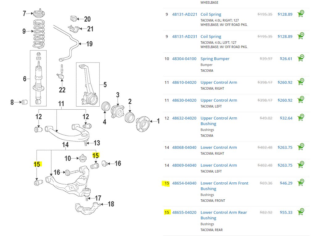

    more notes for my LCA bushing replacements:
    @Wheelspinner
    @Pigpen
    @Unchained 5150
    Thanks for your previous posts on this thread. But I couldnt find any threads where the Moog bushing failed. Any links? I just want to buy the right stuff, so my projects can sell successfully.
    https://www.tacomaworld.com/threads...nd-bushing-part-numbers.403162/#post-11243601
    Ill add @Armyhater458 in here too.
    McGeorge Toyota (online - Georgia) parts diagram. I think its safe to assume that the part numbers are the same for L/R ?

  17. Dec 18, 2019 at 3:41 AM
    Wheelspinner
    Wheelspinner Coco Customs
    Jul 6, 2013
    #107741
    4,371
    Steve
    Northern NJ
    '13 4x4x4cyl
    I’ve never personally never used moog bushings. I know moog caught a lot of hell on here for the replacement LCA hardware. I’ve always used oem LCA hardware. I’ve used oem bushings in @Chux lcas and in my brothers lcas. I actually used the mevotech bushings off of rock auto in my arms. They were recommended to me by another member and have been in my truck for almost 5 years and so far so good.
  18. Dec 18, 2019 at 5:33 AM
    fatfurious2
    fatfurious2 [OP] IG: great_white_taco
    Jun 28, 2014
    #132884
    49,912
    David
    Ashburn, VA
    2010 TRD OR Access Cab
    Thanks. Im not referring to the cam bolts. That will be up to whoever buys these from me.
    I am between Moog and OEM. Since this is a project to resell, im not going to cheap out. I am also in no rush, so i can take my time and get the right stuff. Already chattet with @Crom about not getting Whiteline bushings, due to the fact that they need to be regreased
    mcharfauros and Arcticelf like this.

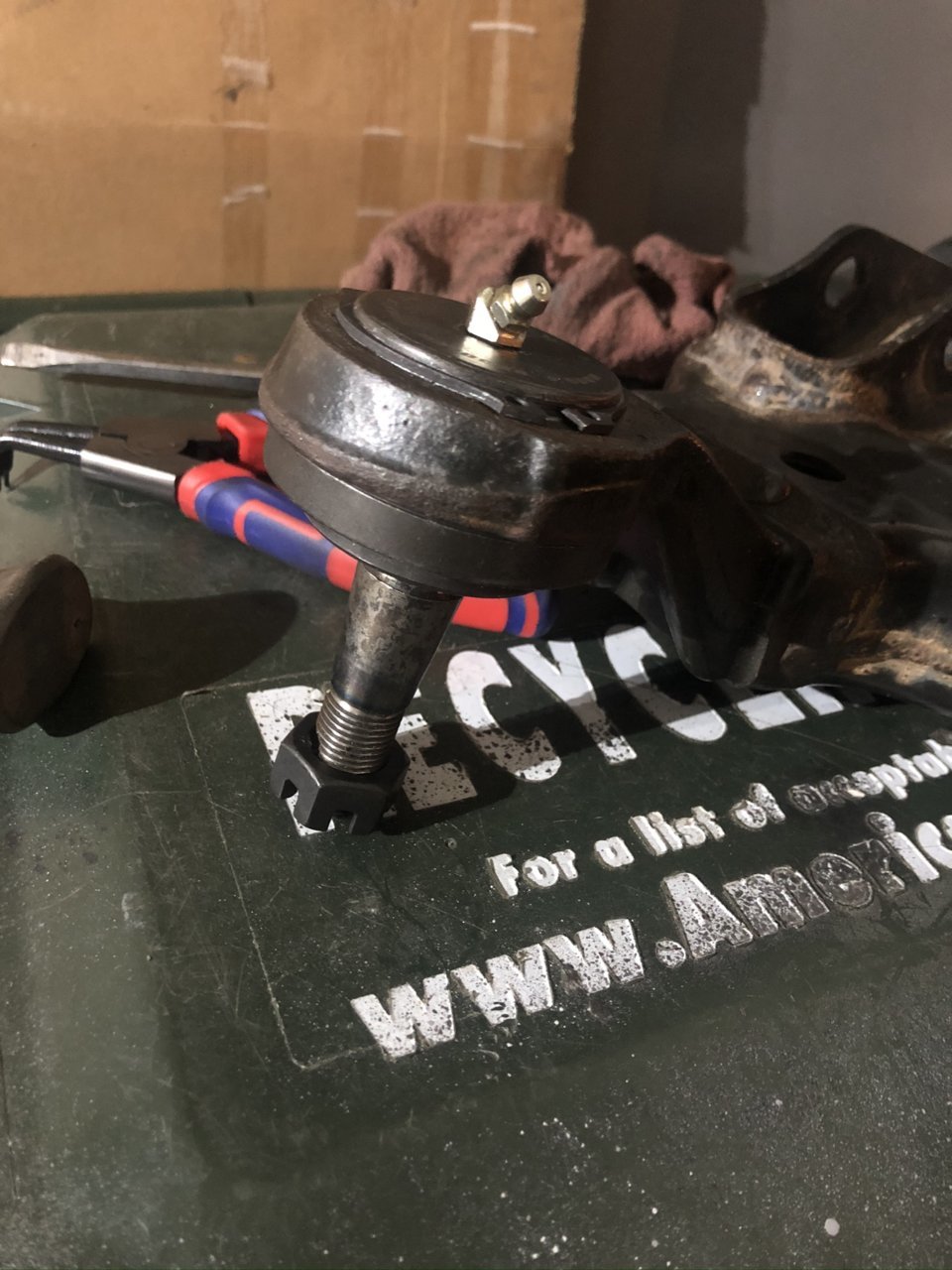

  19. Dec 18, 2019 at 5:40 AM
    Arcticelf
    Arcticelf Well-Known Member
    Jul 18, 2015
    #159735
    7,664
    Gladiator
    I had trouble with Moog LCA ball joints wearing out quickly, but it's a small sample size (4 bushings, attempts at rebuilding the same arms), and we both know how hard I beat the shit out of them, others have had very good luck. I suspect you're better off with Moog, but it really depends on the price/profit difference you'll get between Moog and OEM.
    The other issue I had was in assembly, I don't think this is moog specific, getting them started perfectly straight is really important, if there off even a little the hole in the arm gets hogged out and then the BJ will be a little loose.

  20. Dec 18, 2019 at 5:58 AM
    fatfurious2
    Jun 28, 2014
    #132884
    49,912
    David
    Ashburn, VA
    I have the BJs in. I definitely agree that they gave my new Dewalt 1/2" impact a workout. But theyre in, with antiseize, and the circlips are in too.
    I think they are a new design, because the boot is internal. Ill be including the paperwork with the arms/cotter pin, for the new owner.
