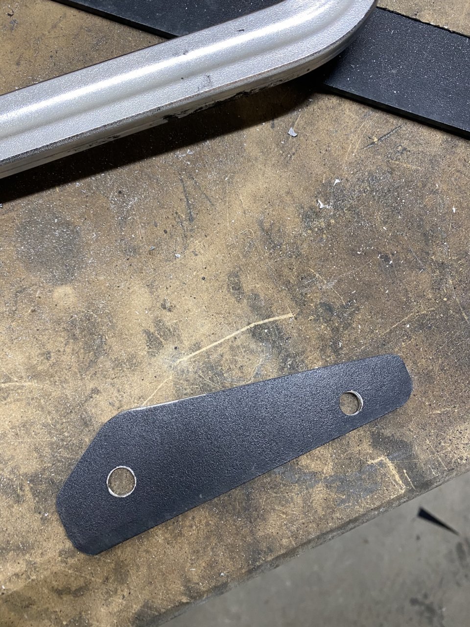

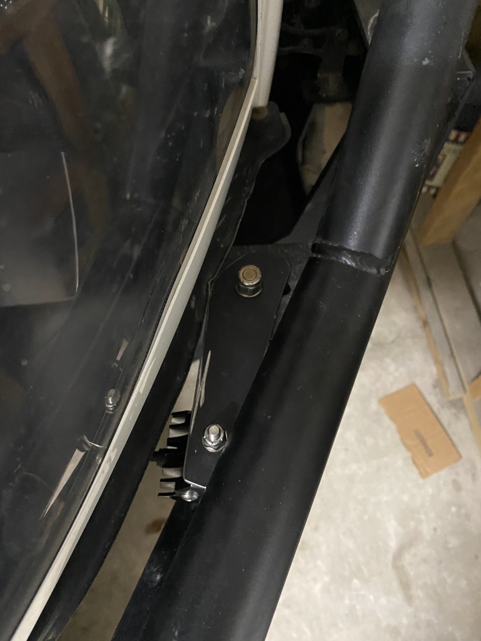

    A little bracket I made myself. just hangs off the existing fog mount.
    66D06E4C-9AC1-4C8B-B694-EFD86F90F10A.jpg 3F56695A-41A1-40B3-8B22-C52FE9293F34.jpg

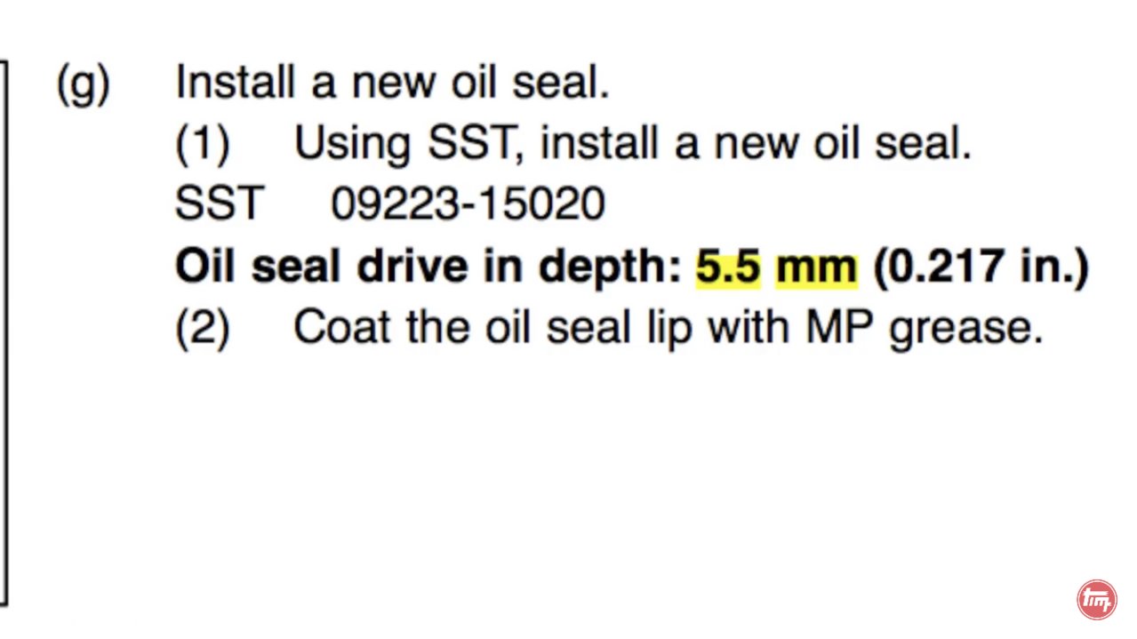

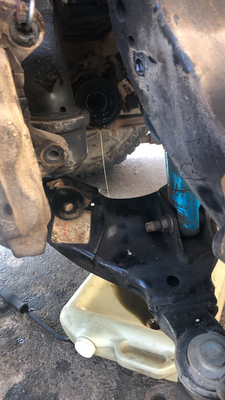

    Passenger side axle leak at the diff.. ordered both diff side seals.

    What oil you using? Mine use to weep with mobil one but never with Lucas :notsure:
  13. Dec 26, 2019 at 6:42 AM
    fatfurious2
    fatfurious2 [OP] IG: great_white_taco
    Jun 28, 2014
    #132884
    49,815
    David
    Ashburn, VA
    2010 TRD OR Access Cab
    Yep, Lucas 85-140. Same stuff that ecgs told me to put in. I guess it was time at 102k miles

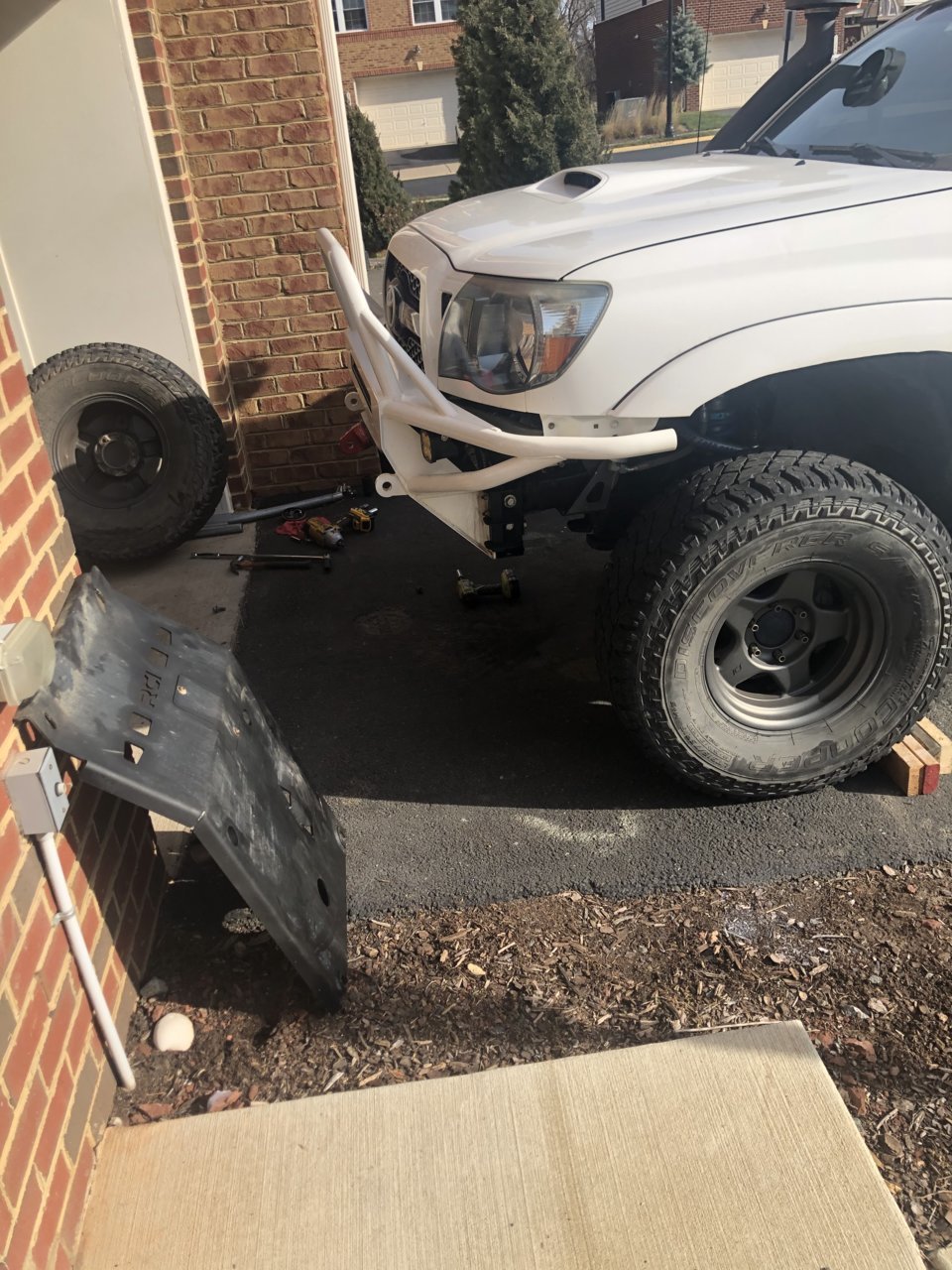

    Ugh. At least its hot in December

    Drip drip
