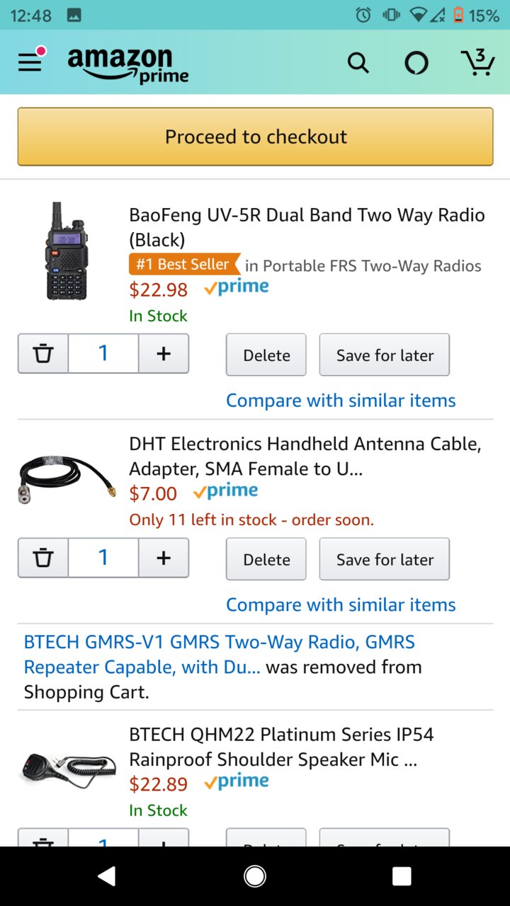

    @m603holden I want to get a GMRS radio. That Btech one is a little out of my budget at the moment, although I should have gotten it when you told me to. I want to hard mount the antenna on the roof rack or on a ditch light bracket. How tall should it be? like a CB 4-5 feet? or can it be the short stubby one? What about that antenna that you gave me?

    TRAM 1267R 5 ½” Magnet NMO Mounting with Rubber Boot https://www.amazon.com/dp/B00E48AGC6/ref=cm_sw_r_sms_apa_i_iT4QEb2FFQE3G
    Tram 140MHz-170MHz + 430MHz-470MHz Dual Band NMO Antenna https://www.amazon.com/dp/B00IDTJ2KE/ref=cm_sw_r_sms_apa_i_cV4QEb4KTC8CD
    Probably the cheapest way to do it. They make lip mount brackets for around $45 that you can also put in the rack. I wouldn't go with anything less than that because then they get brittle.
    If you end up with a handheld gmrs you'll just need an SMA to so-239 adapter. I can give you a link if you'd like.

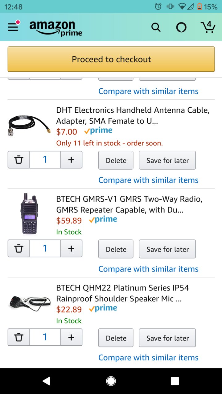

    Also, here's what you're looking at if you don't have a radio. The more expensive one is a legit gmrs radio. The cheaper one is a Chinese no frills radio. That one you'll have to program the channels yourself. It's not hard.
    I suggest getting a hand speaker mic. Holding up all that cable from the coax sucks. Just toss the radio in a cup holder and forget about it.
