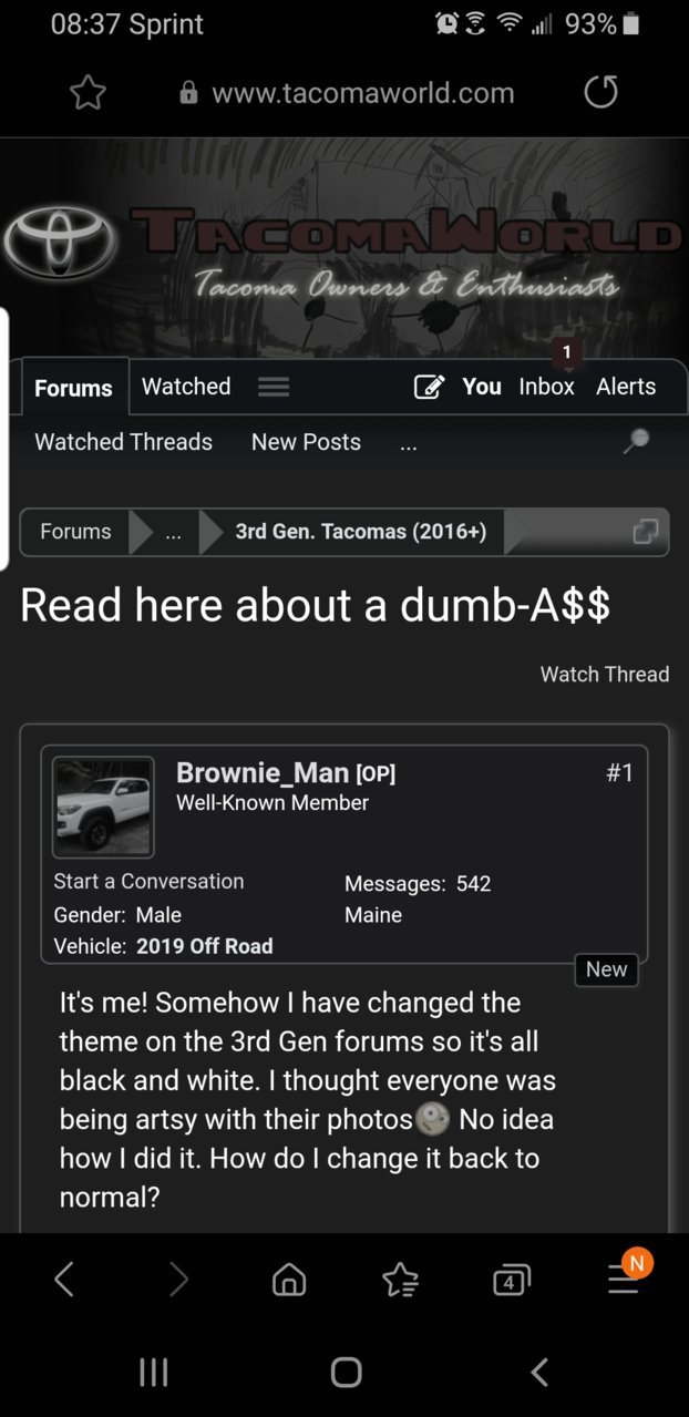

    Interesting...I think old Bob pulled the switcharoo on my screen shots.

    The screen shots only appear fine for yourself because you’re mirroring the mirror. For the rest of us, your screenshot is wrong/backwards.

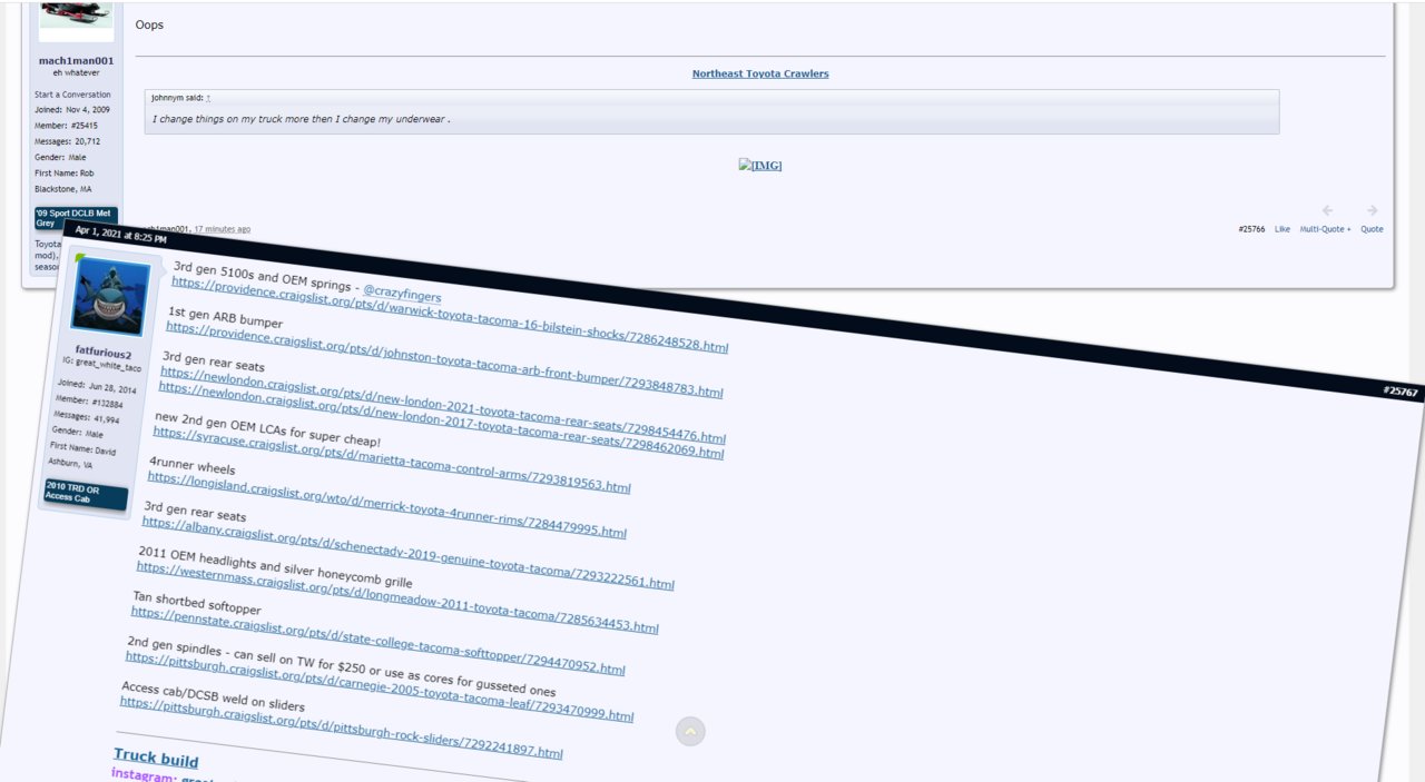

    Now look at what happened! @mach1man001 comment applies!

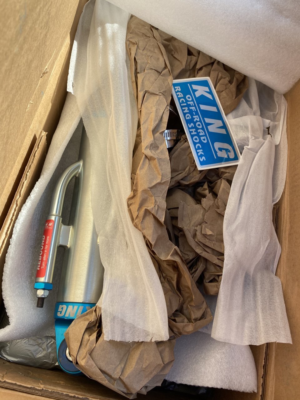

    What are the numbers? Compressed and extended?

    Ive been trying to find specs for a while. I believe they are 2.0x6 2 tube bypass shocks. Part number TC1119-25 if you want to try to find info. Ill reach out to total chaos too, because id like to know. They are bypasses for stock width

    You could just bust out a tape measure and check lol

    This is true. What about the compressed numbers?

    Measure eye to eye extended, then subtract 6” (assuming it’s a 6” shock). It looks like they’re not charged with nitrogen though since they’re compressed in the pic so you could just manipulate them by hand and take measurements
