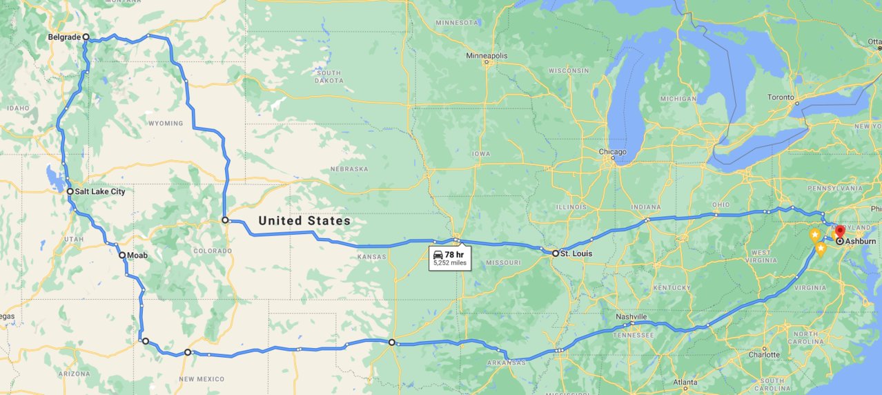

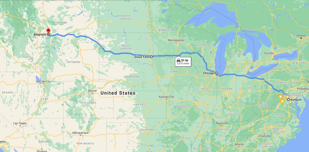

    Yea definitely!

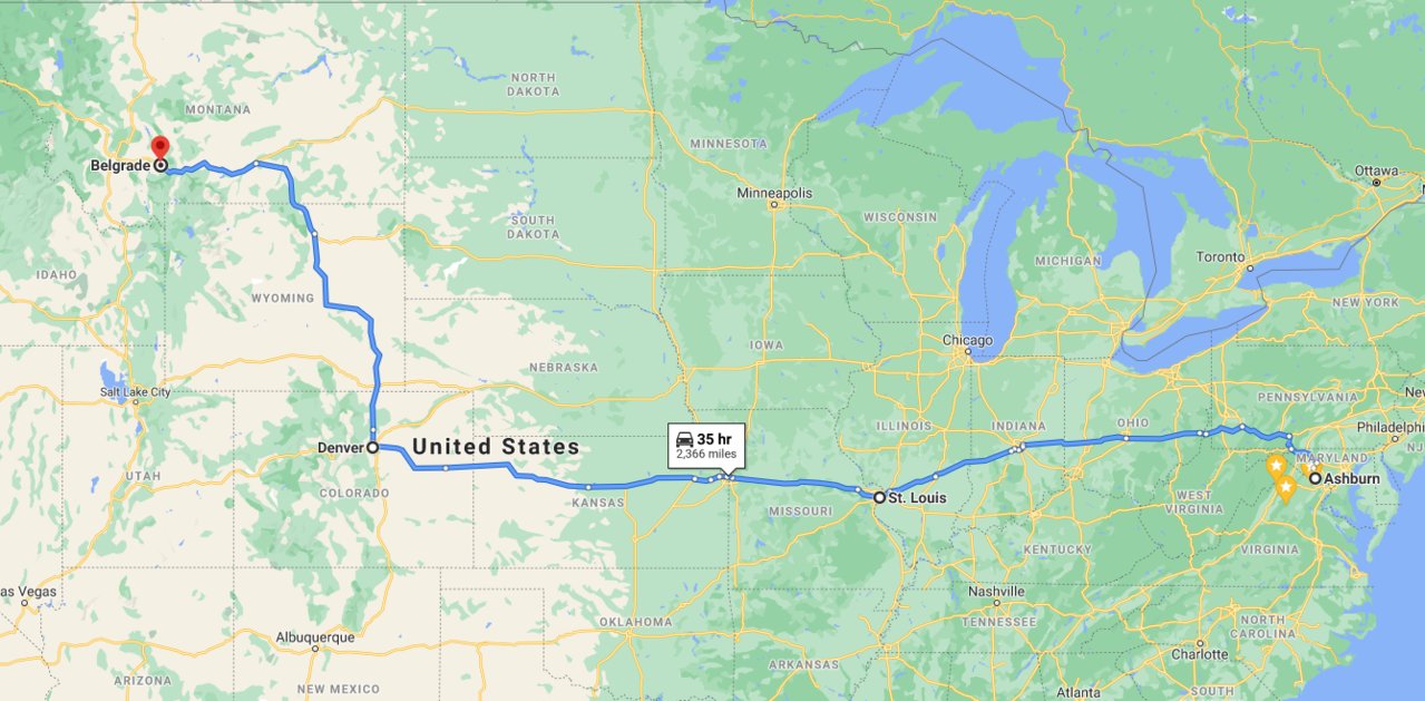

    Im leaning towards the northern route because im aiming to get to Montana in 3.5-4 days. If I can save 4 hours of driving, ill do it. Then just go to the places that Id rather go to, on the way back. I'll also be taking my time on the way back.

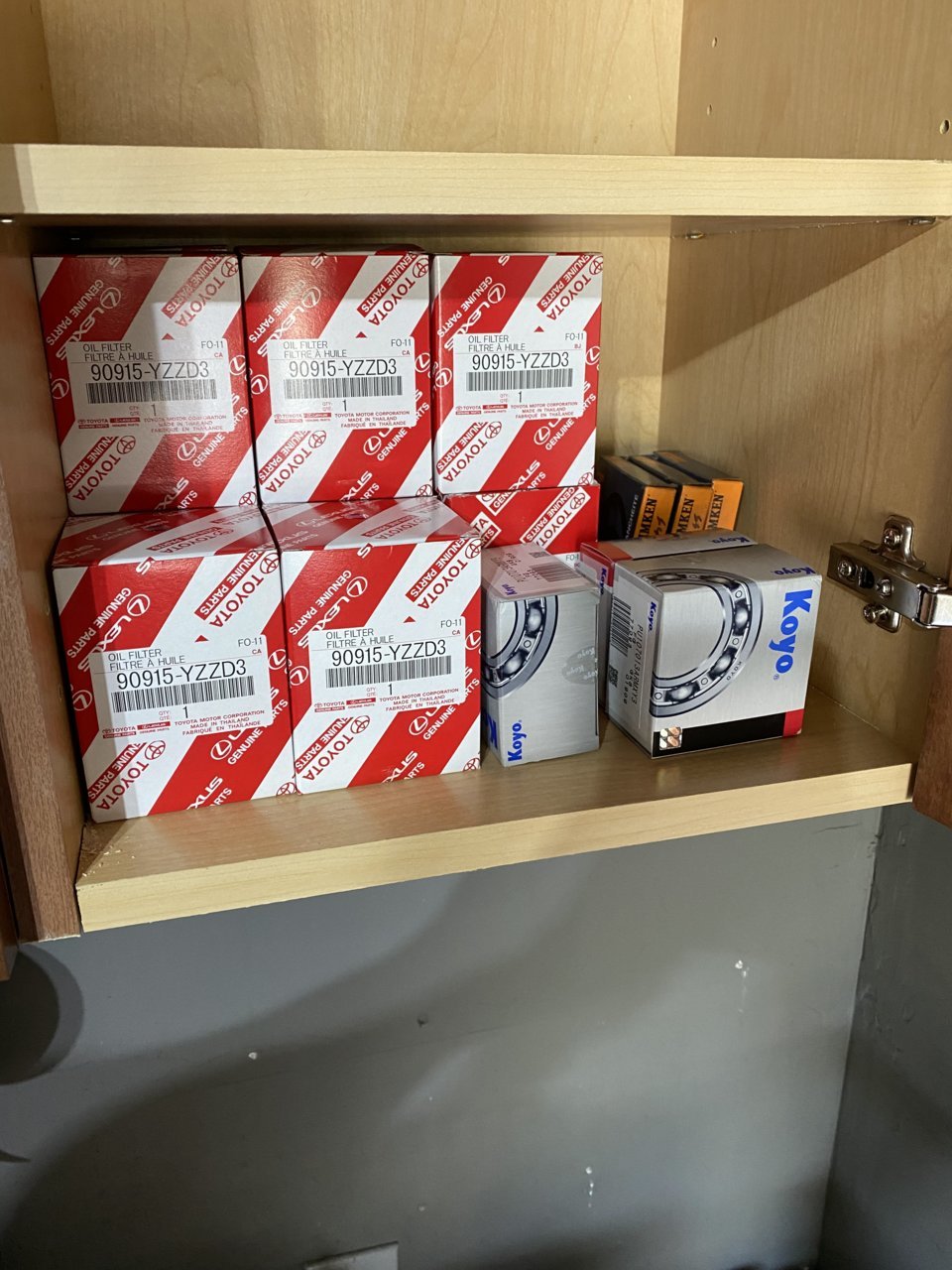

  6. May 28, 2021 at 12:23 PM
    fatfurious2
    fatfurious2 [OP] IG: great_white_taco
    Jun 28, 2014
    #132884
    49,837
    David
    Ashburn, VA
    2010 TRD OR Access Cab
    God i love this truck
  7. May 28, 2021 at 2:07 PM
    HomerTaco
    Mar 28, 2010
    #34129
    45,874
    HomerTaco
    HomerTaco
    HomerTaco
    been there, done that. :D
    I'm looking to go out west in late August or early September.
    The 1st choice is better, Same route I took to meet up with @MTgirl years ago.

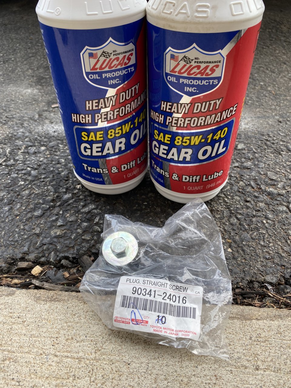

  16. Jun 13, 2021 at 4:21 PM
    fatfurious2
    Jun 28, 2014
    #132884
    49,837
    David
    Ashburn, VA

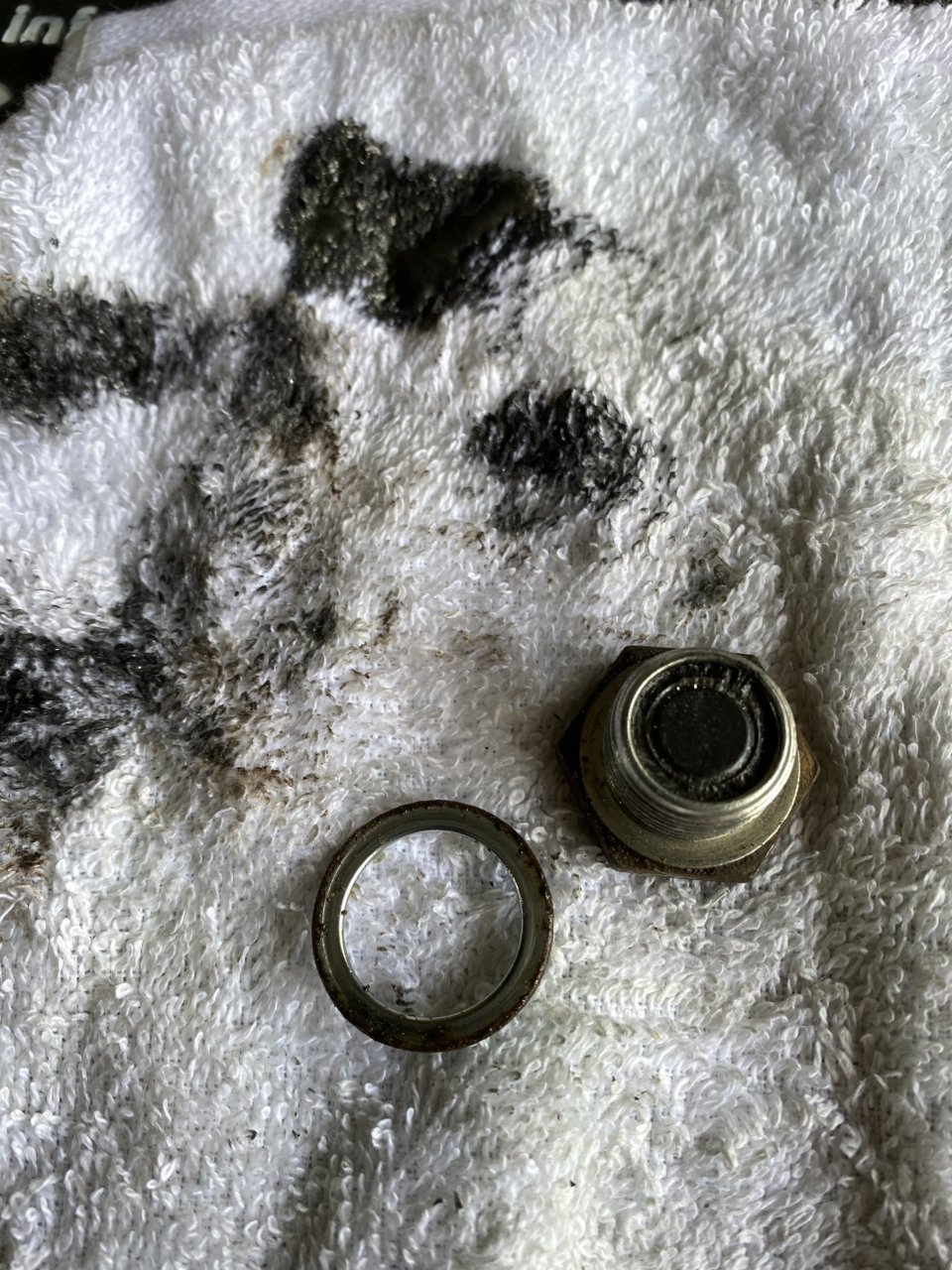

    Rear diff done. Now onto the front. Make sure to clean both fill and drain with a pick. Then crack the fill first, then drain plug. Im replacing my drain bolt with this one from a Lexus.
    rear diff: 4.2 qt
    Front diff: 1.1 qt
    Tcase: 1.1 qt of 75w90
    mcharfauros and Bastek like this.
