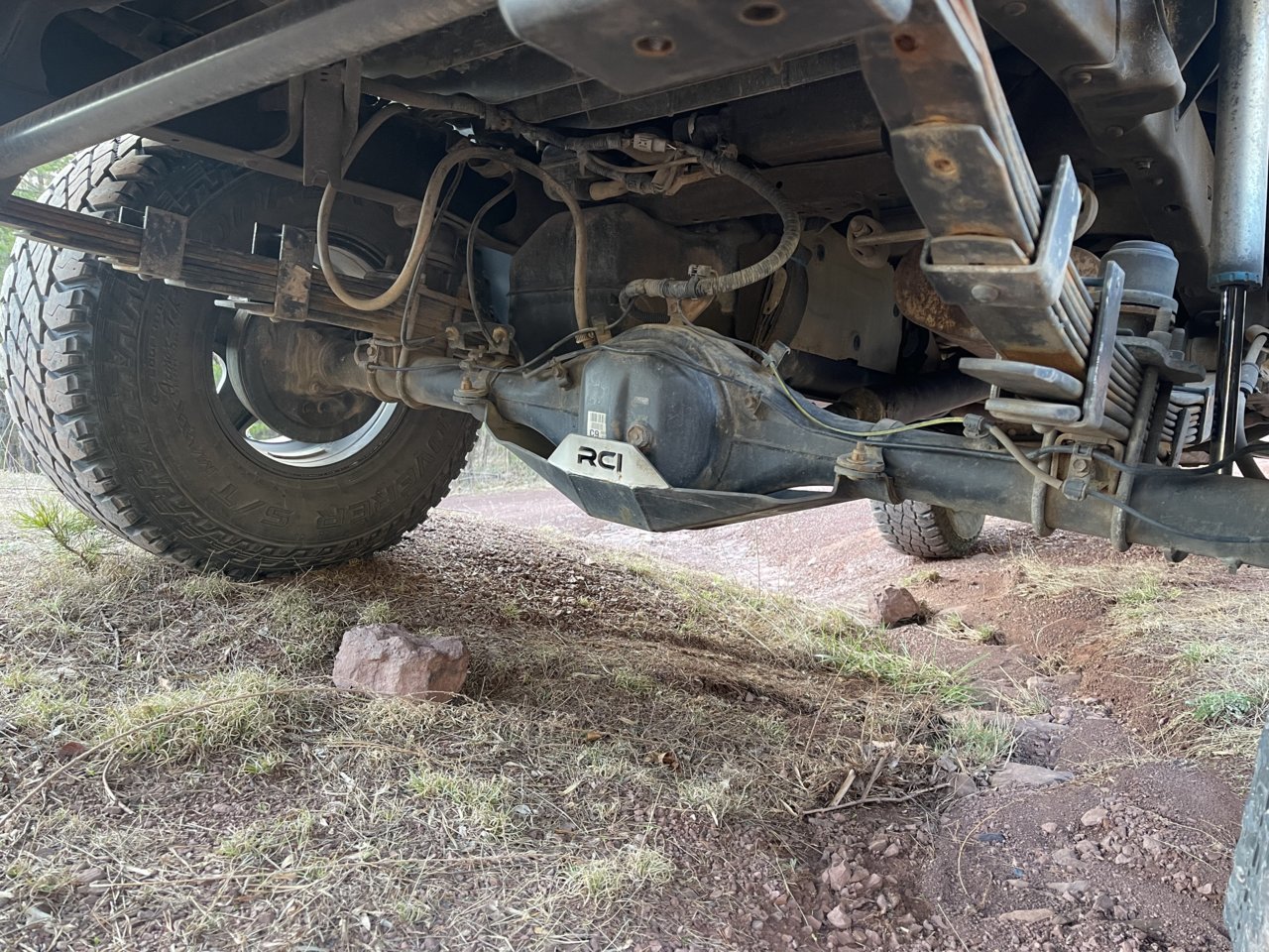

    I think less than in chi-town. Will reassess. This is the most recent picture of the rear. I am planning on buying some por-15 to touch up some places on my frame/axle

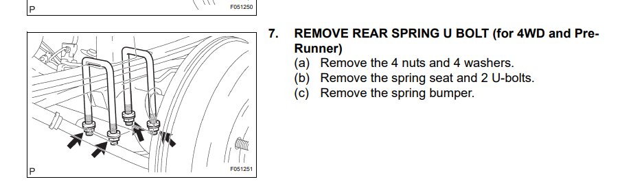

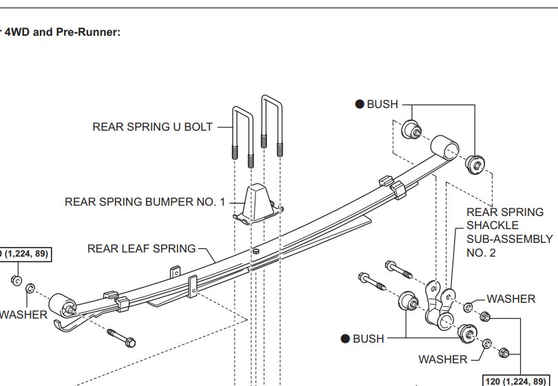

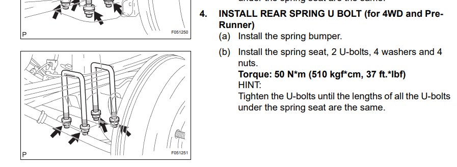

    Out of curiosity, I looked at the FSM, which annotates a non-reusable part with a black dot next to it. See "bush" for example. No mention of the U bolts being one-time use here or in the disassembly/reassembly instructions.

    Probably because some u bolts can't be reused in certain applications. I have yet to see any manufacturer of tacoma u bolt flips say to not reuse it though, and daddy Toyota says you can reuse the factory ones, so I'm gonna just keep reusing them.
