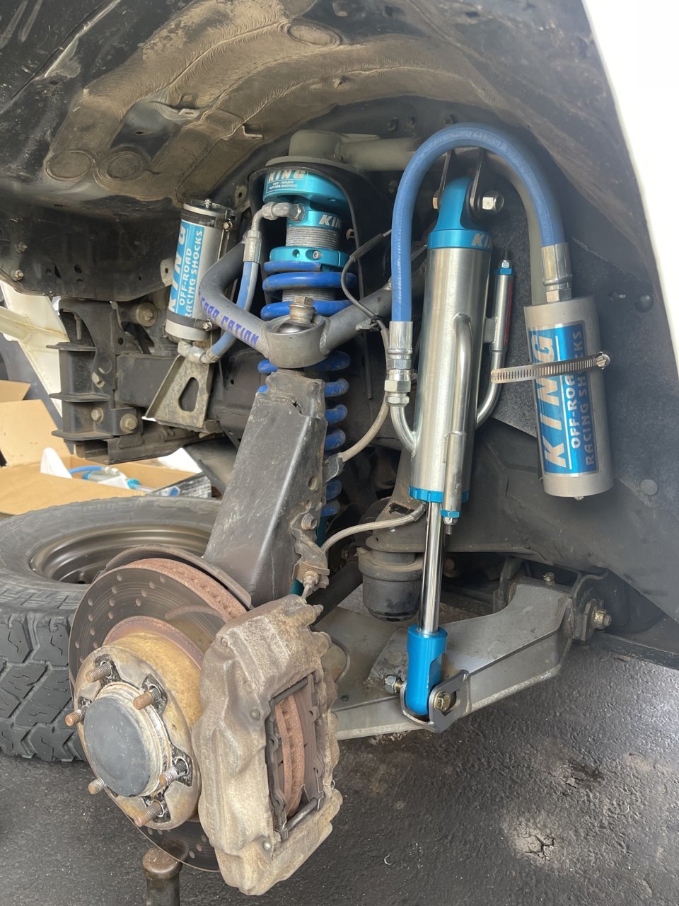

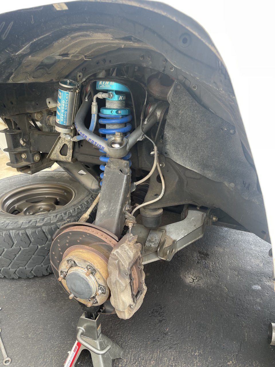

    Making progress on this new project. Burned in passenger side today. Confirmed with Total Chaos that my giant tires will probably warrant spacers, so I ordered these (on recommendation from @EatSleepTacos )
    https://www.wheeladapter.com/product/extended-wheel-studs-for-toyotas-set-of-12
    And a pair of Bora 1/2" slip on hub centric wheel spacers.
    only things left to do is weld on the resi mounts on both sides, then pop out to my friends place in Maryland for a revalve. So close to cadillac smoothness :rofl:
