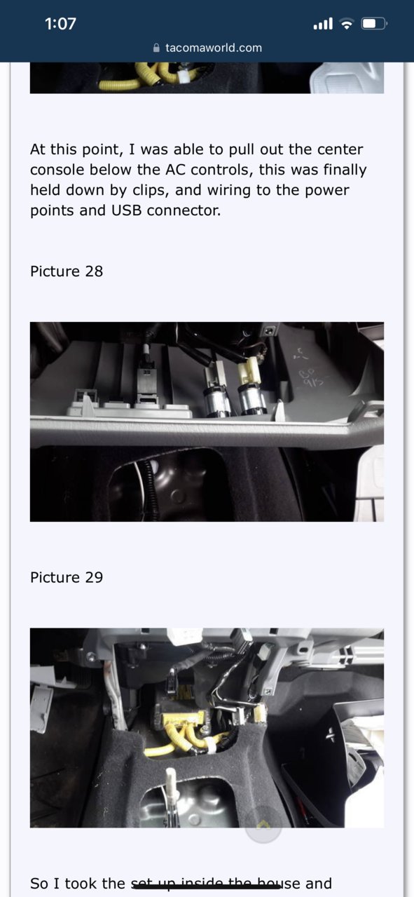

    @theolee I think im going to swap my lower dash panel soon. Did you have a writeup on it?

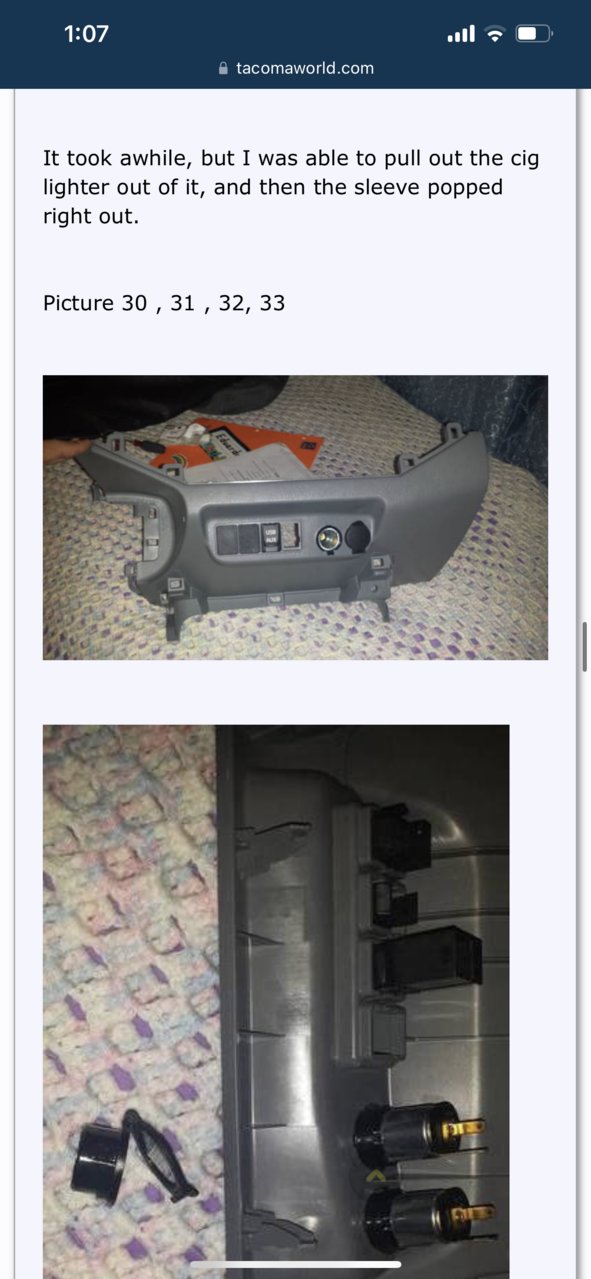

    I never finished the write up. I can locate something! Are taking out the lower part where the 12v accessories are?

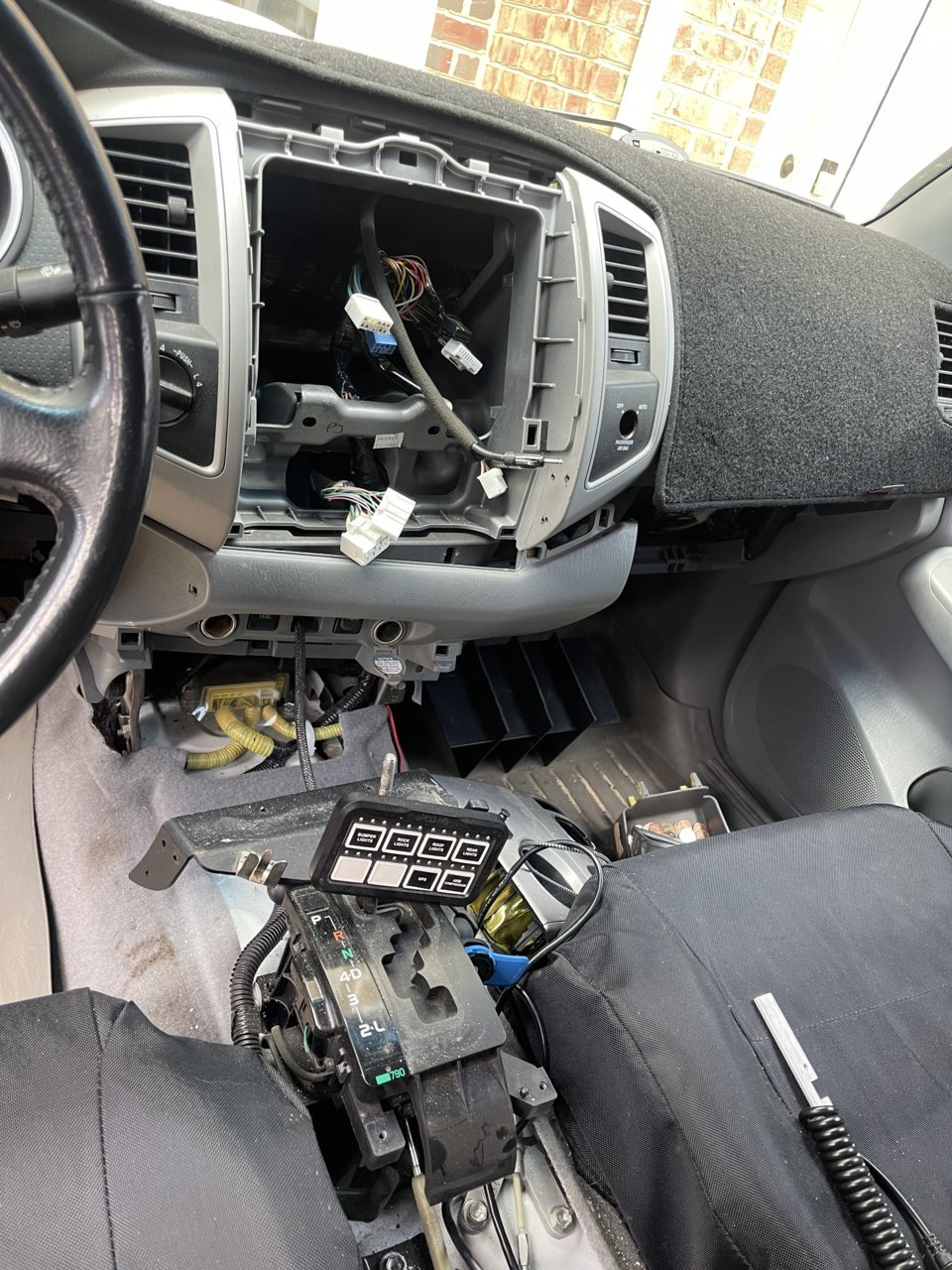

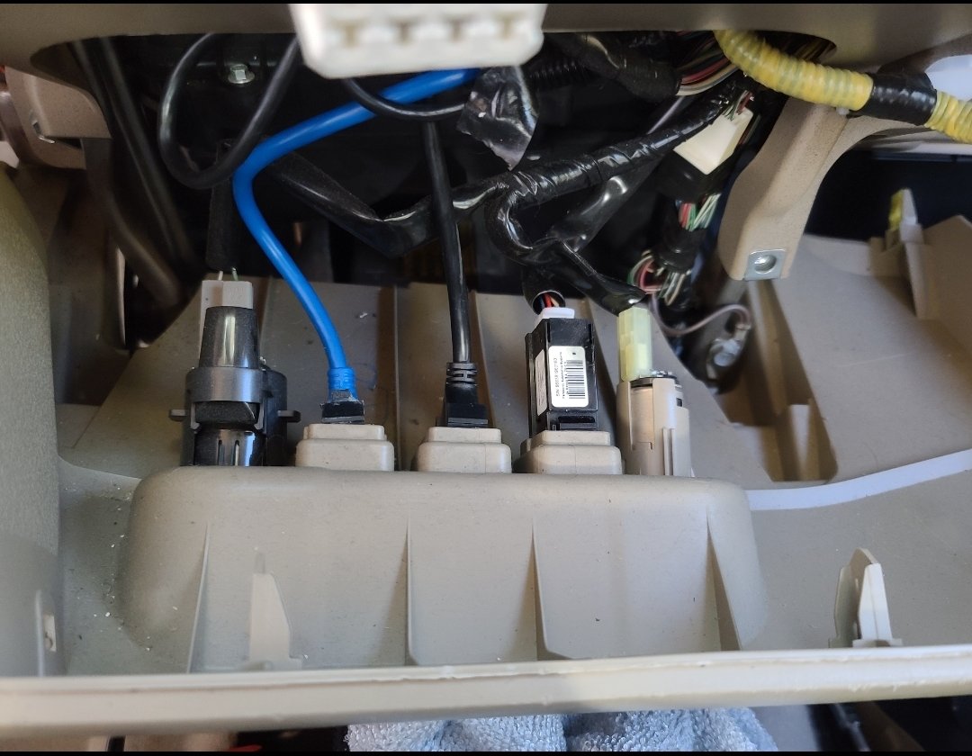

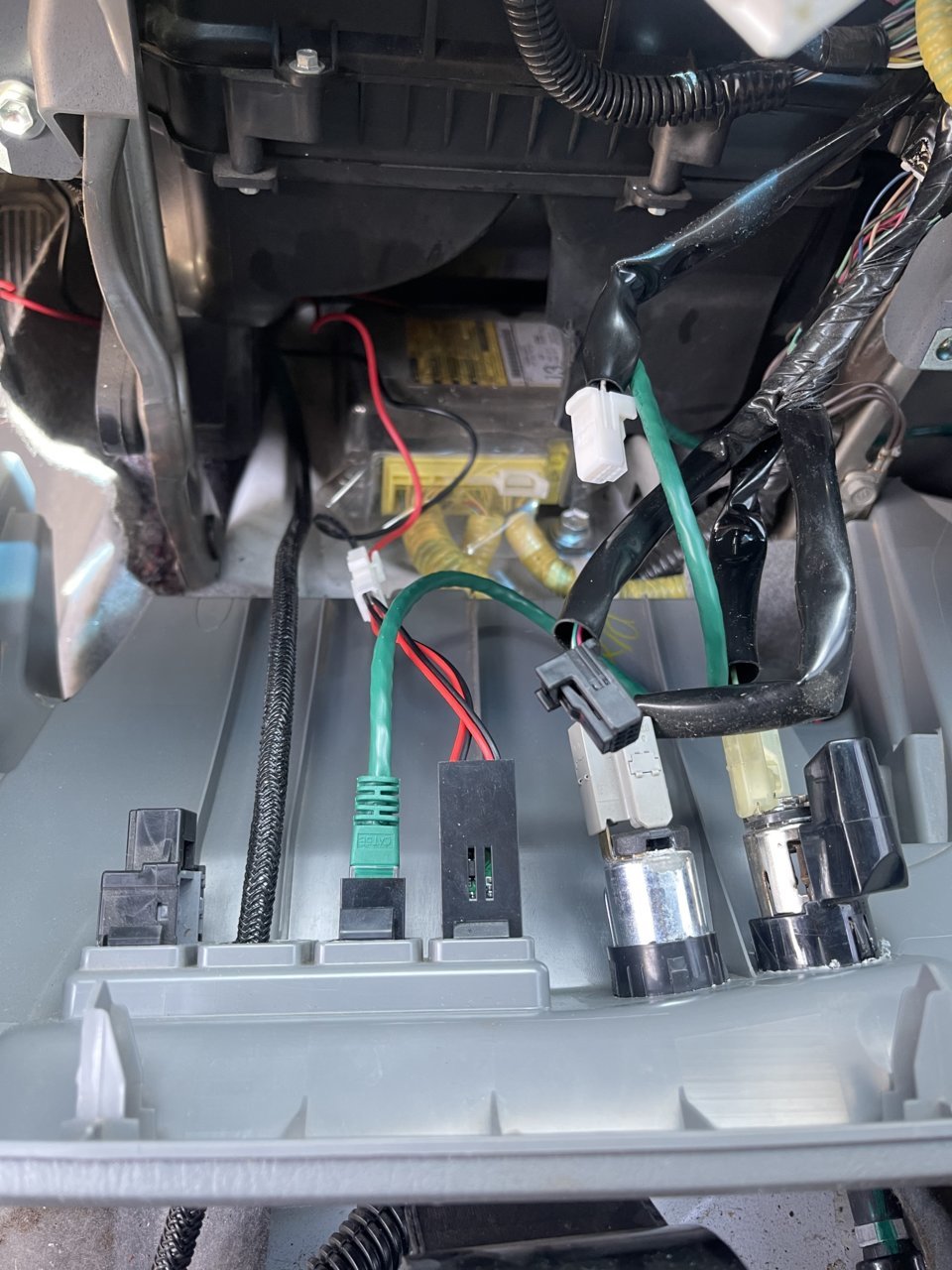

    Im halfway through and see that the aux and a-trac have the same plug. Im stuck right now as I didnt take any pictures before unplugging things.
    I think black and white go together. Can you find any schematics for wiring color references?? Im not putting the aux back in
    black plug has a green wire
    White plug has a blue wire

    This might be it! @ramonortiz55 ftw with the pictures!
    :fingerscrossed::fingerscrossed::fingerscrossed:
    black connector to USB Aux

    Nice, I look! That lower dash is a pain in the ass to get to.
    I noticed you have two different pictures of a lower dashe there. A 2.0 gen and 2.5 gen, which one are you using?

    Putting in a 2.5 in my 2.0

    So I think its black to A-trac because when i press the button, i get no lights in 4lo :frusty:
    too damn hot to fix it now. Plus i havent been wheeling where I need it, in forever.
    but now we know.
    BLACK - A-trac
    WHITE - Aux

    Oh no! Yeah you're right, I looked at mine and thought I saw black and it's white. Sorry about that.
    Relocated trac?

    I wonder if i could get to the plugs without taking the radio out. I would need some tiny hands, and for the weather to not be 90 degrees and 51% humidity. I think i got sunburned too
