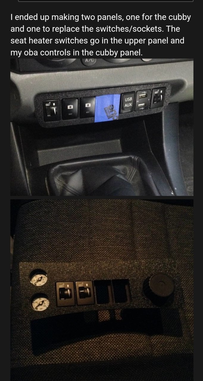

    Tiny hands would be great. I'm trying to find a thread I saw where a guy used dental wires or something to pull the plugs. Pretty slick.
    On my journey I saw this too.
    And hears the write up I used when I pulled everything apart.
    https://www.tacomaworld.com/threads...enter-console-clean-look-lots-of-pics.306779/

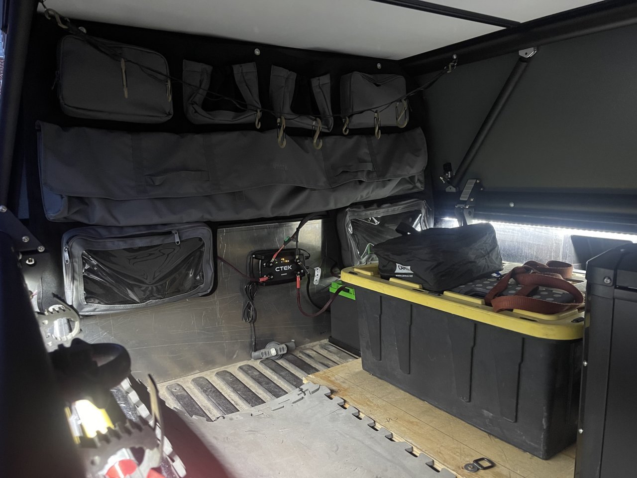

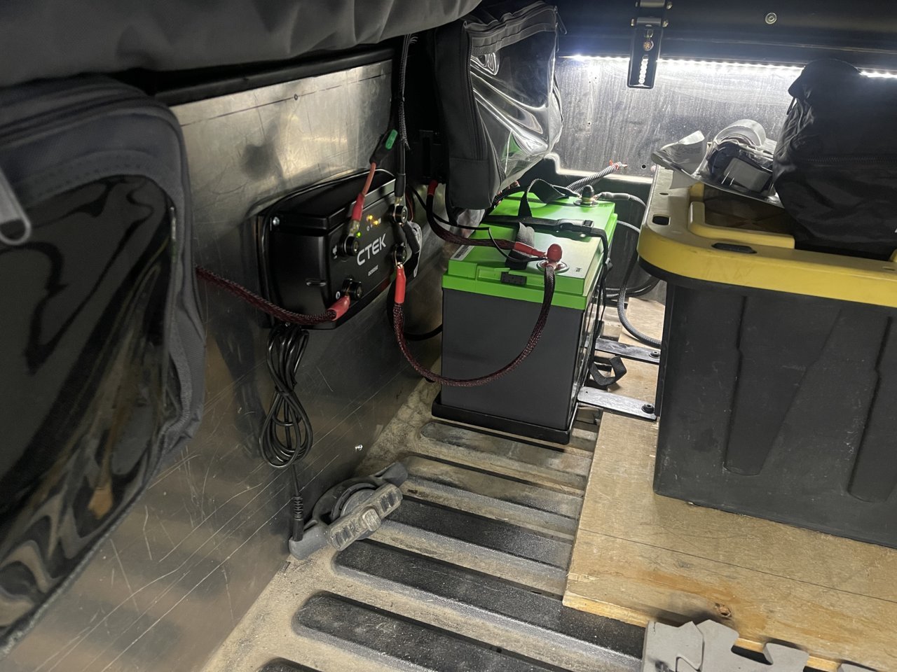

    Set the mood with lights. Nothing is sliding around anymore. I still plan on adding a monitor to see what im using/taking in. But its done for now

    Nice and neat!

    Not sure if you have to , but I think you should/ or suppose to tape that temp sensor to the battery.
  12. Jun 13, 2022 at 6:46 PM
    fatfurious2
    fatfurious2 [OP] IG: great_white_taco
    Jun 28, 2014
    #132884
    49,845
    David
    Ashburn, VA
    2010 TRD OR Access Cab
    Ahh yea, i will

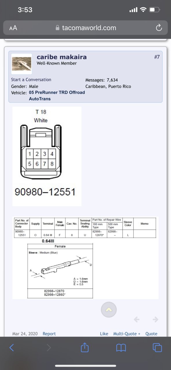

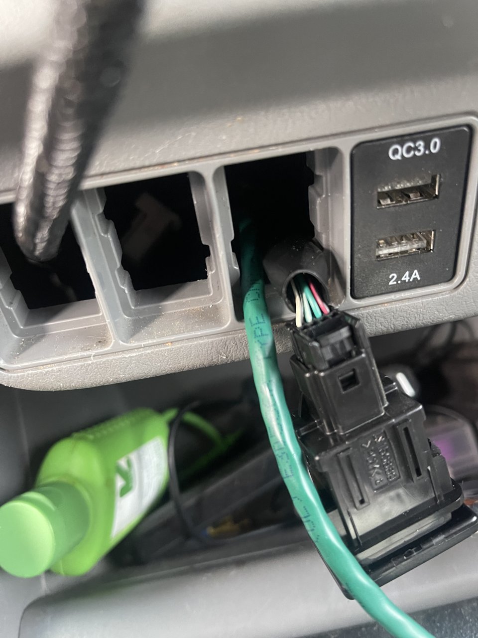

    @theolee
    Wait, i had the white plugged in.
    Anyways, decided to try to switch to the BLACK, and was able to get it with needle nose pliers and a few picks
    got it! 09-11, or at least my 2010 has the black plug for a-trac. :bananadance:
