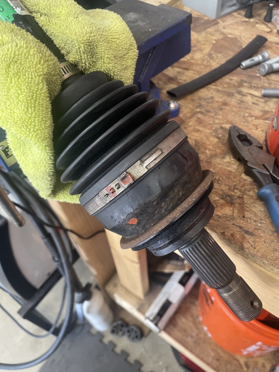

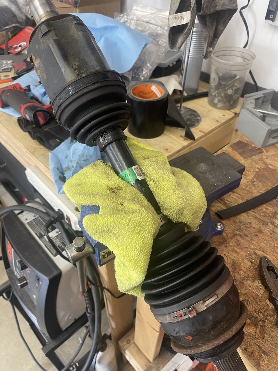

  17. Aug 26, 2023 at 7:53 AM
    fatfurious2
    fatfurious2 [OP] IG: great_white_taco
    Jun 28, 2014
    #132884
    49,818
    David
    Ashburn, VA
    2010 TRD OR Access Cab
    Axle work today
    d.shaw, AR15xAR10 and Bastek like this.

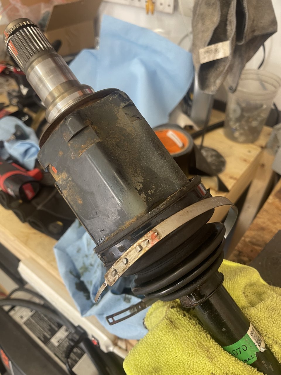

  20. Aug 26, 2023 at 1:30 PM
    fatfurious2
    Jun 28, 2014
    #132884
    49,818
    David
    Ashburn, VA
    So I think someone took the big ear type clamp and replaced it with the roll type. :mad: Sucks. Gotta see if I can order the clamp separately
