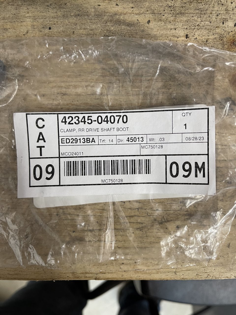

    CV boot clamp saga continues... the band part number is:
    Cv Joint Boot Band - Toyota 42345-04070
    And its $10. So I had to order 2 to make the shipping worth it. Ugh.

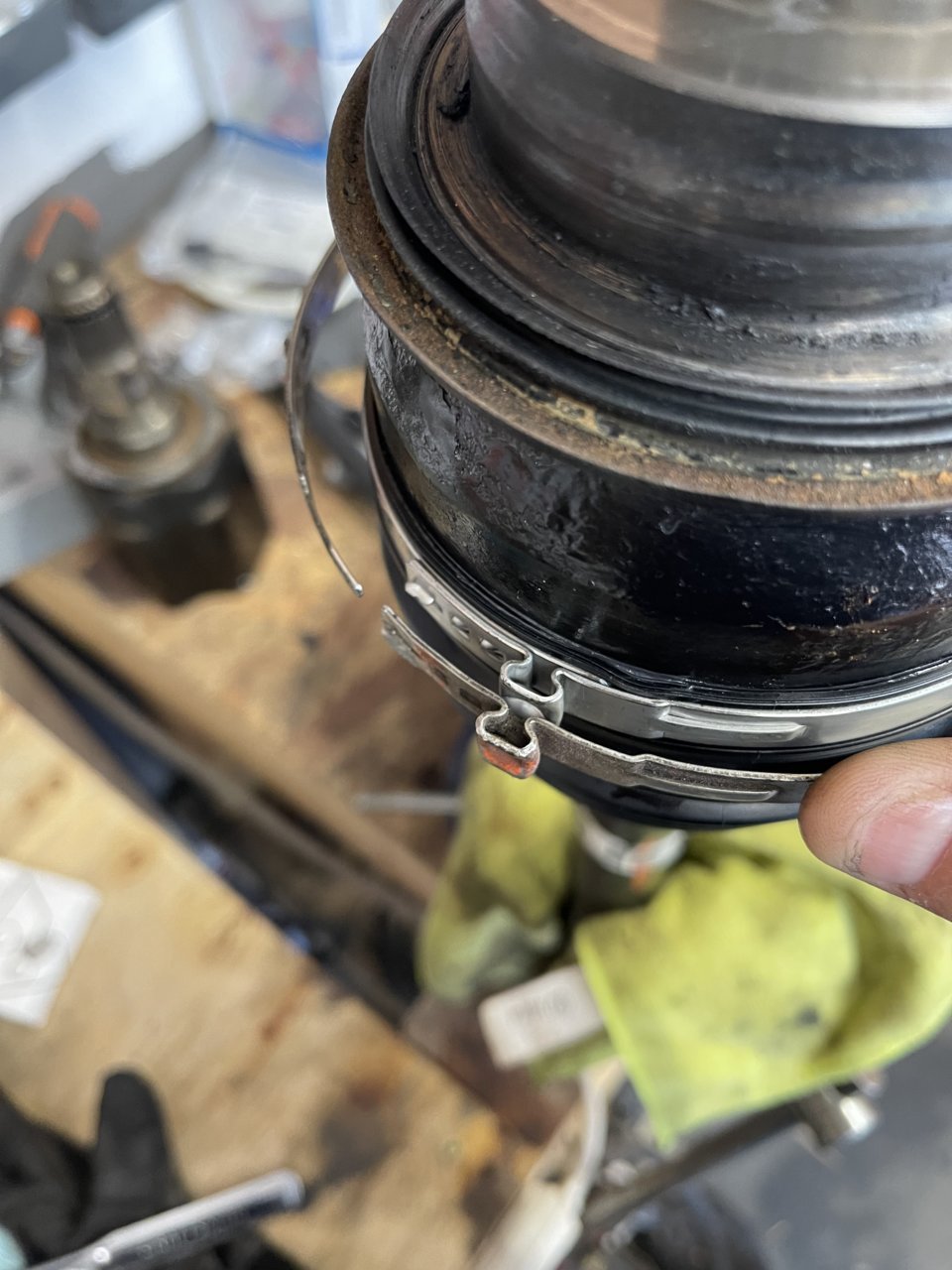

    Time flys. Quit fuckin around and use these:
    (SET OF FOUR CLAMPS) CV Axle Repair Clamps Kit for Leaking Boots after Lift Kit FITS FJ Cruiser, Tacoma, 4Runner, Tundra https://www.amazon.com/dp/B07MRCK38W

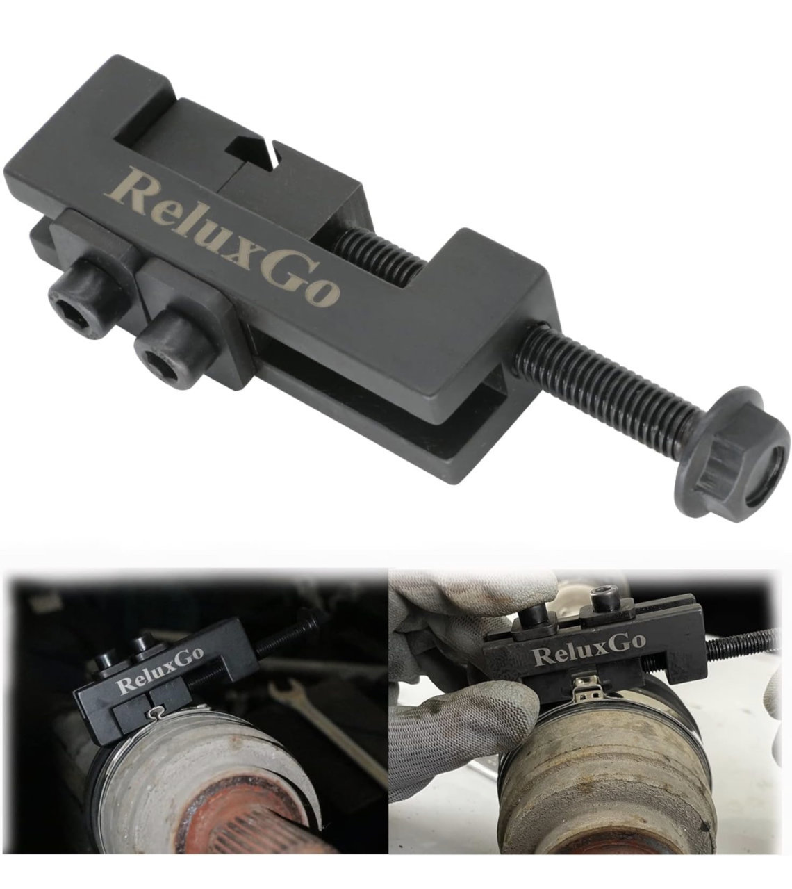

    Supposedly this style of tool is the special tool that Toyota techs use. Obviously without the dumb china name. Hope it works better than the double breaker bar method with the Lisle pliers

    Tried them twice. They suck. Hose clamps work fine

    I fuckin hate buying specialty tools for one job. I used the lisle tools, did it the right way and the shit still failed. :(

    We will see with this tool. Costs as much as the Lisle pliers, and its obviously an Amazon knockoff.. :oops:

    Just waiting on my Amazon tool

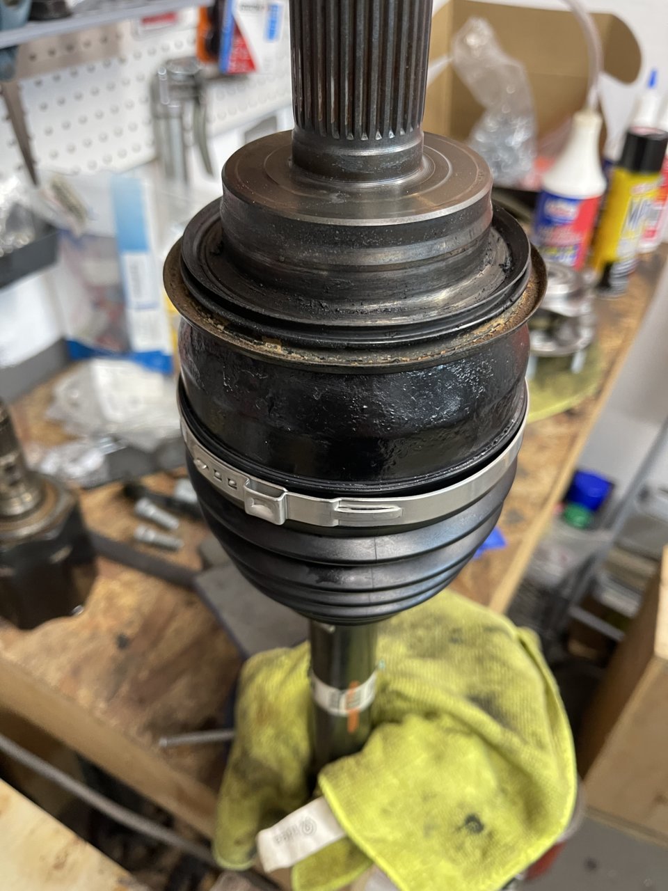

    I wonder if this will be good enough?
    LocoLocal and Gunshot-6A like this.
  18. Sep 1, 2023 at 3:08 PM
    fatfurious2
    fatfurious2 [OP] IG: great_white_taco
    Jun 28, 2014
    #132884
    49,842
    David
    Ashburn, VA
    2010 TRD OR Access Cab

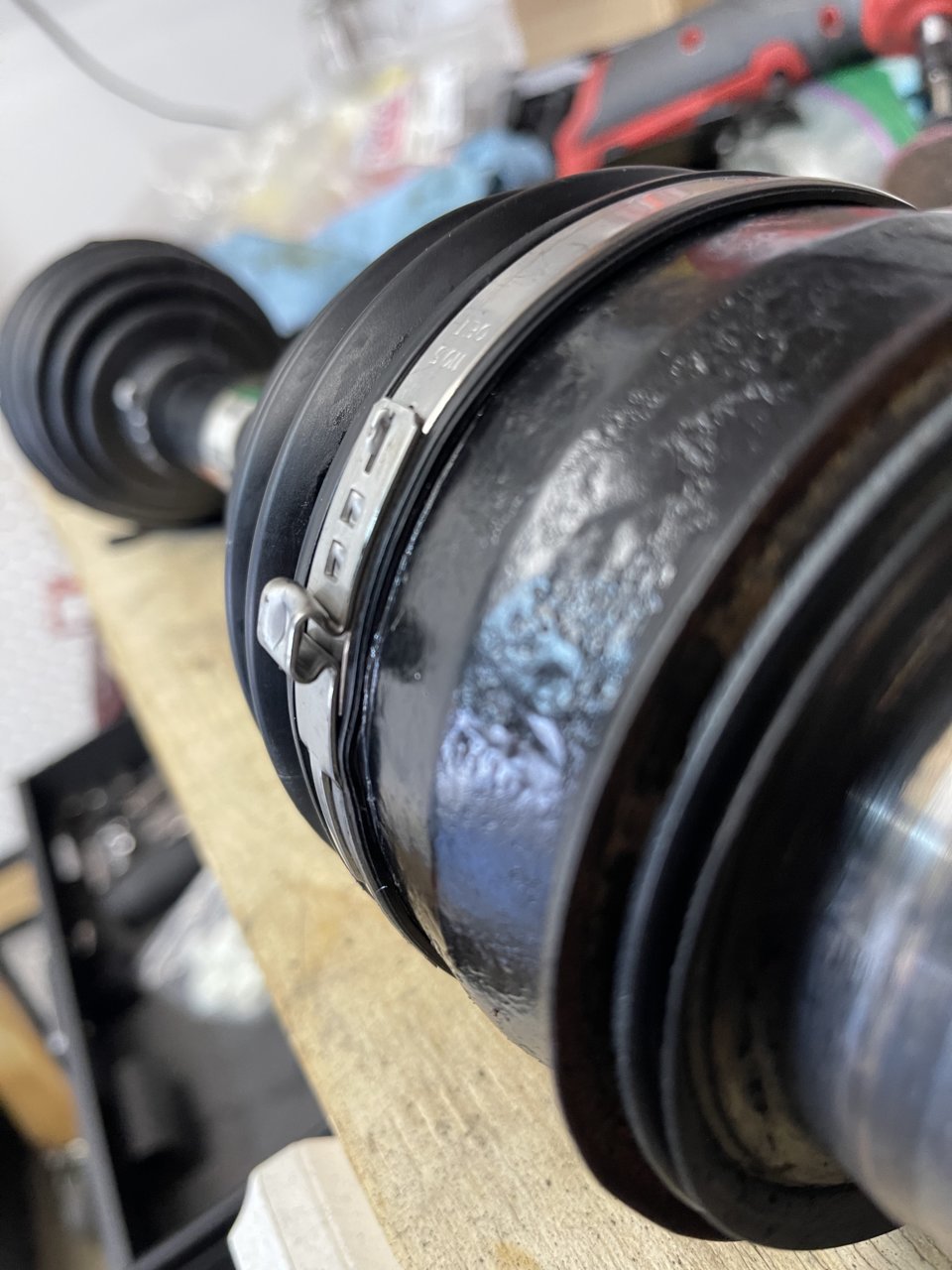

    Still went more. Put some antiseize on the threads of the tool as lubricant.
    Heres a mid shot comparing to the one that was removed

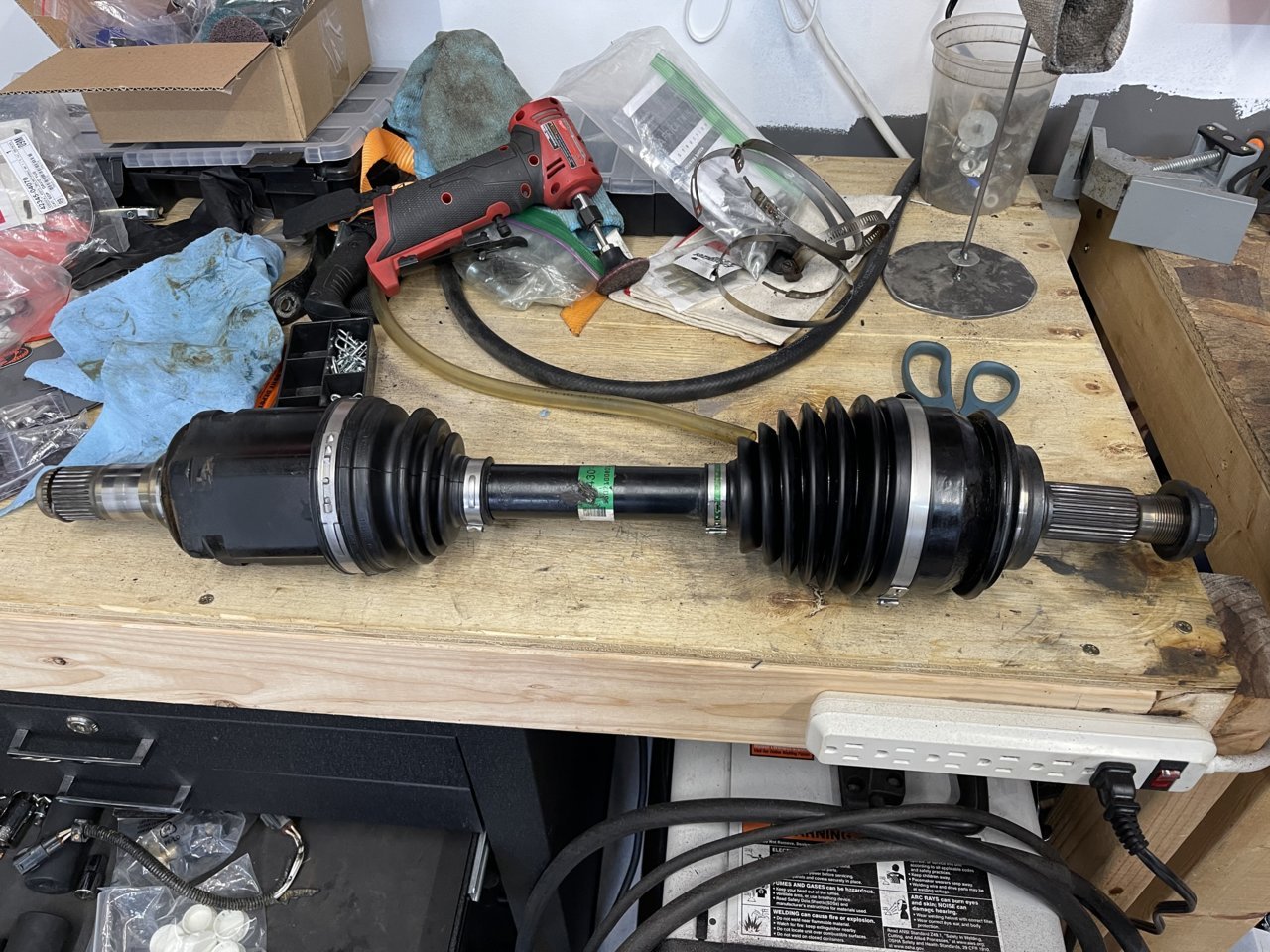

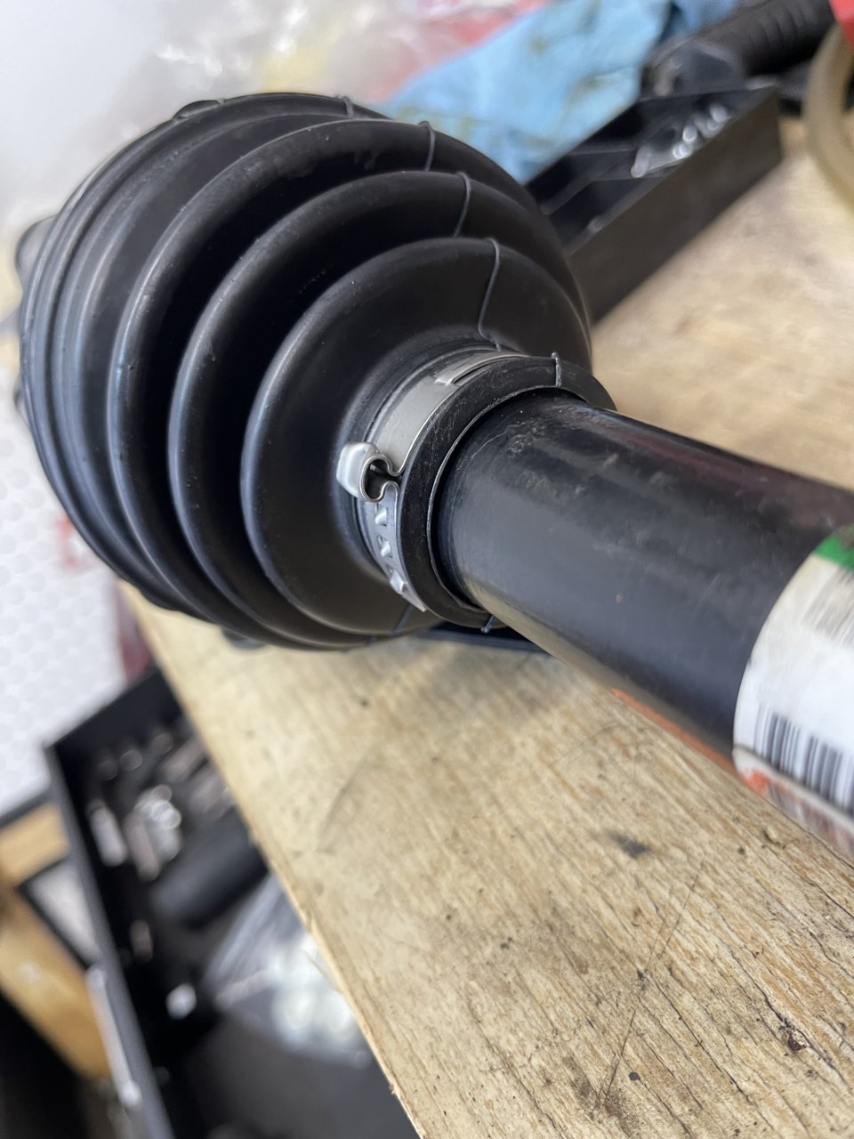

    And thats how you do it! (For the 3 people watching)
    How to reboot an OEM CV Axle:
    1. Get a boot kit that has all the correct clamps
    2. It shouldn't take 2 weeks to do it all
    3. Amazon tool paid itself off with some antiseize lubricant. Multi purpose too with the inboard clamp.
    4. A bolt is stronger than me :anonymous:
