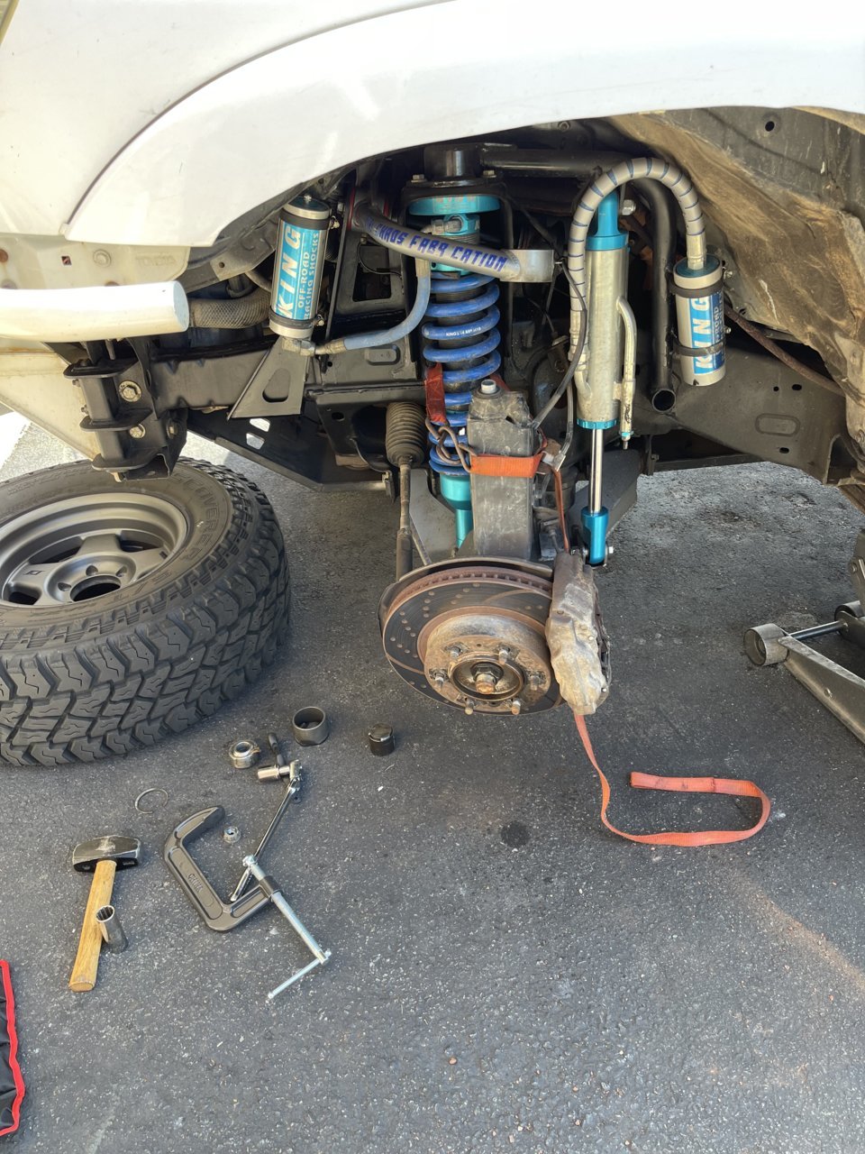

    But first a major wrenching day tomorrow. Hubs/wheel bearings, brakes, a uniball change, and a cv axle swap

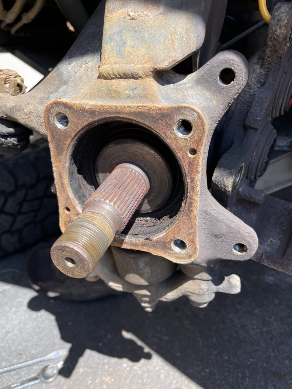

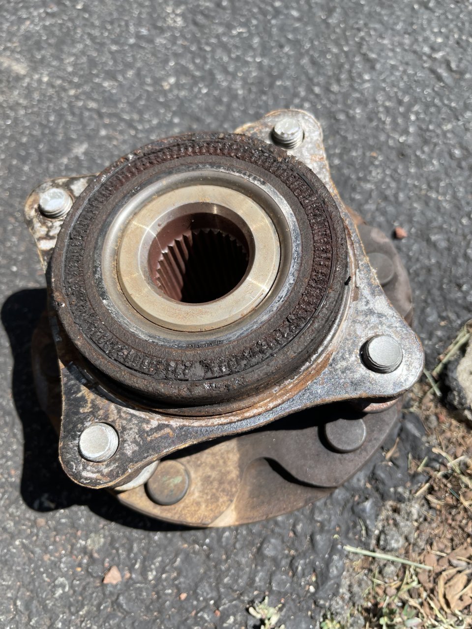

    Finally finished wheel bearings/hubs, pads and rotors, drivers side UCA uniball, and driver side CV swap. Bedded in the pads, and they feel great.

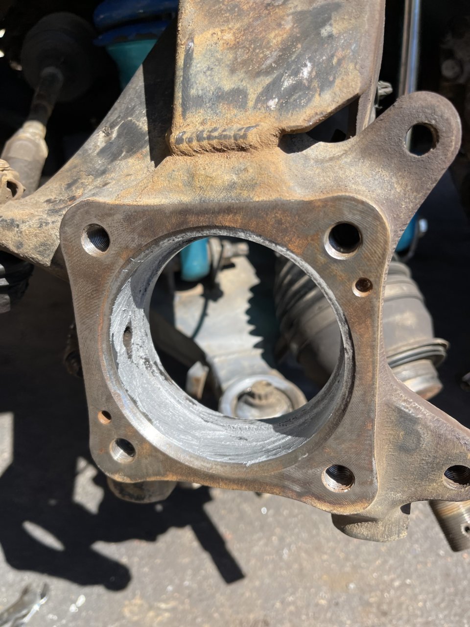

    Maybe my vibration was the wheel bearings... Both sides had considerable rust. The passenger side almost didnt come out. I was beating on it for an hour. I almost was worried that it would separate.
    Brakes were ordered from RockAuto - Dynamic Friction Geospec.
    Put everything back together with excessive antiseize. Hopefully the next time will be easier.
    9/3/2023 127,462
    Still need to go on a highway run to 60+ to see if the vibe is still there

    I don't wish this weekend on anyone. 8 hours for driver side, 3 for passenger. Passenger side I only did brakes and bearing/hub. But still a major pain. My body hurts. Im getting old John!

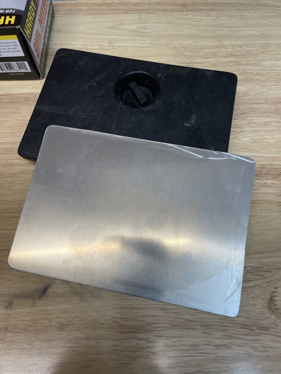

    Replacement cubby door. I had previously replaced it with a piece of ABs plastic. Now that its kinda wearing out, time to replace that with 1/8" 6061 Aluminum

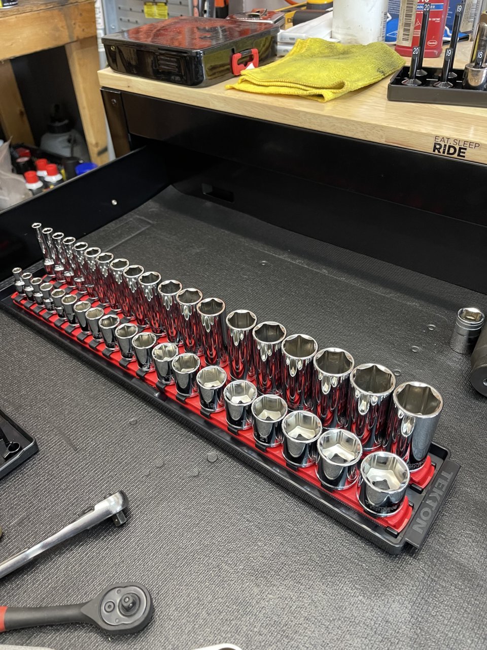

    Starting to get organized

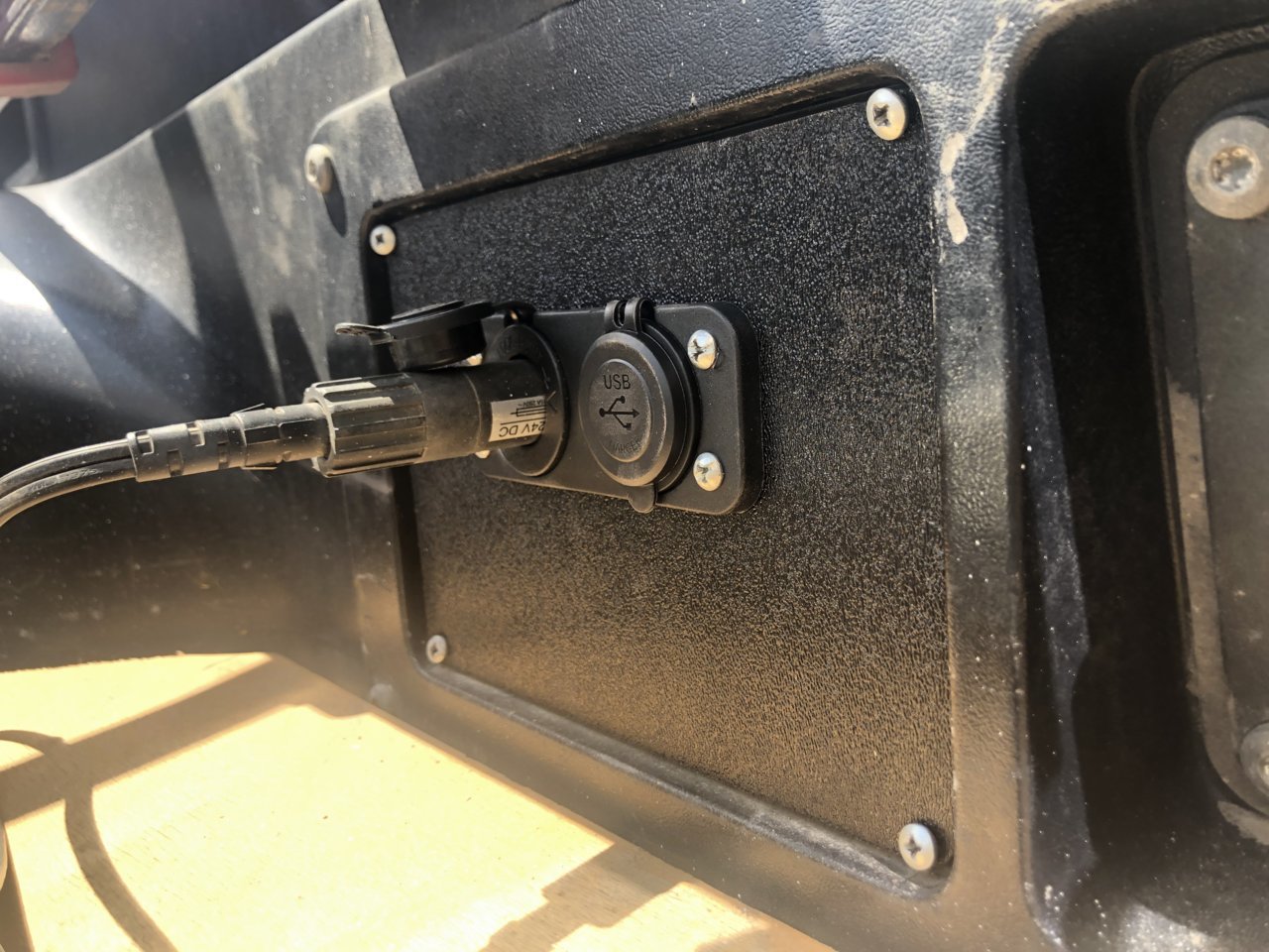

    Ohhhh nice! I dont remember if i ever replaced the cubby door or not. But i remember one cubby held my rear diff breather, and the other one i had put a receptacle for my engine block heater. Since it was manual i didnt bother adding remote start, and i had it set on a timer to turn on about an hour before i left in the morning on the super cold mornings (less than 20F or so).
    I put the receptacle in the bed because i backed into my driveway, and the bed was closer to the garage door. I used some heavy gauge outdoor insulated wire that was then put into ourdoor rated sheathing and sealed at the ends with weather sealing. It worked very well, and on those cold mornings it was nice to crank the truck and it be already slightly warm.

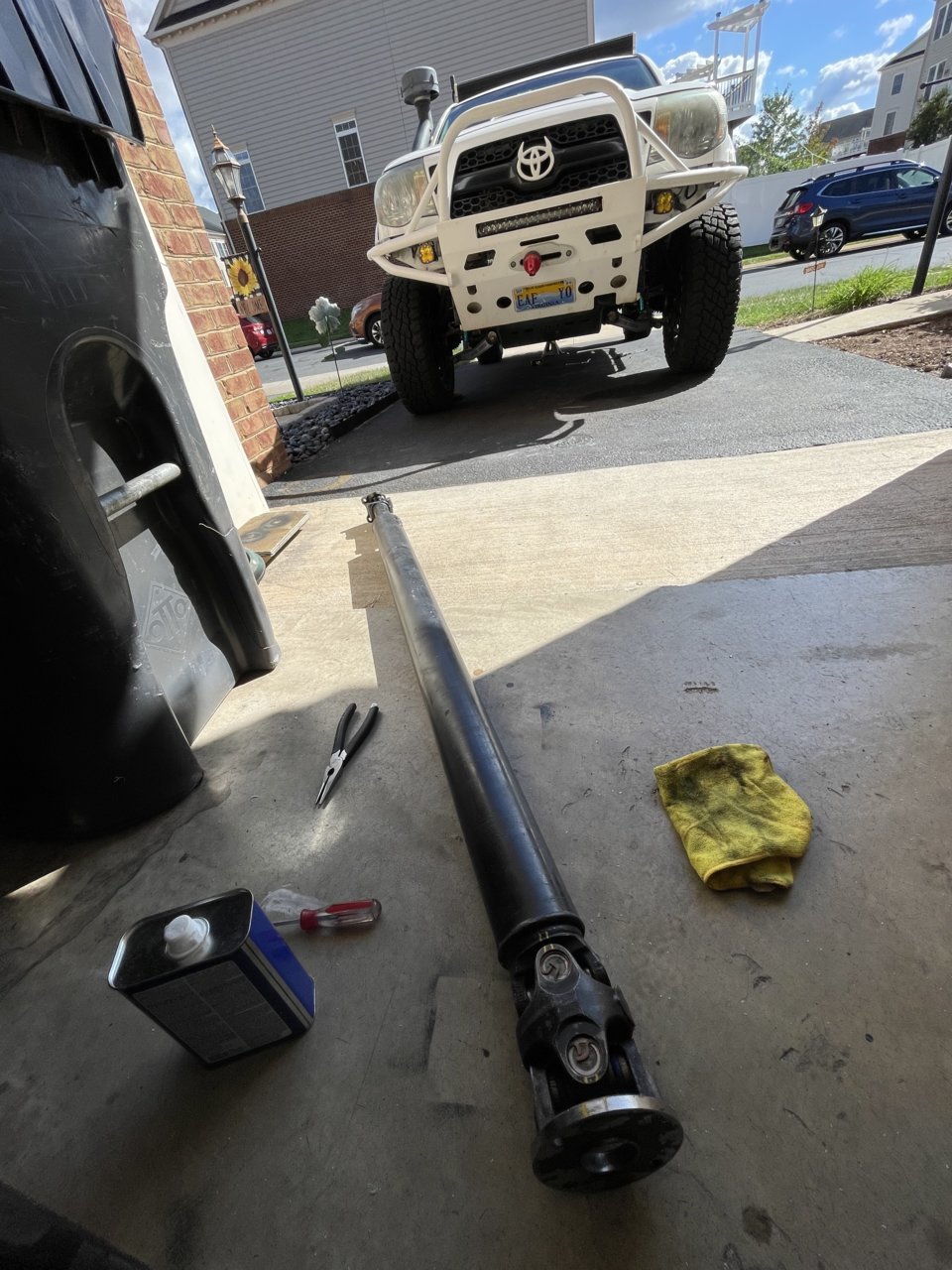

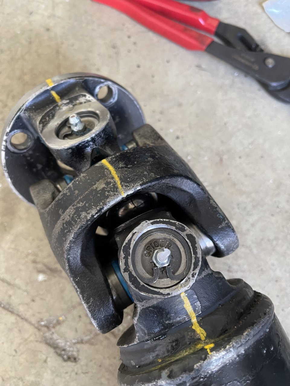

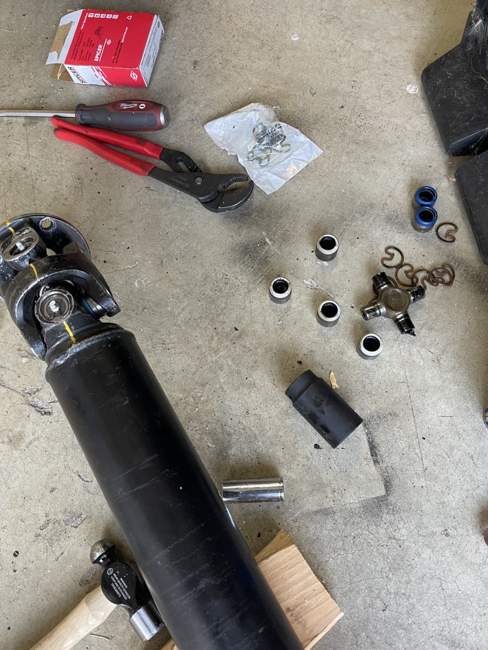

    I have a feeling that I messed this up somehow. All the videos Ive been watching point to something that I did wrong..
    I tapped my double cardan carrier and my butt dyno says some vibes went away - but not all. Anyways, I have some new u-joints to go in, and will be taking care to do things right this time
    https://youtu.be/rOEdul7nscY?t=287
    https://youtu.be/iBFchnrsz-c?si=ffpaNNo1qzg11MlR
    Bastek and Gunshot-6A like this.

    Harbor freight ball joint press and a impact gun make quick work of this btw.

    I used the free tool rental from Advance Auto the last time. Going to try it with a ball peen and socket this time. If I fail, ill go to HF

    pretty sure I did this exact thing last time. It was stiff and I remember it not being able to move freely, before putting it back into the truck
    https://youtu.be/h1T21kmAhWE?t=685
