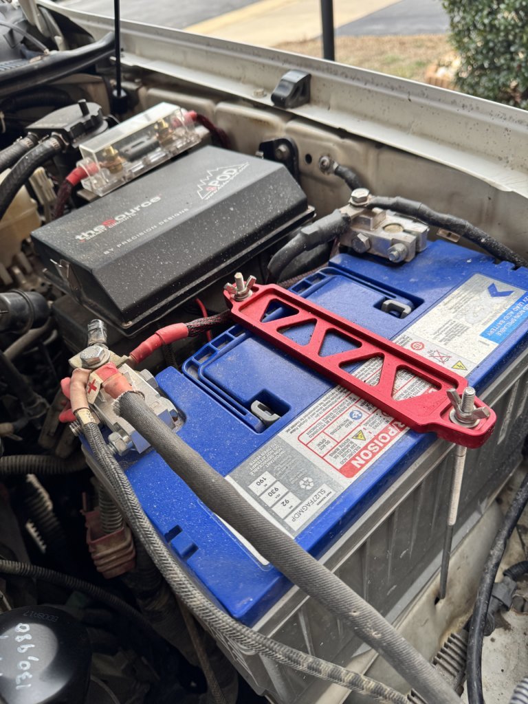

    Battery cables are tight. Haven't checked the ground cables. @Dm93 i remember that I replaced the battery ground bolt with stainless a while ago. Could that cause issues? Its also been a long time with no issues, and then now all of a sudden?
    i havent had time to do more digging yet. But im not good with a multimeter in general
    Edit: truck hasnt burned down at my work parking lot..

    11k miles and a little under 3 years.. Thats not great

    scangauge recently said 17.0v, and then flashed my christmas tree, including the speedo
    @Dm93 what do you think?

    was it an aftermarket alternator?

    yes, aftermarket reman

    go get an oem reman from the dealership
    somewhat common for aftermarket remans to give up the ghost sooner than later
    not saying for sure it is your problem, but it is well within the possibilities IMHO

    I doubt it has anything to do with the ground bolt unless something is corroded.
    One of the Toyota techs on here said modules start shutting down over 16v so it would make sense that your speedometer quit as the ABS module supplies vehicle speed.
    Unless there's an issue on the S-Terminal there would be no reason for it to overcharge unless the regulator in the alternator is bad.

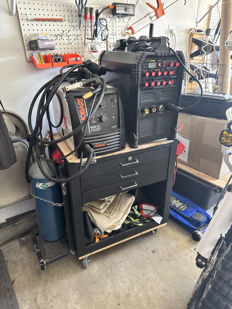

    Unfortunately i havent. Work has been busy, and when I get home dont want to do anything. I also still need to buy a bottle of Argon. I have a couple of choices- buy from Primeweld for about $320 shipped for a 125cf (don't know where I can refill though) or buy an 80cf from a local place for $400 and then the next refill is ~$70. I know I could also try a fusion weld without the gas, to get a feel for things.
    Plus I also need to figure out the tungsten sizes and filler rod sizes. I think since I have some thicker mild steel scraps, I can start with that.
    I also have a medium sheet of 18 gauge stainless, and some smaller pieces of 1/8" 6061 aluminum.
    It barely fits on my little cart, but I have another piece of wood that I can add to make a better footing. Rough start to the new hobby..
