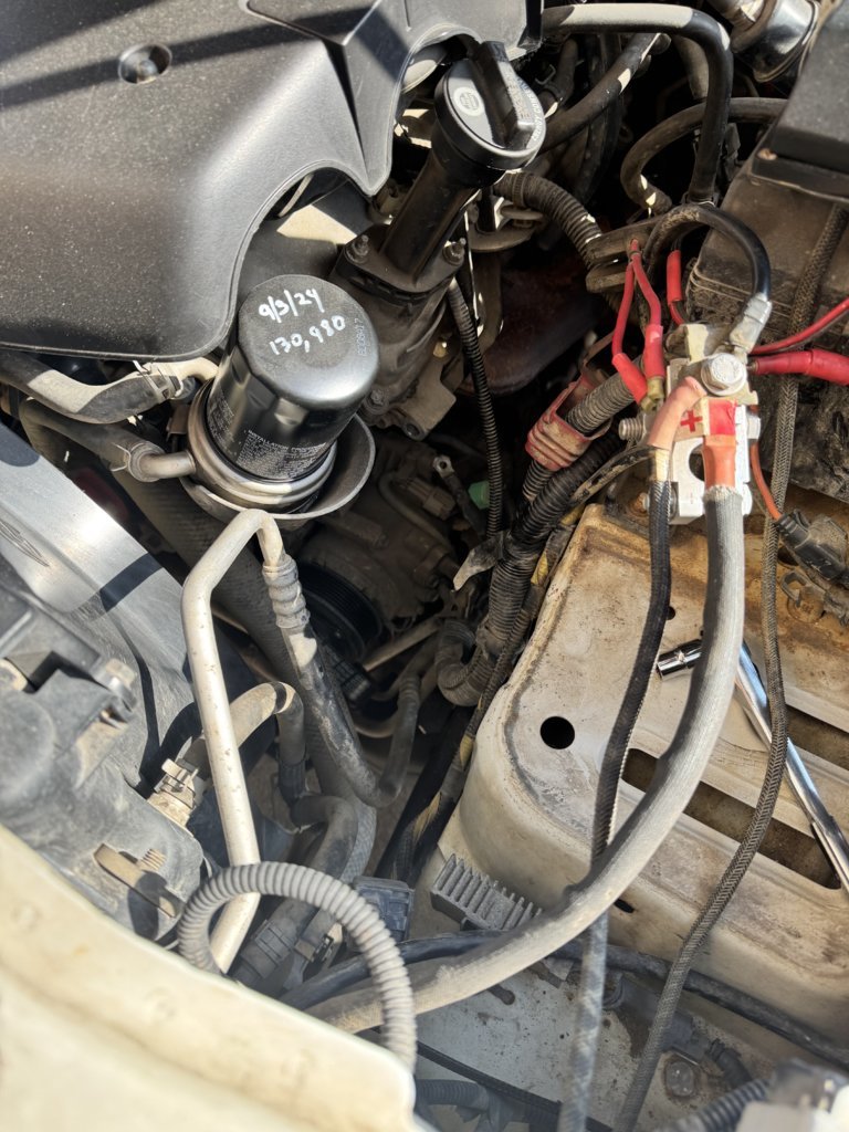

    Ordered a denso 210-1084 reman from Rockauto today. $237 shipped, and if I return the core, it will be $141. Hopefully there will be some warmer weather next week, and daylight savings time change this weekend.
    I was occasionally having all of the lights flash and scangauge jumps over 15v. But im constantly watching the voltage now. The alternator issue isnt every drive/day
    And almost every drive 10-15 min in, Ill get P0157 and/or 137. I have one downstream O2 sensor. I'll probably replace the driver side one, and if i get any more lights ill do passenger.

    Alternator replaced again. First Denso reman was defective.

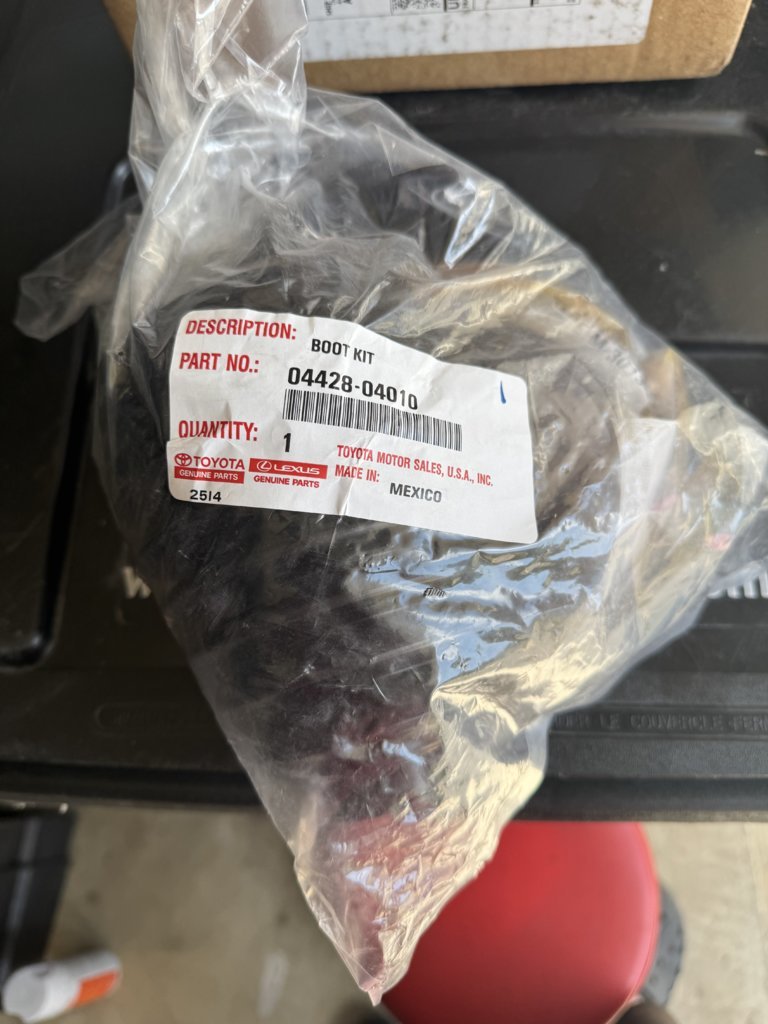

    CV boot kit was on sale on Amazon for $42 shipped. Just need one more and my spares will be complete

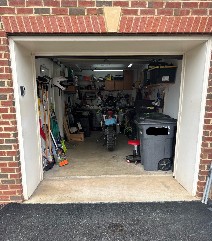

    Building a flatbed is a big task for me. I need to figure out storage and sell bunch of stuff. Might need to defer for a couple years until I can move to not a townhouse with a 20x10 garage too

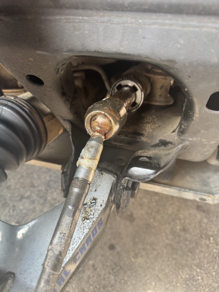

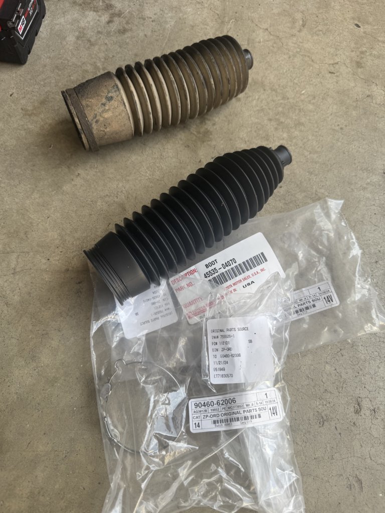

    boot has been leaking for a while. Found a tear at the bottom. Honestly thought it was bigger but needed to get done. Also have some rust on the steering ram part. Going to try to sand it down.
