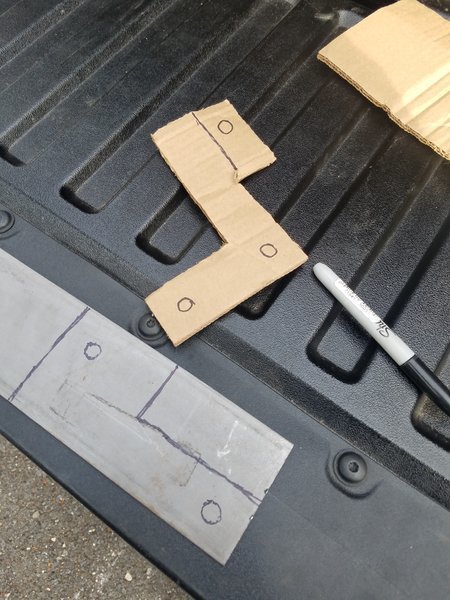

    And I don't have a 2nd gen to use for measurements. When I made Chris's he had bed supports too so i had to work around that

    Essentially I made it to butt up to the bed support and only 1 bolt holds the mount. But since it's butted up it doesn't allow it to bounce or flex

    You could make one out of aluminum and don't need to weld anything. Get a piece of 10 gauge aluminum 6" x 3". On the 3" side cut down the middle till it clears the tail lamp. Then with what is leftover bend that piece to 90 degrees.

    @Shmellmopwho has one with my name on it though. I want to make stuff though

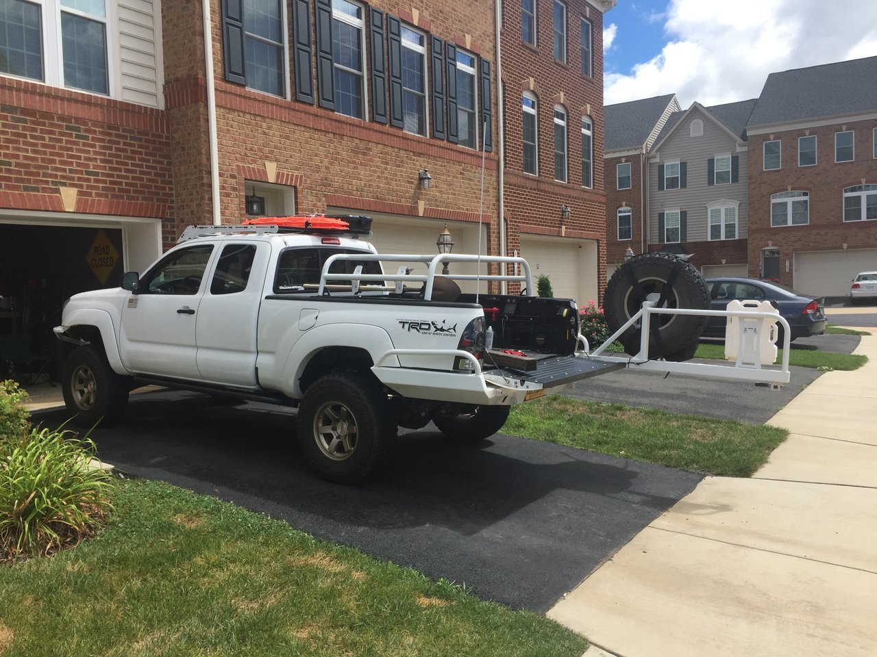

    Heading out to Durham NC tomorrow. Bedcage sold, dropping it off for TW express, and going to check out/buy a cap
    Truck is naked again for a little bit
