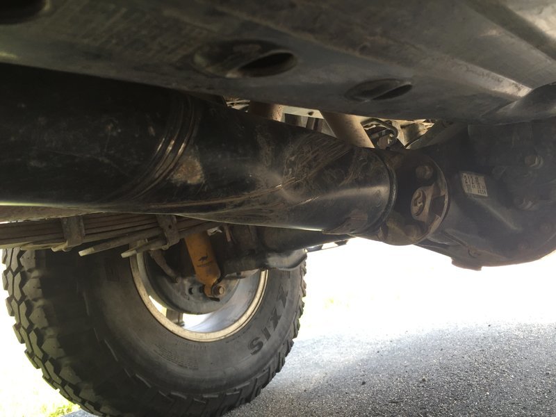

    Find a shop that will retube and balance. No need to buy an entire new driveshaft. Mine ran me $200 with half day turnaround

    I need to find a shop. Then also figure out some way to get it there.. This is not a benefit of being single with 1 vehicle hah..

    This is from Driveshaftspecialist.com :
    Toyota Tacoma 2 and
    4 Wheel Drive
    2 Wheel Drive Tacoma uses 3 different types of driveshafts dependent on year and wheelbase of truck.
    Driveshaft are 100% New and upgraded to 1310 series Spicer XL U-Joint.
    [​IMG]$475 Non CV (NEW) Driveshaft. Includes Shipping. Single U-Joint at each end (non CV at Transfer Case)
    [​IMG]$565 Cardan CV (2 u-joints in cage) at Transfer Case and a single U-Joint at differential end. 100% new and includes shipping.
    [​IMG]$755-$795 Shipping included. 2 piece driveshaft with a carrier bearing in the middle. It also has a Cardan CV just behind carrier bearing. There is a single U-Joint at differential end and single U-Joint at transmission end. Both have flat 4-Bolt flanges at each end. 100% new driveshaft with 1310 series upgraded U-Joints.

    If you're 4x4 you can pull the rear driveshaft and drive with just the front engaged. Just make sure to engage it all before pulling out the rear shaft

    I am 4x4, but wont driving with it engaged damage anything? @cynicalrider just broke some stuff and had to limp home. But he has a 1st gen

    Nope. I drove mine around all day that way. And I know a few others have driven a pretty far with just the fronts

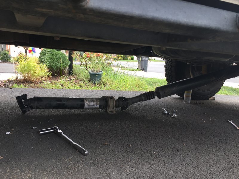

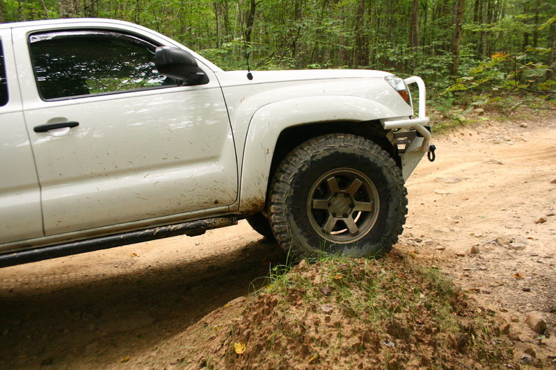

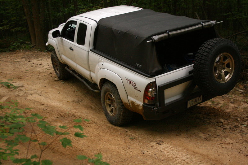

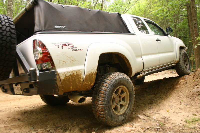

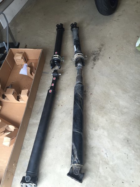

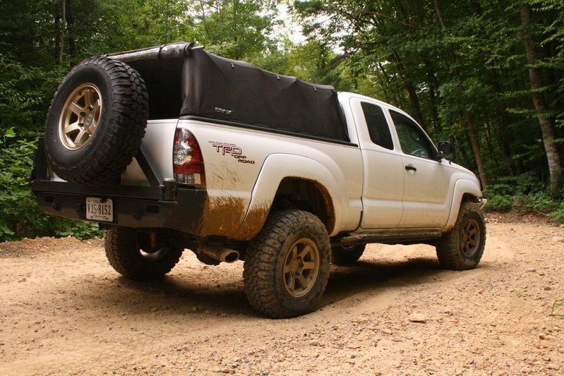

    A little bit of an update. Got my OE driveshaft in yesterday. Took about 1.5 hours with some breaks and I needed to keep running back to get different tools and stretch my back.
    Current mileage 47,300
    Went back to Peter's Mill Run with @Lots2Learn58 and @CanisLupus , but they were on dirt bikes. They are peer pressuring me into getting one. Just need to decide on the size and model. I had some time to mess around by myself and with my camera, since I was the slow one. Have my recently mounted Softopper, and its doing its duty.. dry storage/camping area.
    Well here are some pics
    Bro lean from suspension, not the bike :D
