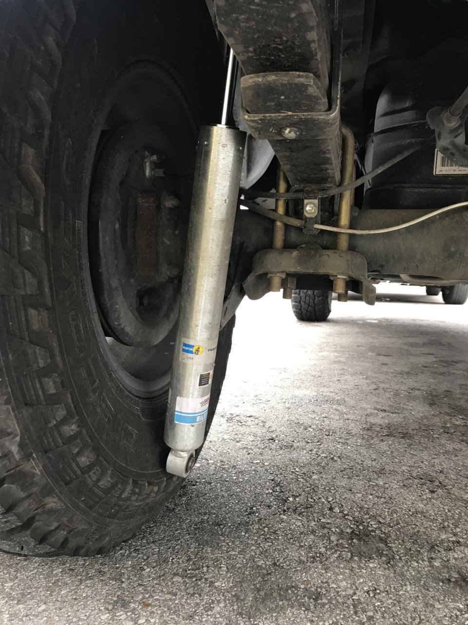

    Bilstein 5100 all around with 2885 coils up front. OME full pack replacement rear. 1.25” spidertraxx spacers. 255/85/16 Cooper ST Maxx. softoppper.

    How’d you do that?

    If the shaft ain’t bent then just compress the shock and throw a bolt in it.

    yeah we’re good. the mount isn’t broken. looks like the bolt just rattled out.

    Red loctite and a torque wrench then and you’re set.

    Put the bolt in and a few clacka clackas from an impact will do.

    It's the new Auto Shock Disconnect System (ASDS)

    see you upgraded to the new bluetooth rear shock bolts
