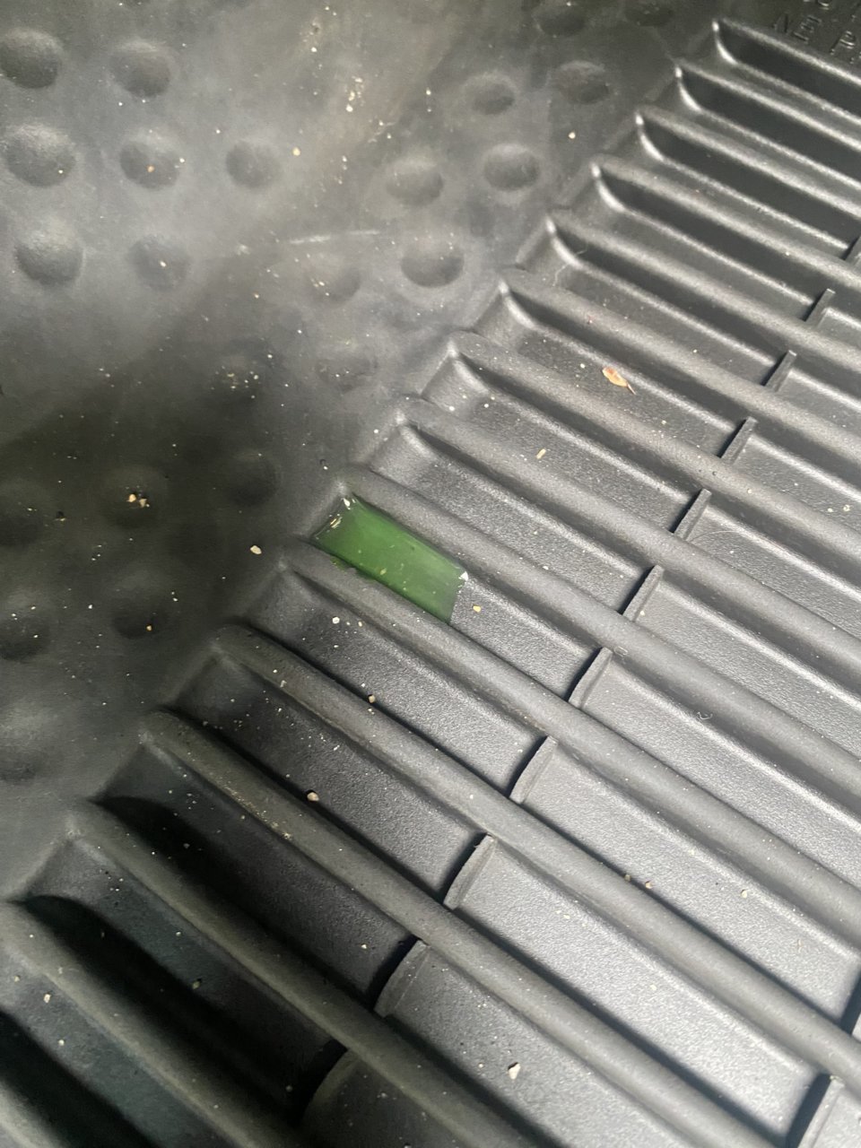

    Any idea what this green goo could be leaking onto drivers side floor mat 2017 off road Toyota Tacoma?

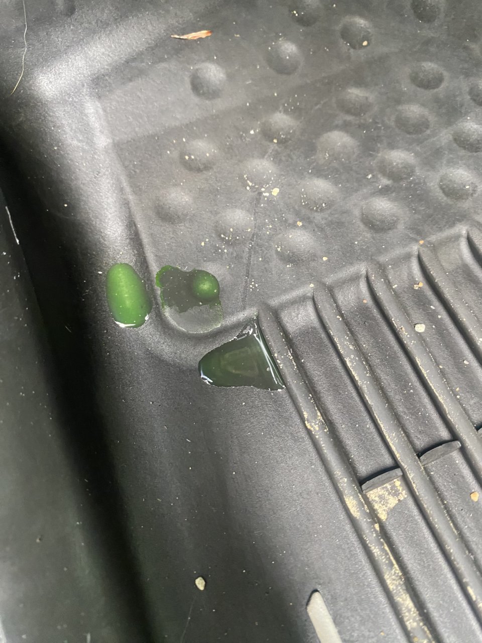

    Not sure on the smell had some repairs done after a little fender bender truck was detailed picked up yesterday in pouring rain went out this morning and saw the alien venom…. Went back to auto body shop thinking it was a coolant it was wiped up without getting a whiff

    It's A/C refrigerant. The coolant is pink. It should have a bitter smell unless it's a very slow leak.

    Do you me AC refrigerant oil? Because AC refrigerant at room temperature is a gas, not a liquid.

    Looks like refrigerant oil. Does the A/C work?

    Refrigerant oil is green like alien blood
    Toyota coolant is pink/dark red. Always has been..

    Thanks. Learned something new about the oil. And yes get this fixed ASAP. If you have lost refrigerant/oil the AC system could be open to the air and you dont want to run the compressor since it wont have any lubricant.

    Its green not red so not heater core. AC evaporator.
