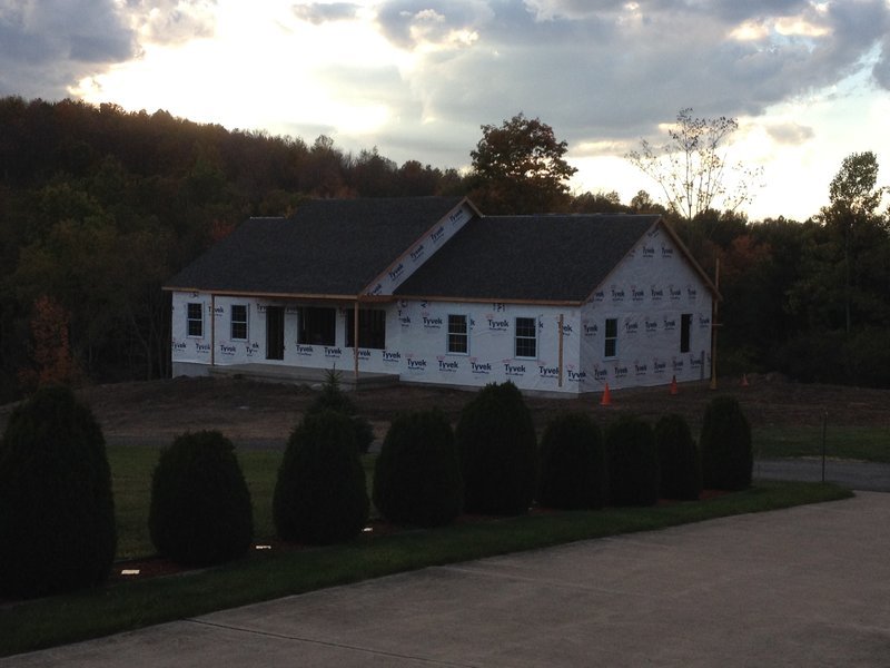

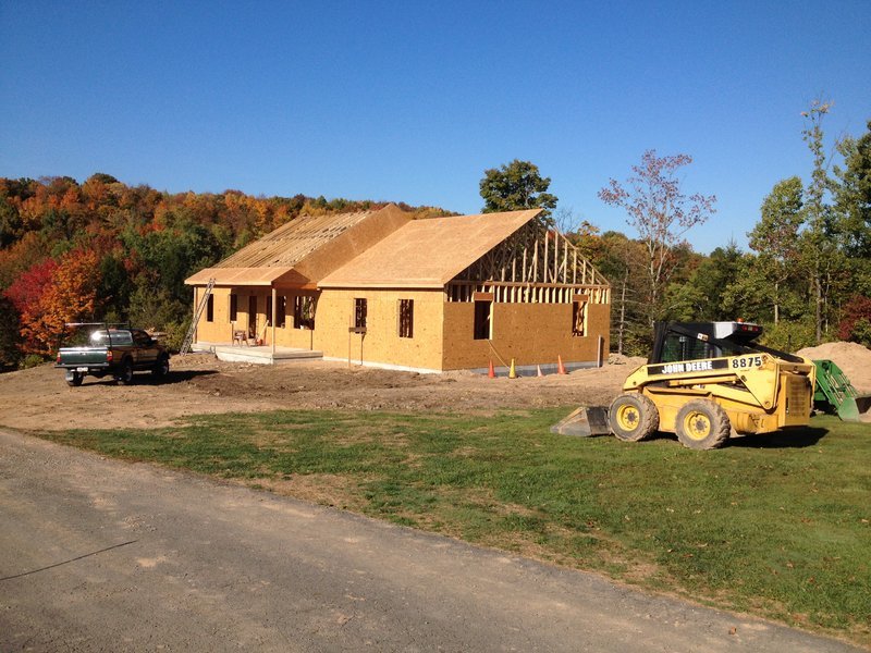

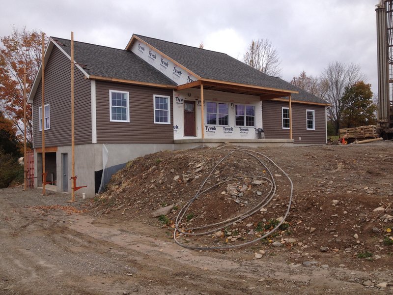

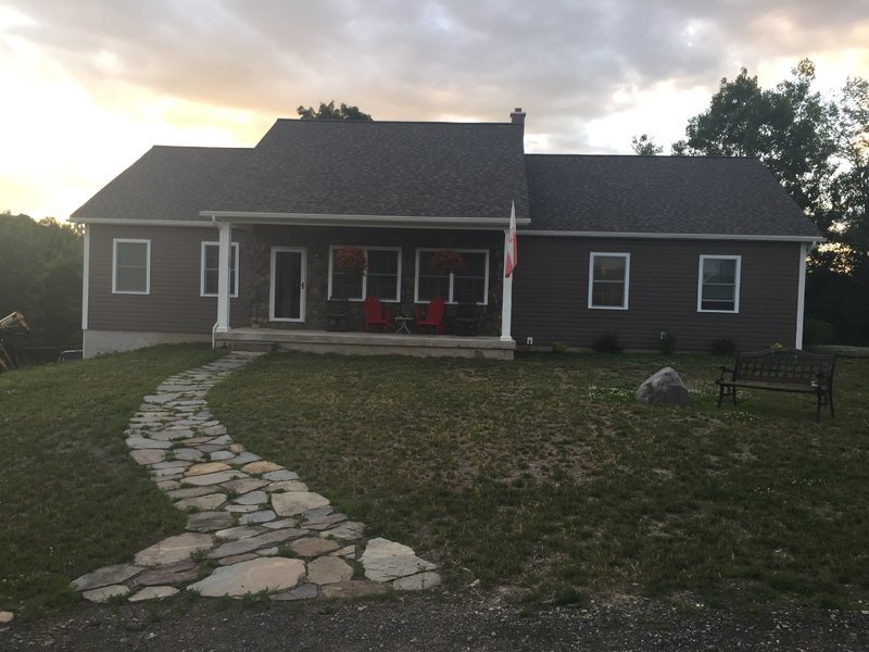

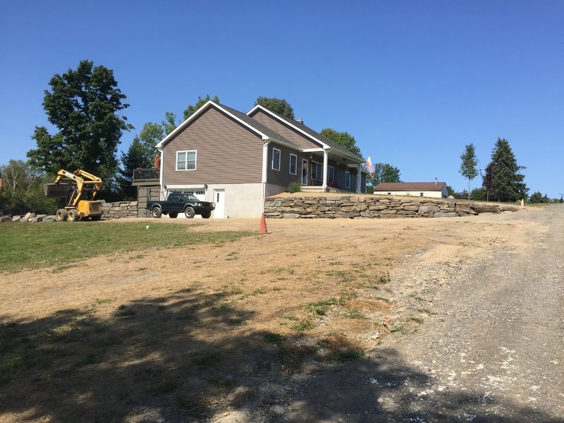

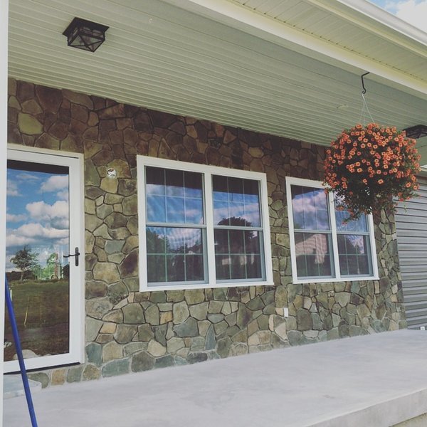

    IMG_0589.jpg IMG_0590.jpg IMG_0618.jpg Pics of closer to today

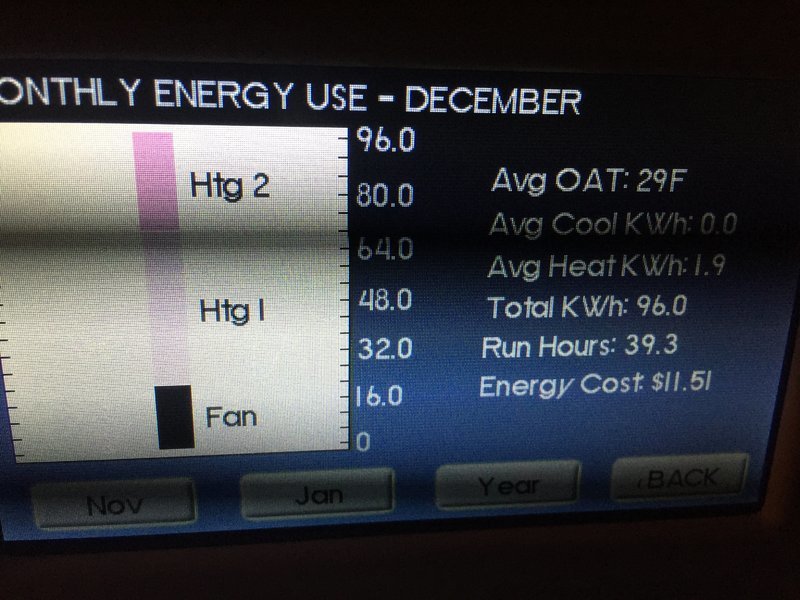

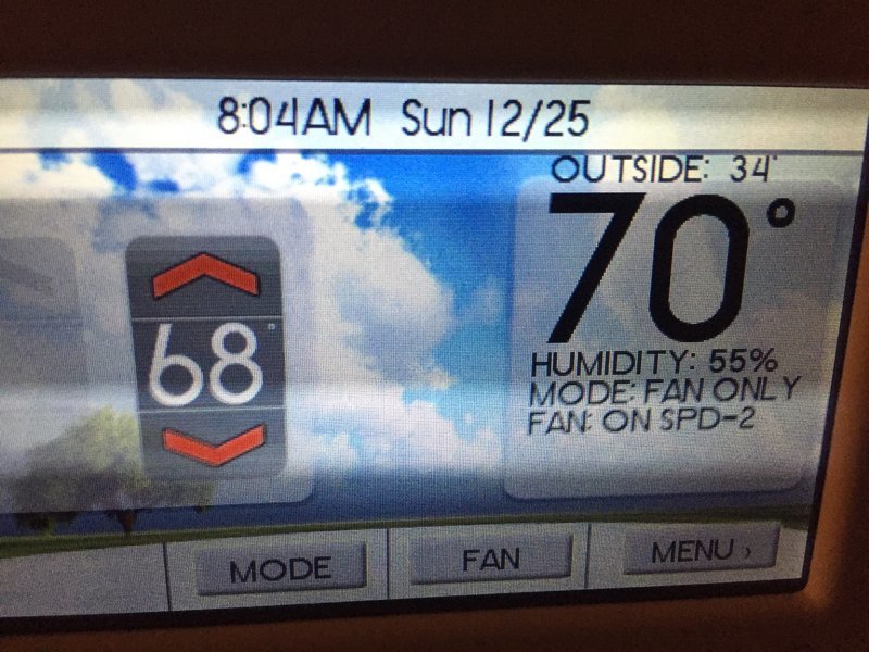

    IMG_0662.jpg IMG_0663.jpg If you think going green is stupid....check out my cost to heat the house(2000sq ft)

    By the way ....yes it cost me 11.51 to heat my whole house for the month of December.

    Damn, great looking house, great looking property, you've got a solid homestead. Love the under garage design. No solar or is it too dark in PA?

    Vertical loops or field ?

    2 300foot verticals

    I have a three ton geo unit...I had my water well thrown in for almost nothing while they were here drilling the geo loops:)
