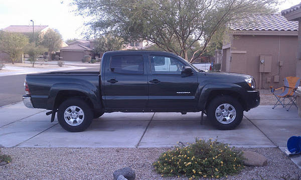

    before:

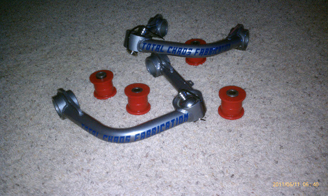

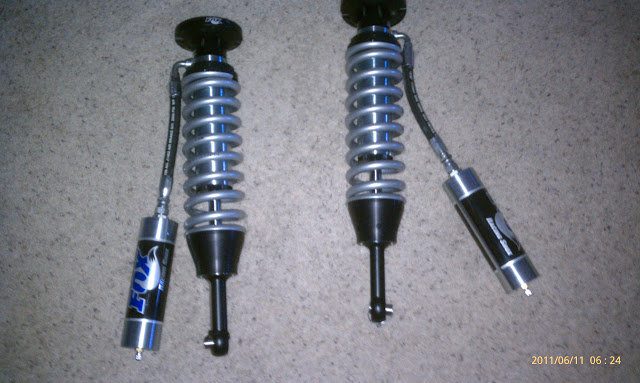

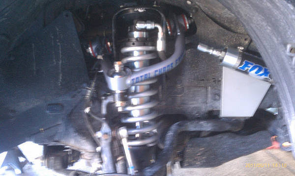

    Fox 2.5 external res C/O with Total Choas UCAs:
    after:

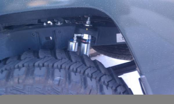

    rear = fox external res adjustable shocks:

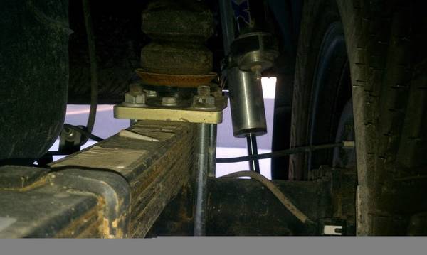

    Timbren Bumpstops with U-Bolt Flip Kit & all pro leaf pack:

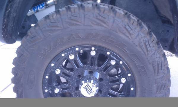

    KMC XD HOSS (Black) w/ Goodyear Wrangler MTR Kevlar:

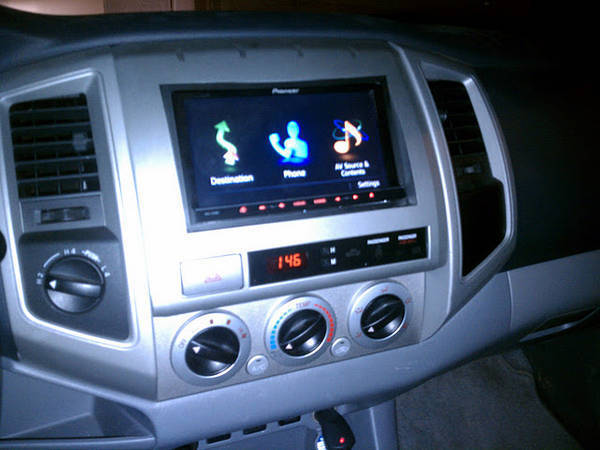

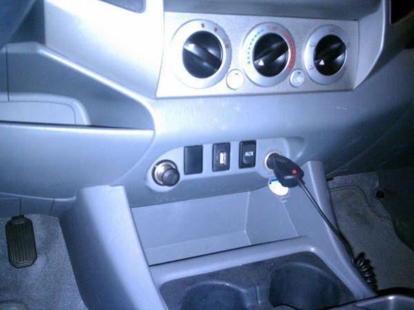

    Pioneer AVIC Z130BT:

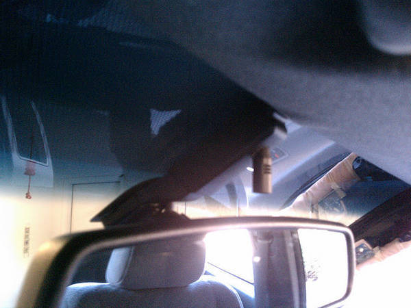

    I mounted the BT mic in the mirror trim:
    And used the middle blank bottom of console for USB port:

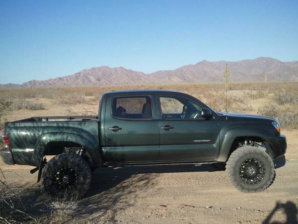

    how she sits today:
    I did have to trim some plastic around the front of the tires do to some rubbing while in reverse and turning...That plastic will all be gone with the new bumper anyway ;)

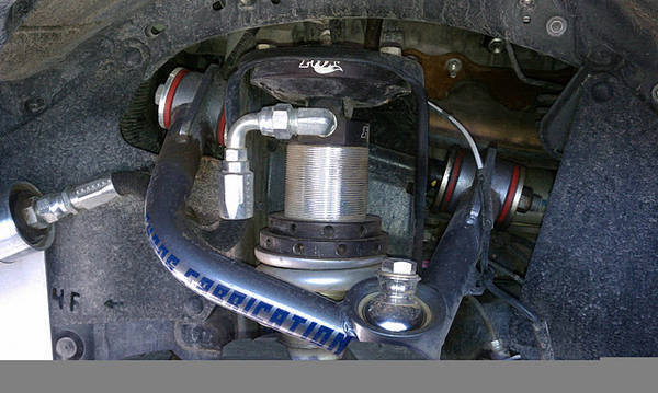

    I took another picture to show how far they are cranked, I could tell from looking at yours that mine are a bit further down.
  10. Oct 9, 2011 at 2:10 AM
    brian
    brian Another Traitor
    Apr 15, 2009
    #16011
    7,555
    Elizabeth City, NC
    2008 F-350 Powerstroke
    Holy crap dude, you've got half again the threads that I do on mine! Did you measure your height before lift? Check out your CV angles man, and from the pic you just posted, it looks like your misalignment spacer on your UCA's are almost already hitting max! You have damn almost no downtravel left! Oh and the pic up top, compared to the one you just posted of your coilovers are totally different in the amount of turns.

    Ok, so from locking ring to top thread I have 2.25 inches of thread on the COs...also from the ground to the fender (centered on the wheel) is 40.25" on the front and 40" on the rear.

    Measure from the center of your hub to the bottom of the fender, straight up. I get 23.5" on the drivers side, which is my low side. I believe 20.5 was stock height. Measuring from ground incorporates the tires, which doesn't not accurately reflect lift. Also, 2.25" on thread on the coilover is not your lift amount either. The amount of thread you crank down effectively doubles your lift. So for every inch of lift, you're going to crank a half inch on the coilovers.
