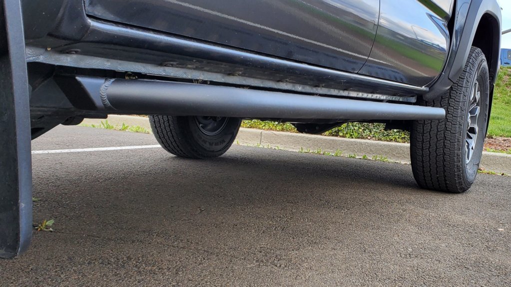

    You got a side picture showing how far down they mount from the body?

    This might help. I have the non kick-out version.

    Too damn nice! I was hoping they mounted close.
    Thanks in great multitudes!

    I mean, they're just about as tucked up to the body as you can get. They have 12.5 degree angled up option as well.
    You're welcome!

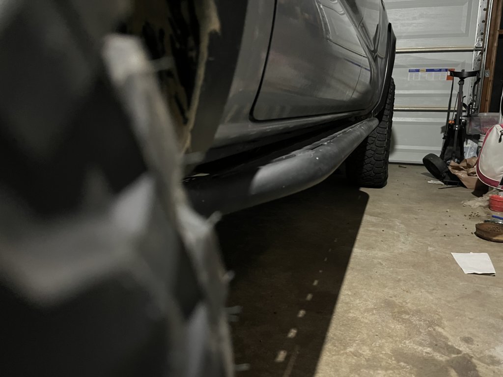

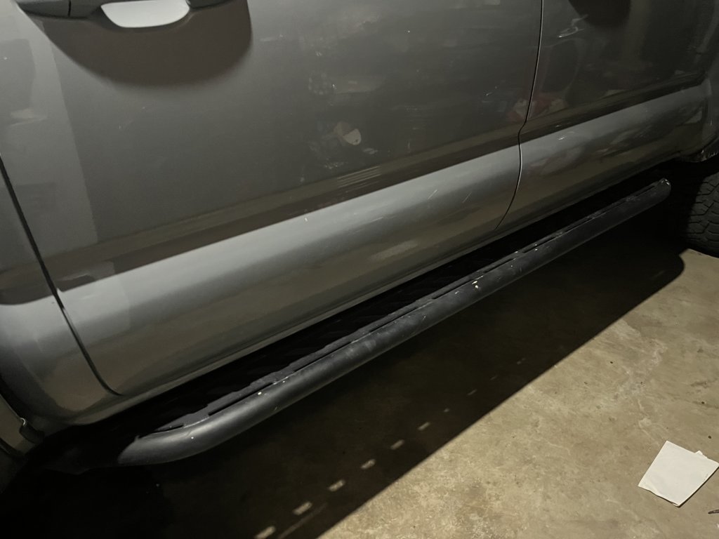

    Angled no kicker
