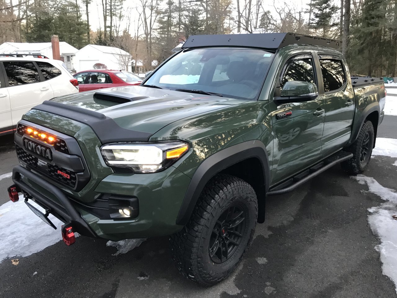

  20. Mar 15, 2021 at 3:49 PM
    #20
    GreenTaco2020
    GreenTaco2020 [OP] Member
    Sep 1, 2020
    #339416
    16
    2020 AG Tacoma TRD PRO
    This is how it looks right now. I have not tested the bumper / sliders with rocks yet but everything seems very solid. It will not be as strong as steel, tho. No winch yet--will do that probably next year. Front bumper install was pretty straightforward but not the cutting part. That part took a while and adding the trim edging made it look like the truck came that way from the lot.
