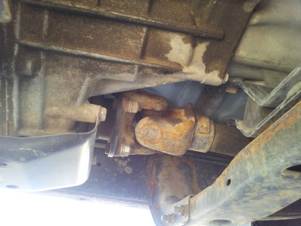

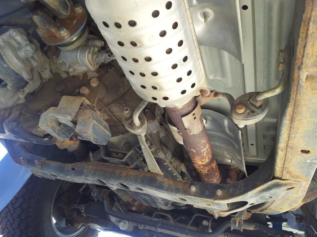

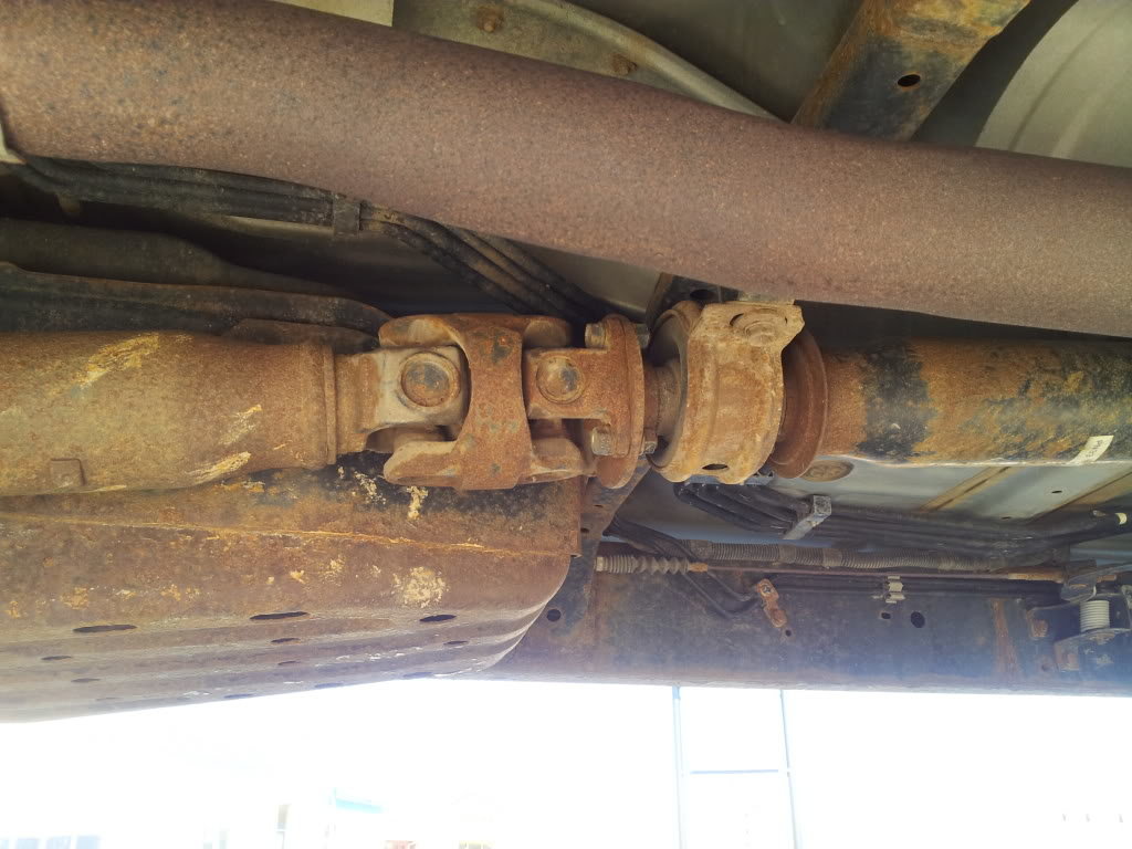

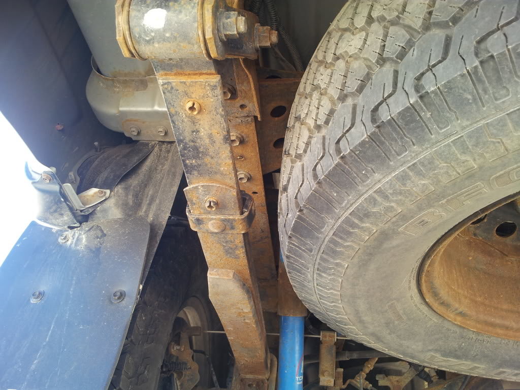

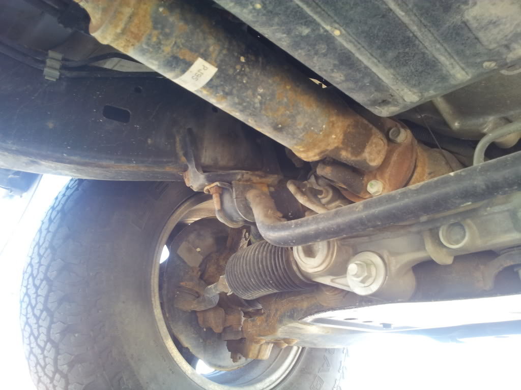

    I don't know a lot about cars/trucks, but I'm not a complete idiot, kind of :) But there's this 2002 Tacoma, 180,000+ miles for 12k, and I looked under and saw a lot of rust, not sure if it's just rust spots, or the bad frame rust. The previous owner (not even sure if there's multiple owners) is local, Sioux City Iowa, so I know the salt during winter is not gonna help. But do you guys think this is the bad frame rust that I should stay away from?
    Anything else you guys see that I should steer away from this Taco? I almost forgot, I plan on using this as my daily driver, but to also use it to camp, the occasional wheeling (like a few times a year) and to eventually go on longer trips with it (borderline overlanding, but wouldn't call it overlanding), throw my bicycle in the back, haul my dogs around, etc. We have a 2010 4Runner now, but whenever I have to do something dirty, it's a hassle, hence the need/desire for a truck. I have plans for front and rear bumpers, a winch, mild lift with OME, AT tires (leaning towards Duratracs), body armor, and possibly a supercharger :)

    She's lookin pretty rust but may still be solid. Get the VIN and have your local dealer look it up to see if it has ever been taken in for a frame inspection, kinda doubt it though since it doesn't look like it's ever been sprayed with the undercoating. See if they'll let you smack around on the frame to see if it sounds solid or not.
    What's the overall condition of the rest of the truck? Is it a double cab or TRD? Give the buyer's guide a good read through and it'll set you on the right track.

    So, the rust seems to be spread all over under the truck but, from the pictures, I don't see any scales or bubbles. If I were you, I'd check for any signs that the rust is deeper than the surface. If it is, walk away. If not, and you're willing to take the time, you can coat the rust in a paint made exactly for such an application.
    EDIT: Also take a good look at the suspension. It looks a little tired from the angle of the UCA in one of your pics. If your lifting it, no big deal.

    On a couple of the pics, I do see some scaling, so that's kind of concerning to me. I am willing to take the time to coat the rust like you mentioned. But of course, not if it's too late with the rust cancer. The suspension I will be lifting it, probably one of the first things I'll do, they already have decent tires on, even if they're 265s.
