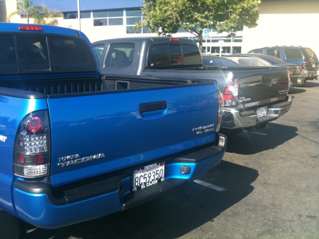

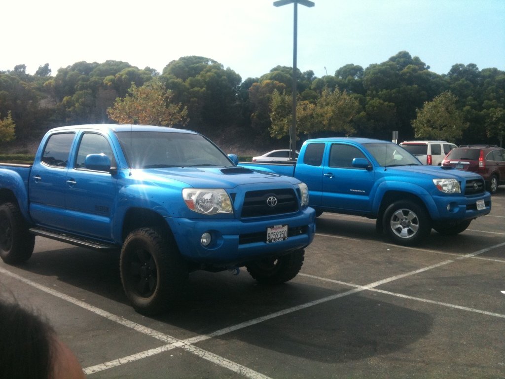

    EDIT 8-28-2011: A SWB Sport parked next to me at Fry's. Took a pic for a good comparison:

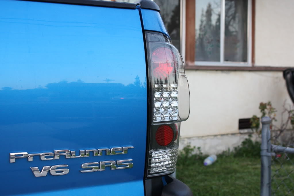

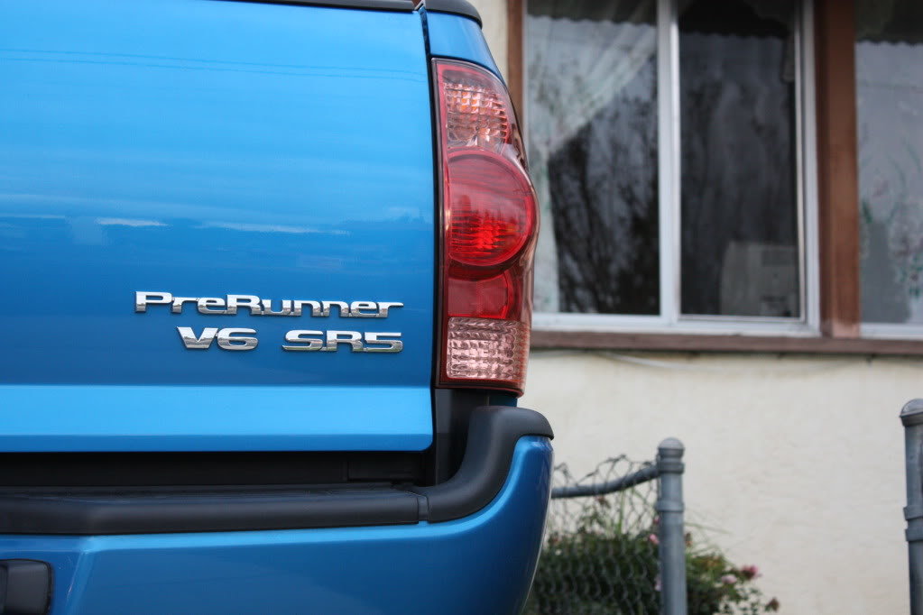

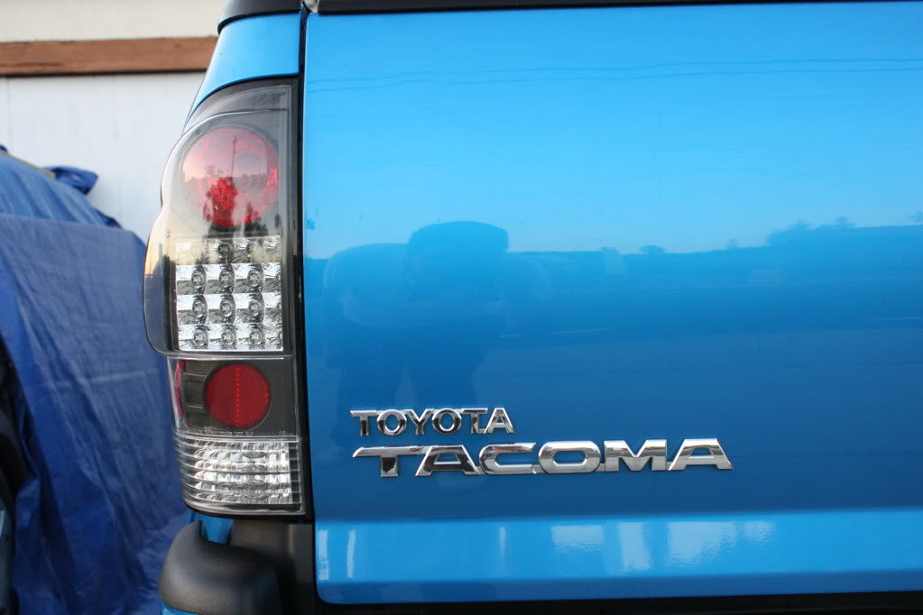

    I had just gotten my Tacoma and five days later a goofball taps my driver-side tail light. It was brand new and there was no way I was gonna enjoy my new truck with a crack in my tail light so I bought LEDs.
    Original tail lights:
    New tail lights:
    I think they look awesome and couldn't be happier. This was my first time changing something out on my truck so I was scared, but god damn- I had to pull hard to get those tail lights off. Very simple process after done once like most things on these trucks.

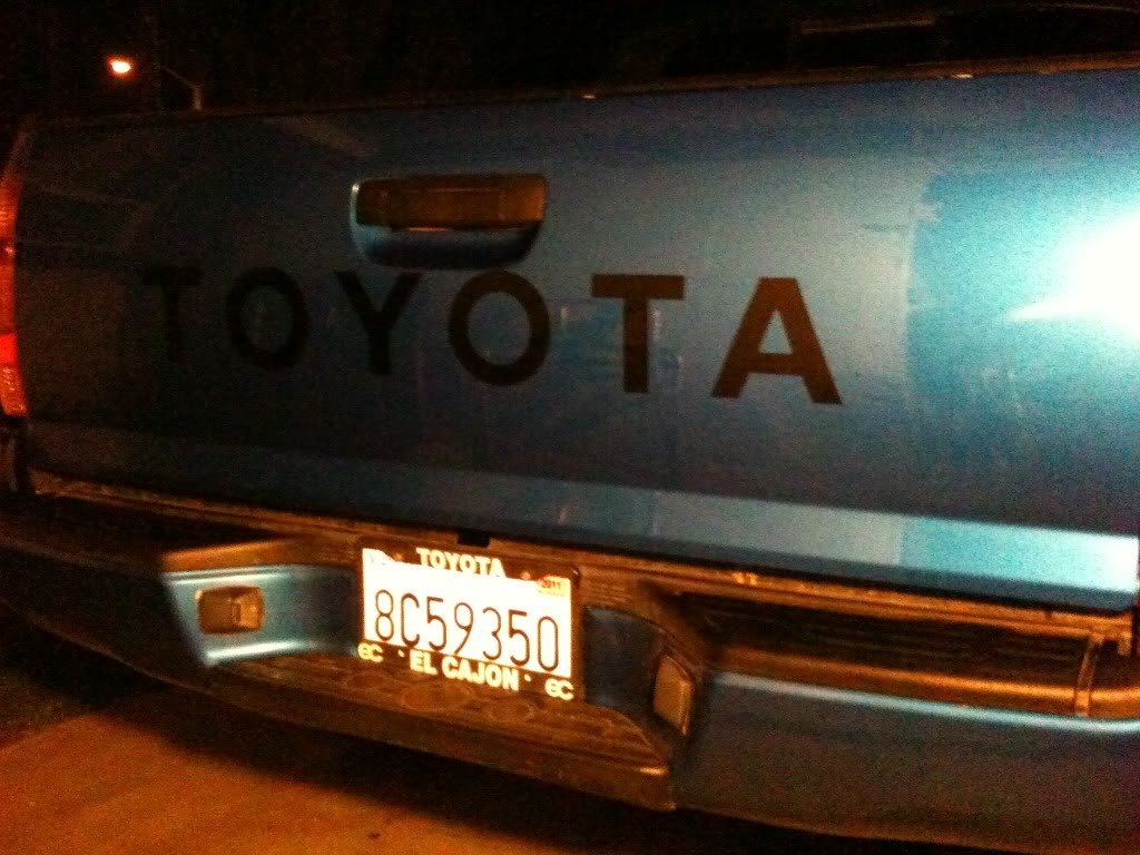

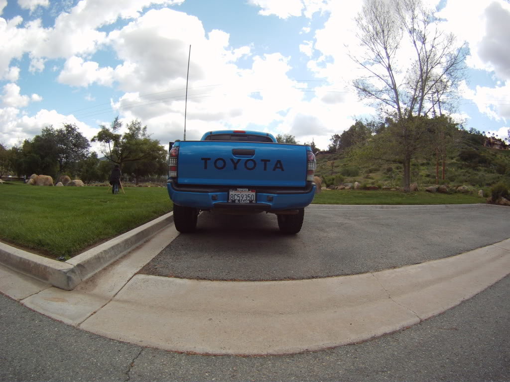

    Next I got TOYOTA thrown on the back. I love the classic Toyota look on the tail gate... Not to mention I just love my Toyota so I just wanna show it off that way. I first saw this on Special K's truck and thought it looked bad ass. Props to Eddie.
    Without
    And With
    Thanks to Mike at FineLine Grafix in Santee for the Sticker.

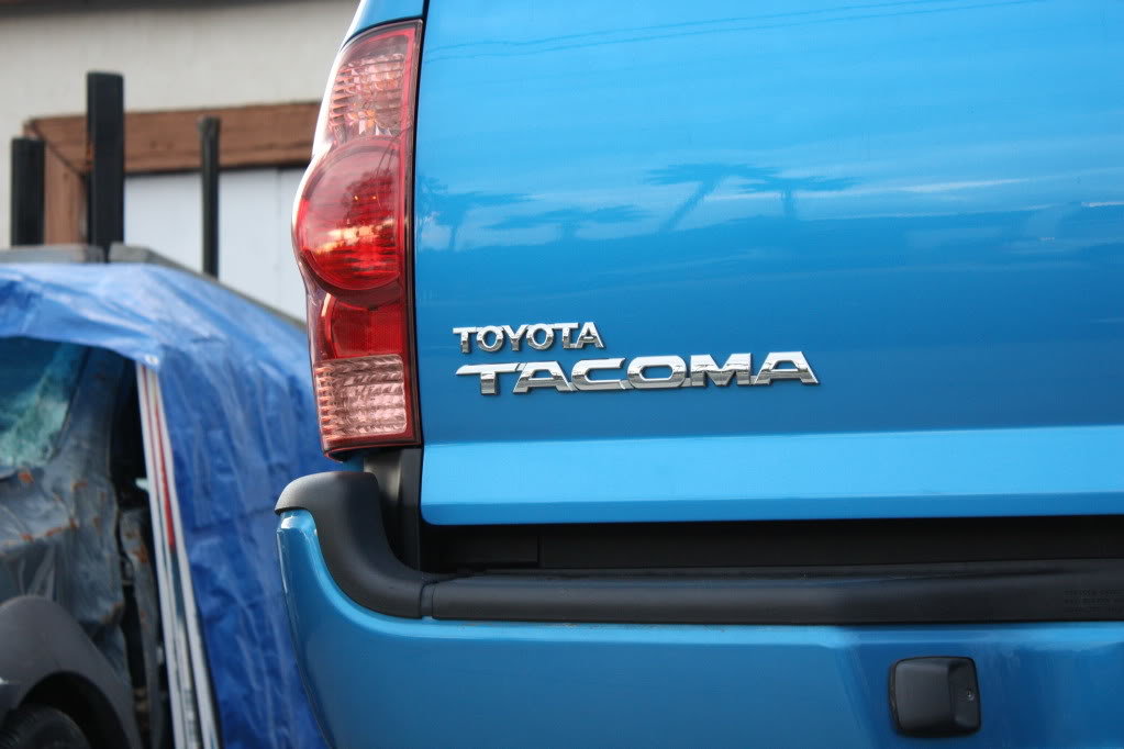

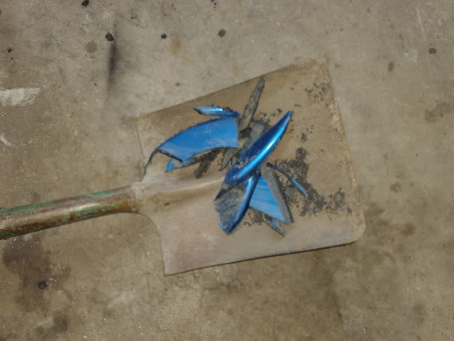

    I got to feeling there was too much noise on the tail gate so off came the badges! I'll get some better picks at work tomorrow and upload them (I'll try and make it fancy since it'll be the same parking lot.)
    The process was simple. I used a heatgun and set it to 1050 (my guns max) and went over the badges slowly, working on bit by bit. After I would get a portion of the badge hot, I would run some fishing line behind it in a sawing motion. I heard GooGone is a good product to use though I used some spray car cleaning thing, a useless credit card, and a cloth to get the adhesive off. It takes some time.

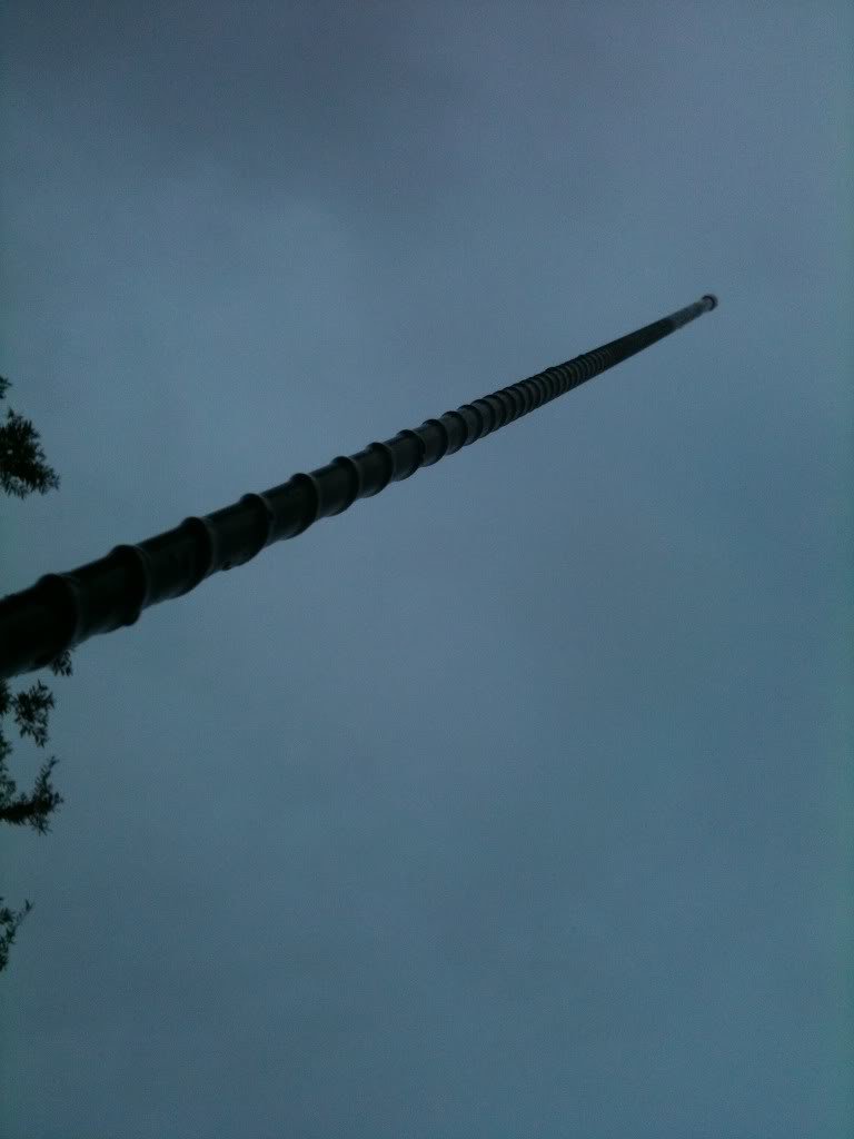

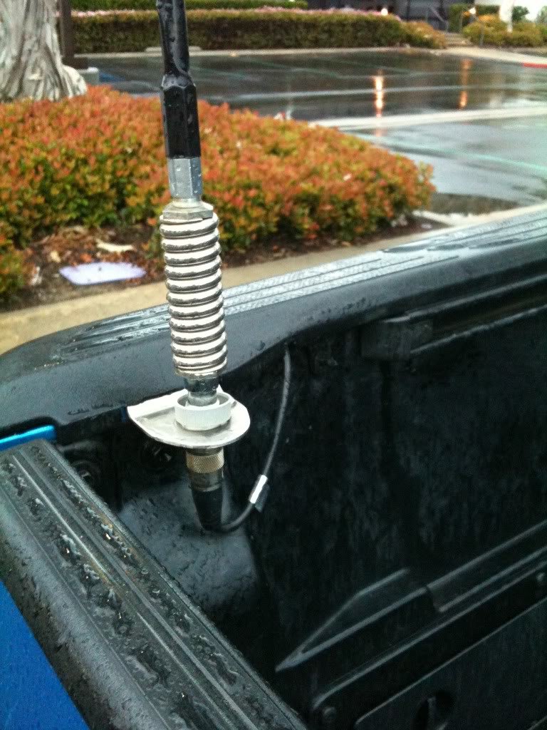

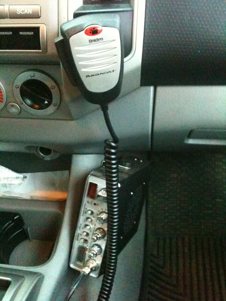

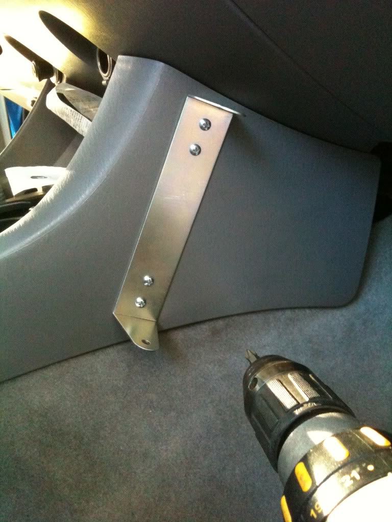

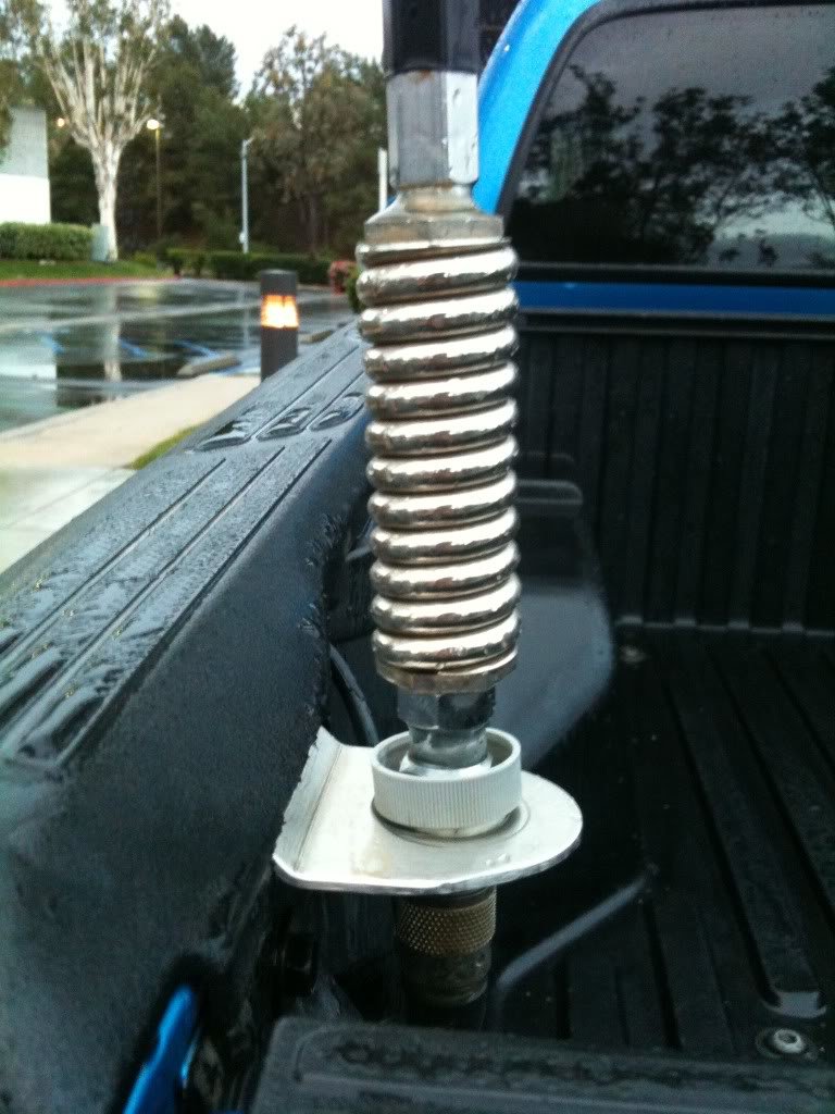

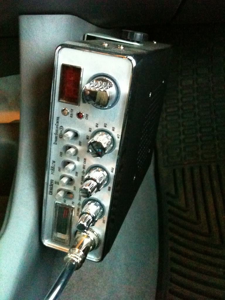

    ....The one pic of my CB install??? I could have sworn I was snapping away during this install... I'll run out and get some pics with my phone cam when it lights up outside.
    Anywho! Got me a Uniden PC68LTW and had a friend- who was in the know how- help me out with the install. He did it very professionally and my set up works and looks more than great.
    Booya! on to the good stuff- suspension next.

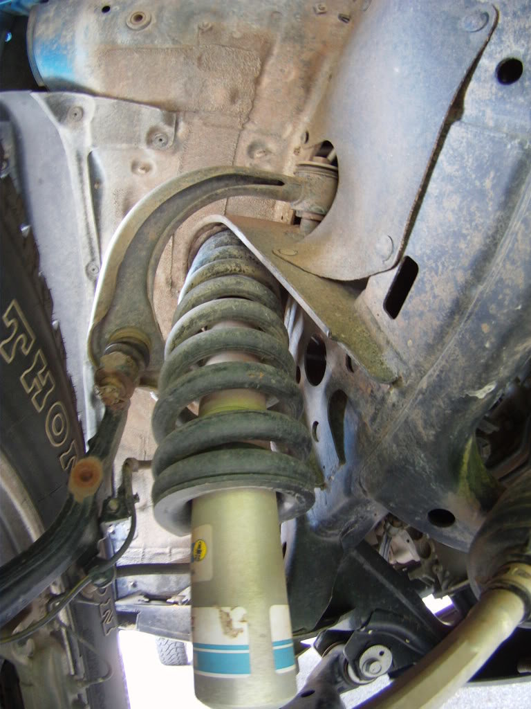

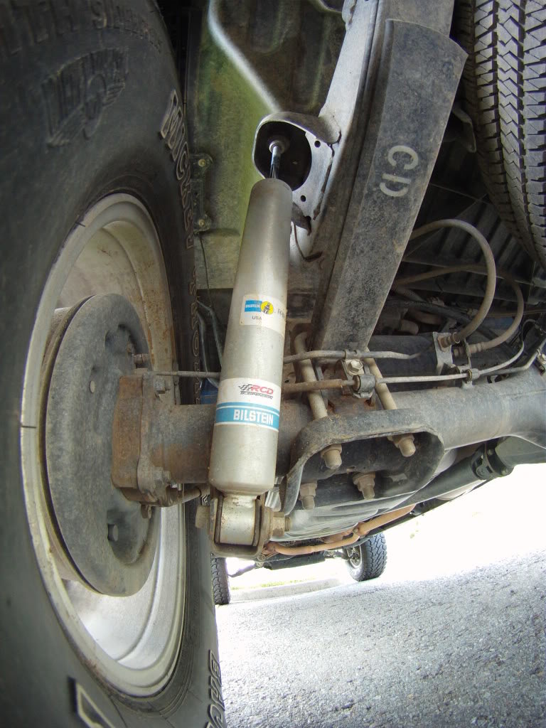

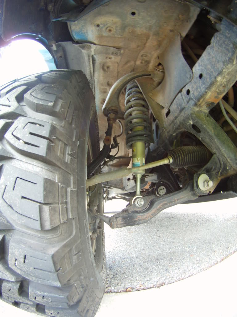

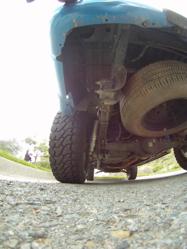

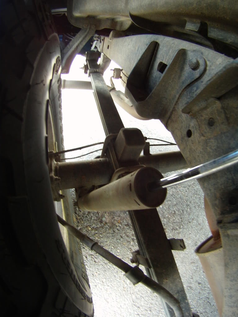

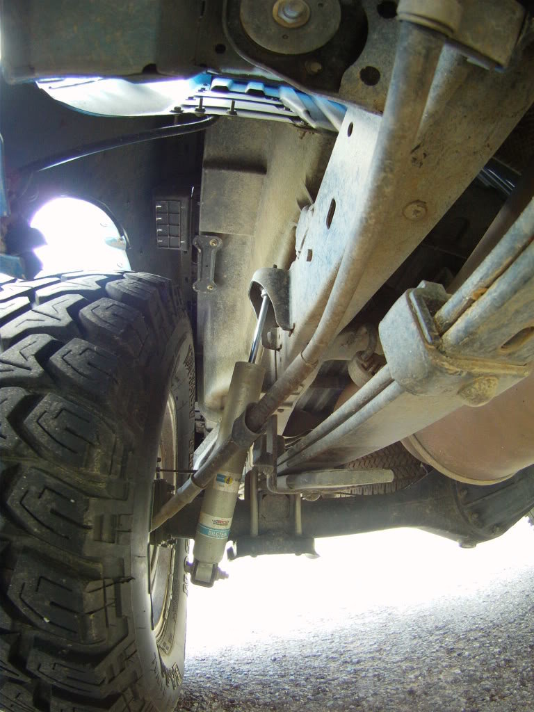

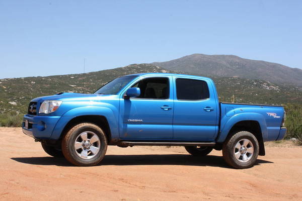

    No pics of the 5100s during install but took these pictures bout a month ago. Did the rear shocks first and the front about a week or two later. The fronts are set to 0", letting the OME coils do the lifting. We were in a rush, starting my truck at 9p.m., so we didn't measure the height before-hand, but it looks damn well near 3". Props to Reckless and 4WD for help with the install.
    Rear:
    Front:
    took that sway bar off too

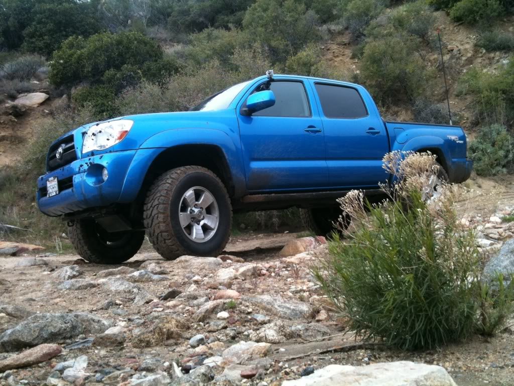

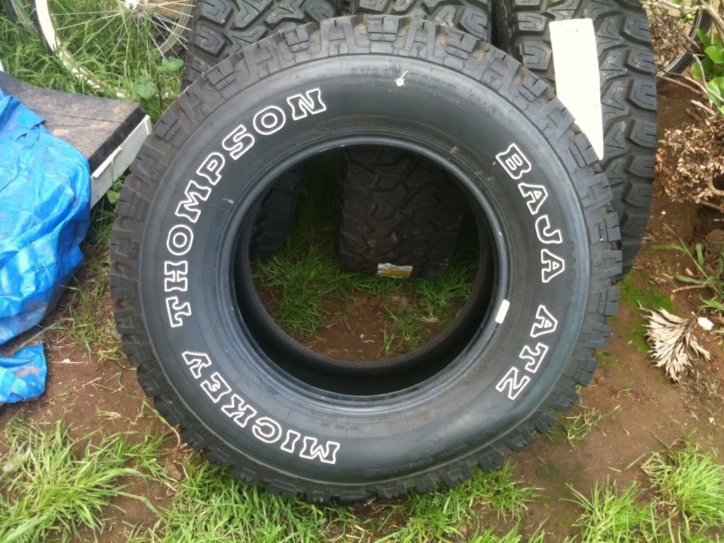

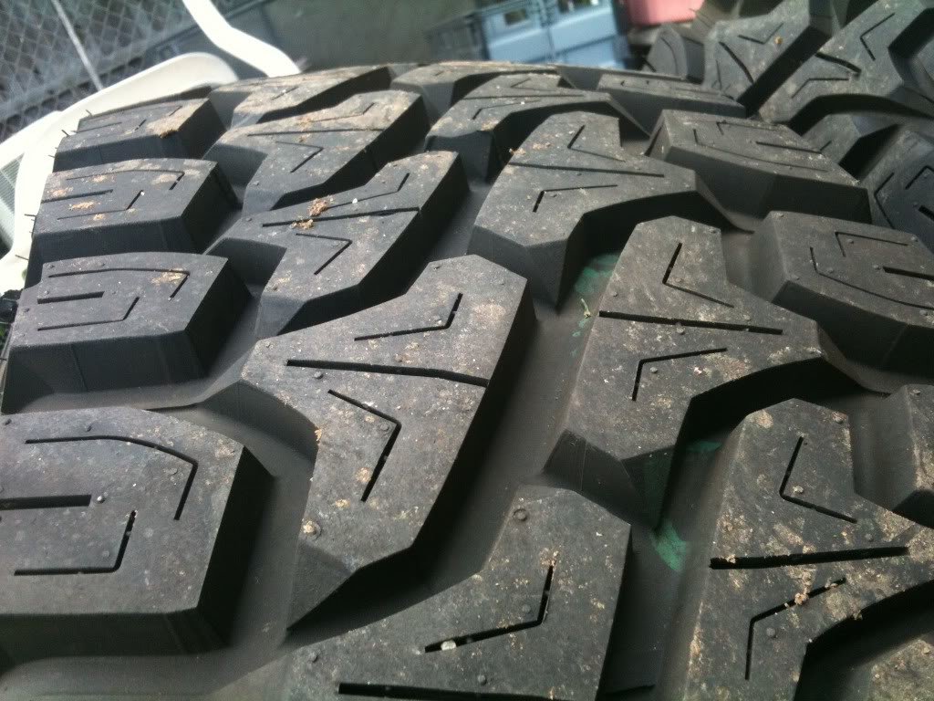

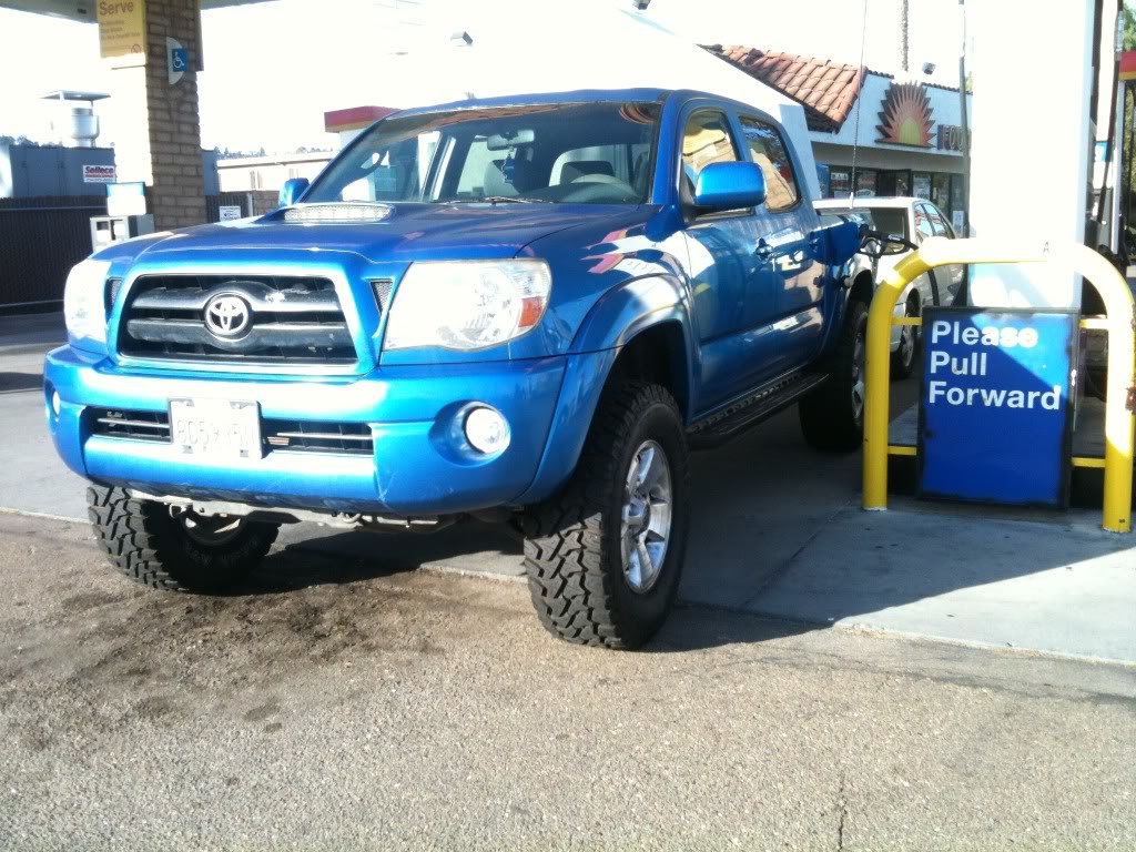

    I bought some Mickey Thompson Baja ATZs from SMSgtRob. They were pretty much brand new. Traveled from San Diego to Palmdale for an awesome price on the tires. Thanks again, Rob!

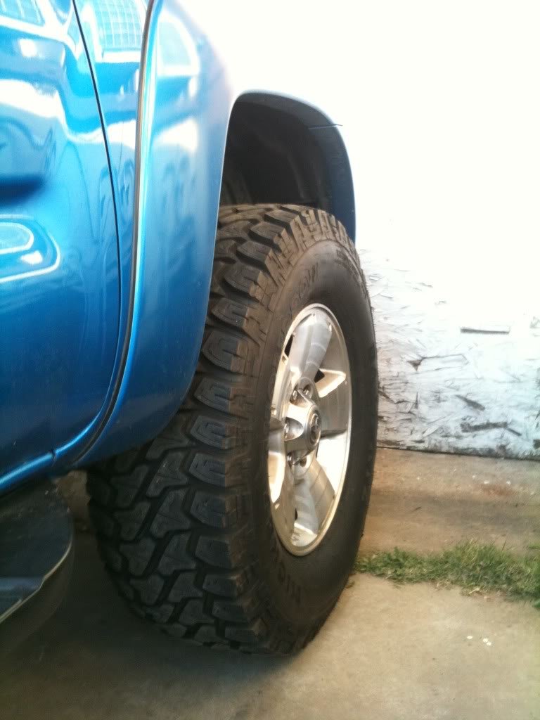

    A couple weeks after getting the tires, I ran out to AllPro Offroad in Hemet to get some 1.25" hub-centric wheel spacers so I could mount my tires without rubbing against the spindle. Also bought some extended threaded lug nuts to better secure the spacer. Didn't want to wait for shipping; I was desperate to get my tires on.
    My dad and girlfriend decided to lend a hand during the install.
    Put some lock-tight in there to keep the ET nuts on there nice n tight.

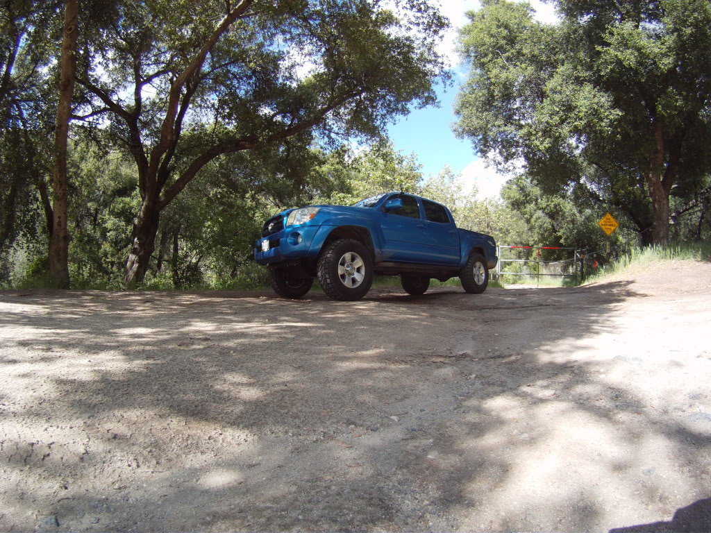

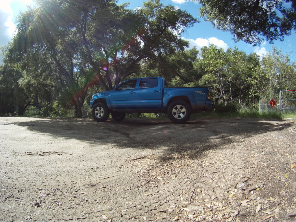

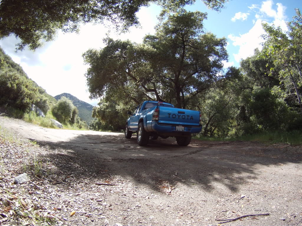

    Threw on my faithful Geolander street tires that I've had since I bought the truck and hit the road with my Baja ATZs in the bed to get them mounted.

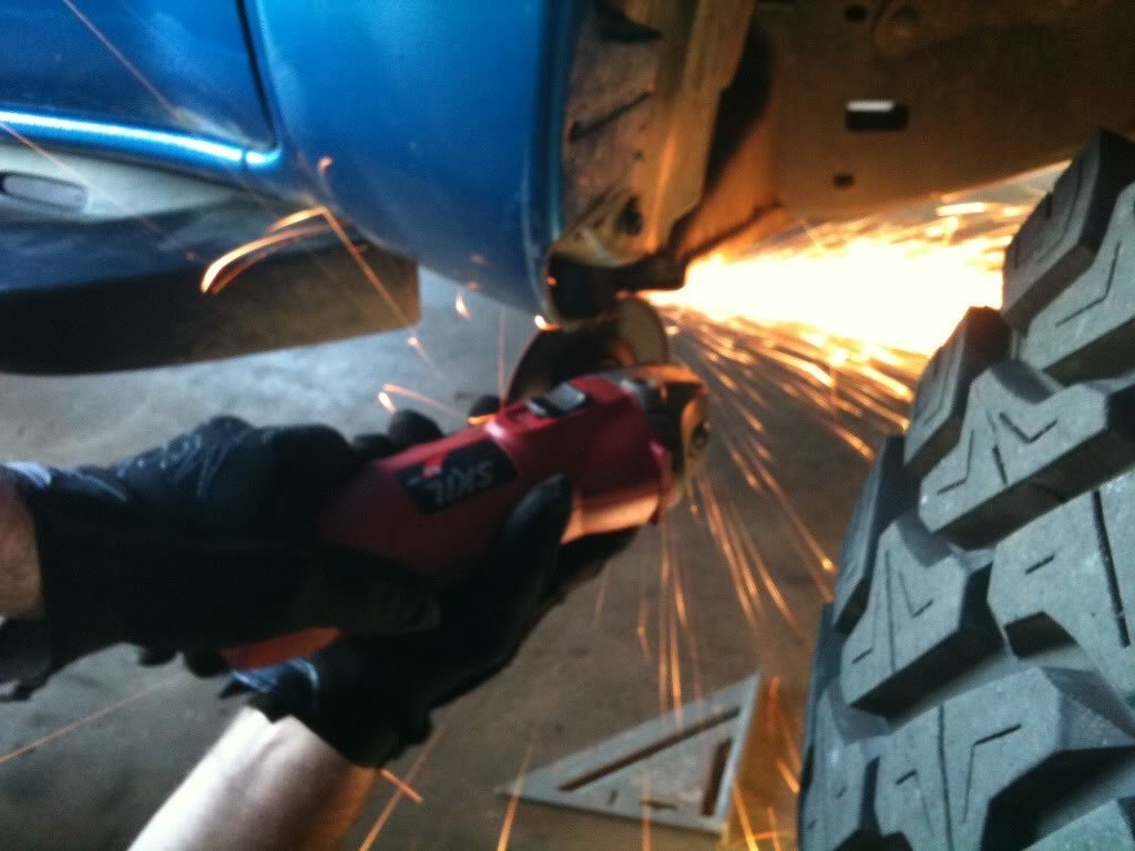

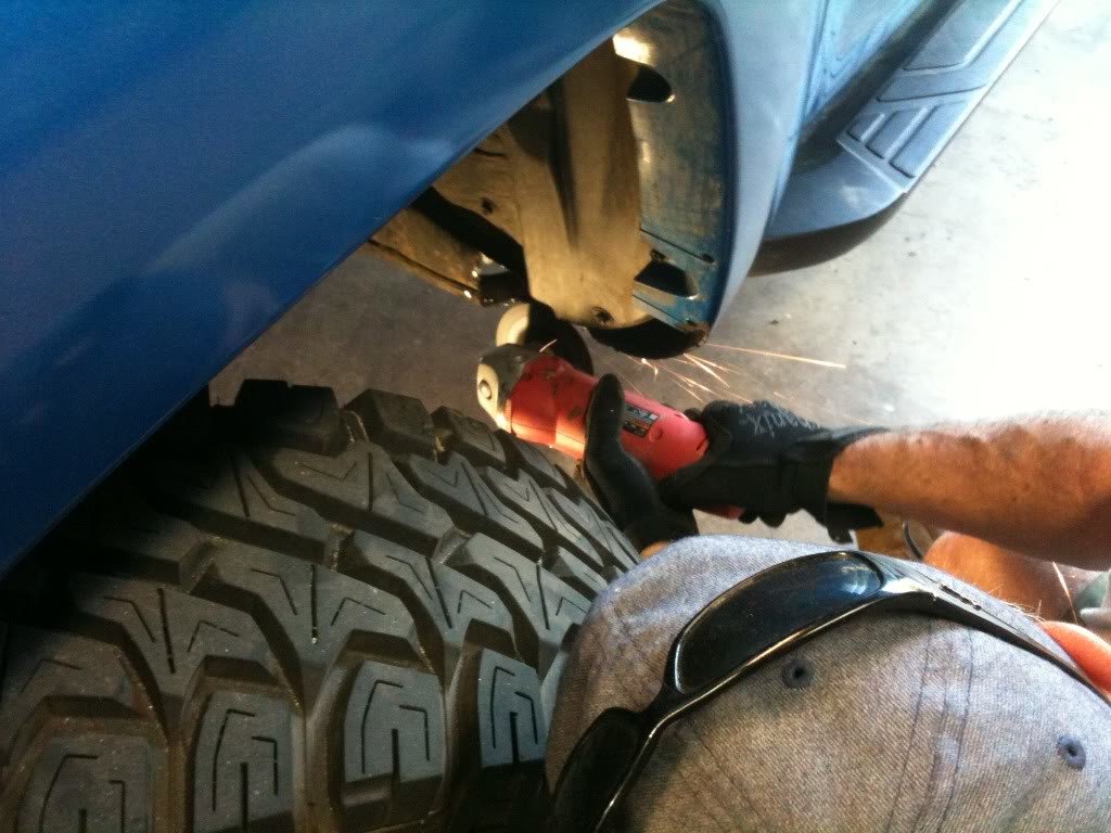

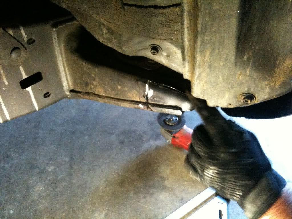

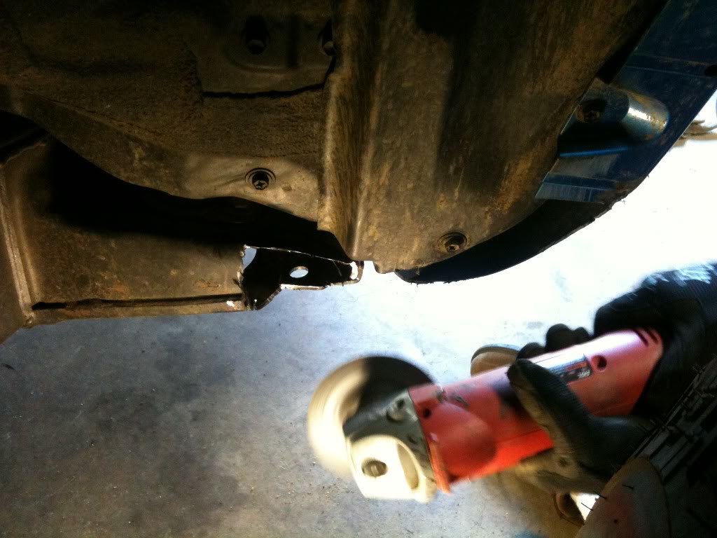

    Right after they were mounted, I hit up Old Crazy's Carport in El Cajon to have some cutting done
