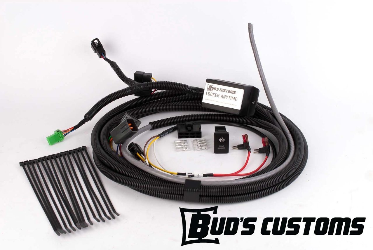

    Lot's of fail-safes/monitoring at the skid control ECU and 4wd ECU; as well as between the two ECUs via CAN.
    See below thread where this was discussed.
    https://www.tacomaworld.com/threads/trd-off-road-4x4-locker-anytime-modfication.440166/
    This is the closest thing there is. To my knowledge, know one has bitten the bullet and tried.
    http://www.budscustoms.com.au/locker-anytime-for-hilux-n80-fortuna-revo
    If you have the skills, by all means...you'll be a hero.
    Just wanted to let you know what you're in for, if you didn't already know.

    I've been trying to find wiring schematics for the vehicles it does work on.

    There is indeed a lot going on as described by Splitbolt.
    Here's a link to the service manual (thanks @over60 ). Start reading at the bookmark "VF2CM Transfer" (page 10,924) and you'll get the idea pretty quick WRT 4WD modes and how they're detected:
    https://onedrive.live.com/?authkey=!ApVq9MTr1-x4Xik&cid=E4201B2041C373EC&id=E4201B2041C373EC!473&parId=E4201B2041C373EC!152&action=locate
    If you read the failsafe charts, one of the things that always seems to happen upon malfunction detection is rear axle unlock.
    Not saying it can't be done or shitting on the idea, just saying that it's not gonna be shit simple or the same as other gens. I'd personally like a 2Lo work around for backing up with a trailer etc as well as the locker anytime mod.

    Between locker failsafe chart, page 2,159 and transfer case failsafe chart, page 10,957...
    You'd have to do a lot of bypass switching on both sides(switch position and position monitoring) of the skid control and 4wd ECUs; plus trick the CAN.
    IMO, $525-AUS($415-US) for the Bud's Custom, would be a deal if it worked for the Tacoma.

    Just ordered some parts, I think I will make a similar box like the other company, but it will be simpler.
    What would you guys pay for a product like this?
