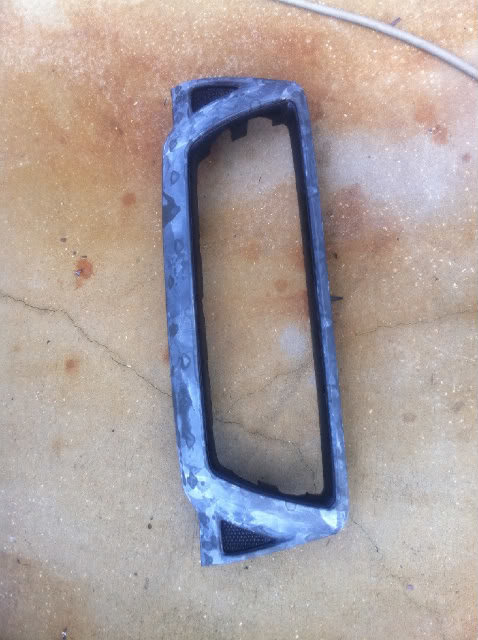

    Took all the chrome off my grille, now time to color match it. Here is how it's done.
    Thing you need- Water,High PSI Pressure Washer,Toyota Tacoma with Lame Chrome Grille,Beer.
    Step1: Take chrome grille off tacoma.
    Step2: Sand any edge of the grille until it is black color.(sometimes you don't have to do this step)
    Step3: While using a 15-25 degree tip begin to blast at the edge on the grille. Sometimes you can just blast the middle.
    Step4: You will see the chrome beginning to peel up and fly away. (thick tinfoil like)
    Step5: Keep working at it until you get all the chrome peeled away,i used needle nose pliers to pick out the tiny pieces in the cracks.
    Step6: Post your picture on this thread!
    Hope this helps!

    Nice how did you take the chrome off?

    pressure washer lol

    nice...kinda looks like digital camo in the pic

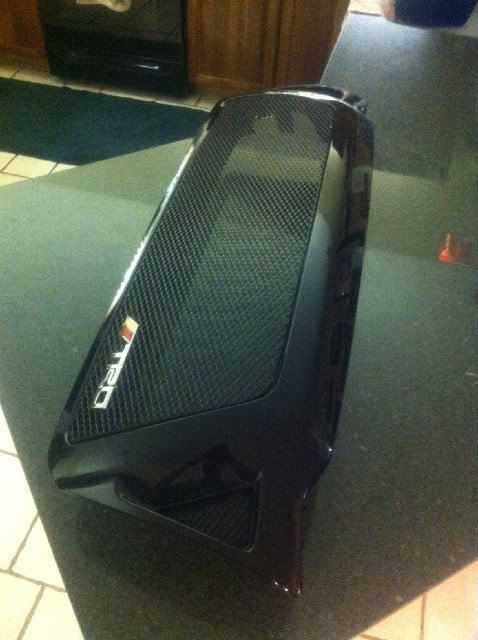

    haha does anybody know a ballpark price that i can get this color matched for?

    I just had dealer order me on a black one..think it was 200 dollars

    Body shop will charge $75-$125 to color match it.

    i got mine color matched at a body shop for $100

    Macco, had two done for $45 each. Good quality too.

    How long did it take to get the chrome off with the pressure washer. I think im about to give it a shot.

    DEAR TACOMA WORLD.
    OP IS A FUCKING GENIUS!
    It works. Just have to get under an edge of the chrome and it starts to peel right off. Its like a foil coating.
    ITS WORKING!!!!!!!!
