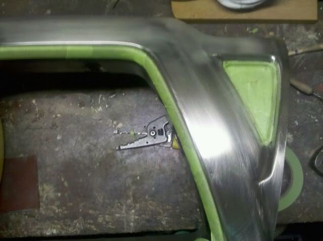

    Ok, so I decided to go ahead and try this one on my own. Why not, right?! lol.
    I went ahead and purchased some adhesion promoter, primer, base and clear. I also picked up some epoxy and putty (which is really quite noxious in a closed space, lol).
    Heres a quick cell pic:
    I managed to sand down the chrome finish tonight, and stopped there for that part.
    Heres my next question. Am I wasting my time by "satoshy'ing" the part? I'm going to flush mount the GC mesh, but I didnt want to be able to look through it and see a hacked up grill, so I epoxy'd new plastic pieces and putty'd over them. I sanded it down and will paint it flat black once I do a little more touch up. I basically made it so that I could run the mesh behind the grill if I wanted, even though I'm not going to. I hope I explained that right, I think I'm still high from all the fumes, lol :cool:

    I am doing the Satoshi right now. I seperated my two pieces. The outer piece required no body work. But, it was scratched so it required painting. The inner piece, the one requiring repair after the cut, was a major pain. Not the painting but getting the surface right. Took allot of putty and primer to get it finally right. Just painted and clear coated yesterday. Will wet sand and buff sometime this week.
    My point is the painting, whether it be rattle or using HVLP like I did, is not the issue. Getting the repair surface just right so you can't see any of it is where the work was - at least for me and my extreme novice abilities.
