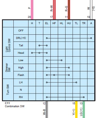

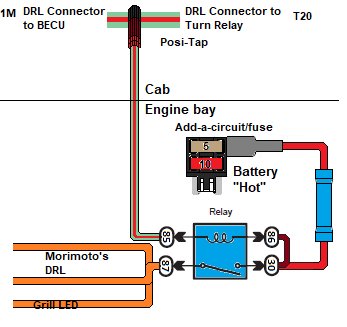

    Thanks guys for the troubleshooting.....I've got this schematic...looks like I'm going to have to run a cable to my cab to attach into my DRL wire on T20

    @caribe makaira @daveeasa
    My stalk is as follows: off, DRL, parking lights (DRL w/ Amber corners), halogen lo beams (all bulbs on)
    @caribe makaira helped me out on another thread I created for my Alpha-Rex's I will be installing later.
    Simple question was if there was a DRL toggled wire in the engine bay.
    I think i got my question answered.
    Thanks guys!
