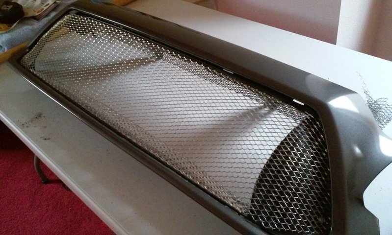

    ^^^ first attempt at home made grill with expanded metal. I didn't like how it looked and it was sharp! I had a lot of cuts when I was done.

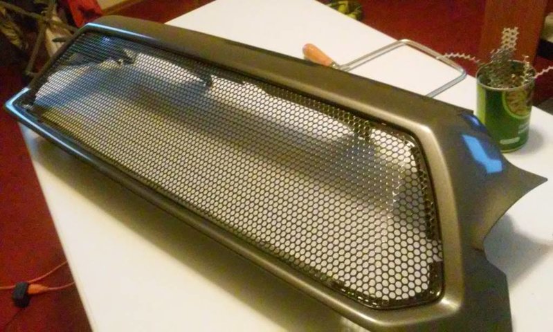

    My second attempt is what is currently installed. Drilled aluminum sheet. cost me $45 total.

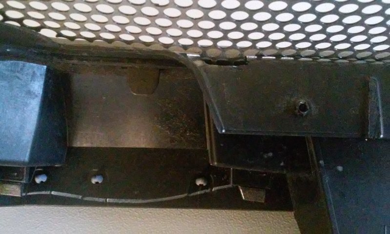

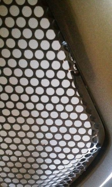

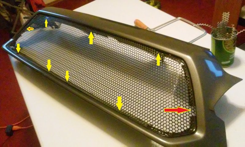

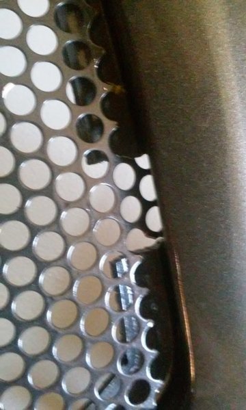

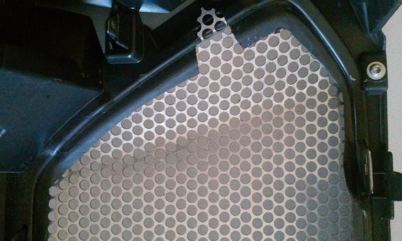

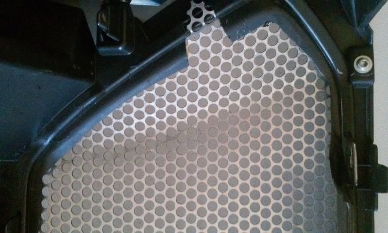

    Perforated sheet aluminum.
    http://www.grainger.com/product/GRA...m/rp/s/is/image/Grainger/5PCY6_AS01?$smthumb$
    The aluminum is sandwiched between the two pieces of plastic that make up the grill.

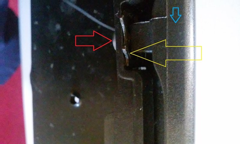

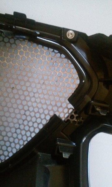

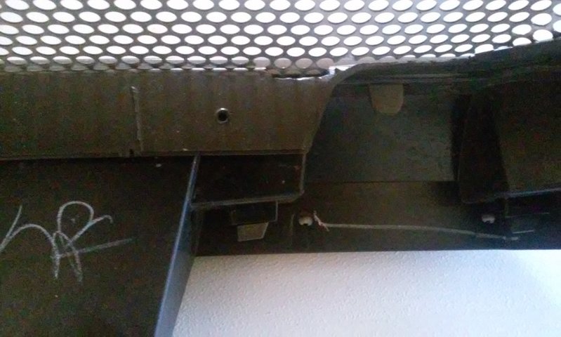

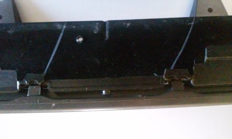

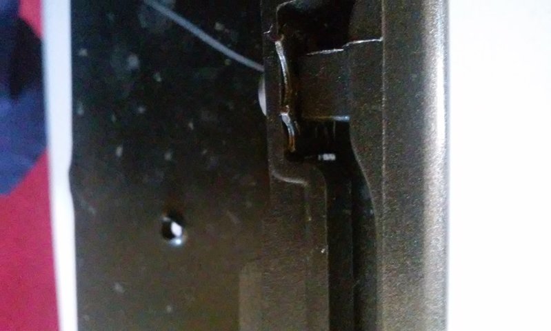

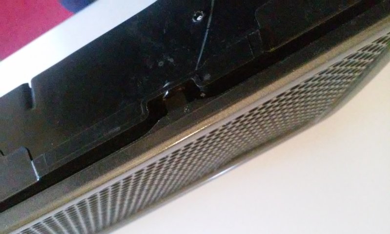

    0531151327.jpg <- Center bottom mounting
    0531151328.jpg <- left or right side mounting
    0531151328b.jpg<- back of grill showing tab cutouts for aluminum tabs to be sandwiched
    0531151329_1.jpg ^ red arrow: compression screw
    yellow arrow: aluminum tab
    blue arrow: painted plastic shroud
    ^Yellow red arrows are tabs only not sandwiched.
    Yellow arrows are tabs sandwiched between back mounting plastic with tab cutouts and the front shroud
    ^bottom center tabs bottom view
