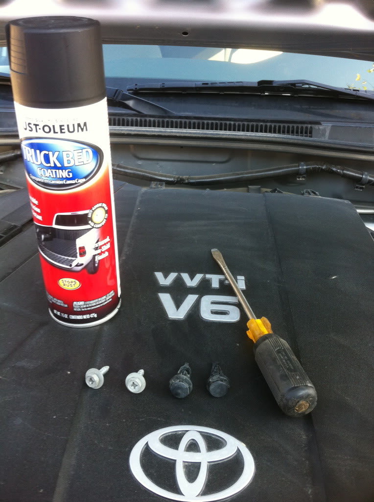

    what youll need (tools and what you need to remove)
    Its really simple
    1. lift the hood and unscrew the two screws connecting the grill to the frame (dont have pics of these but they're right in front of you)

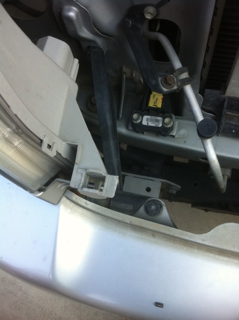

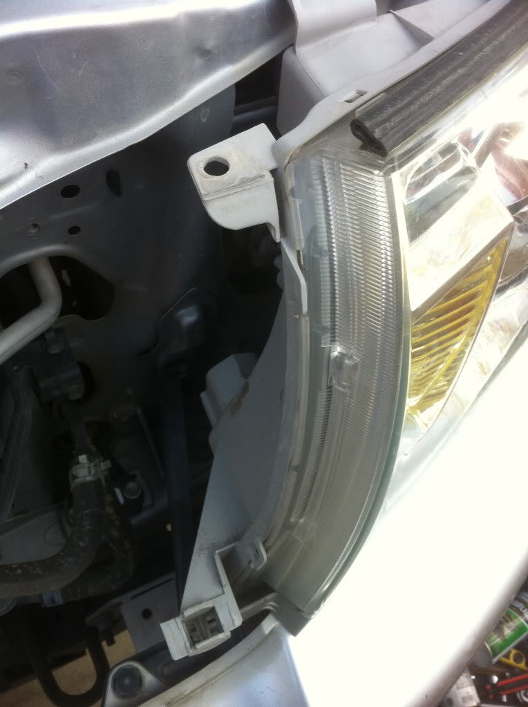

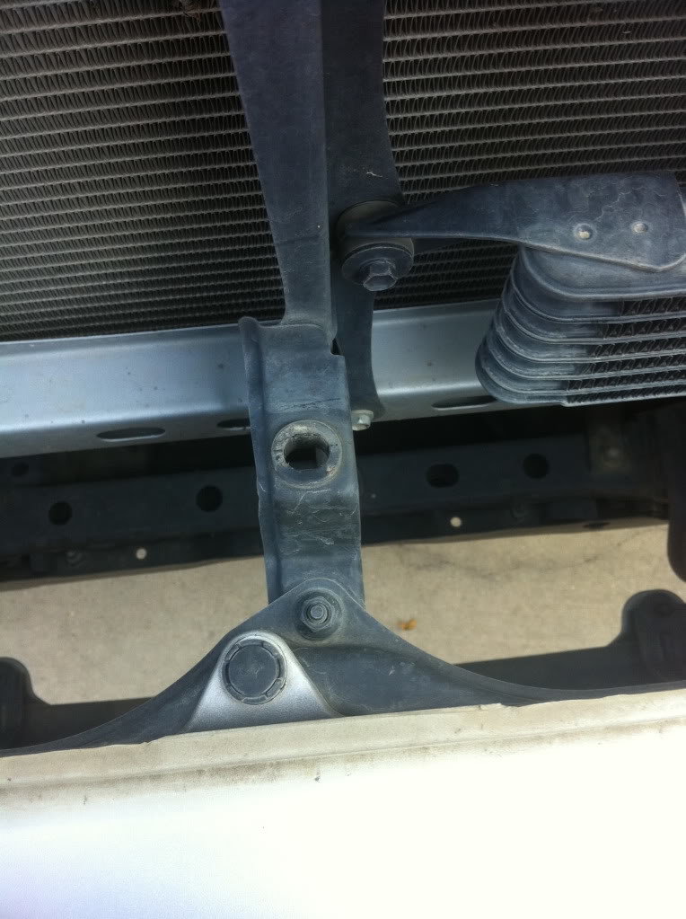

    2. Theres two "push pin" screw that connect the grill to the headlights, you can use your fingers or a flathead screwdriver to pry these out. These are the holes where the push pin screws go
    IMG_0314_80edb7e6edb966346a4eac48eb7a38df6a5062dd.jpgIMG_0316_f8f57569aa3982092469cc4a46b0b909bd73be22.jpg
    3. Once ALL FOUR SCREWS ARE REMOVED, pull straight up on the grill and it will disconnect from the clips

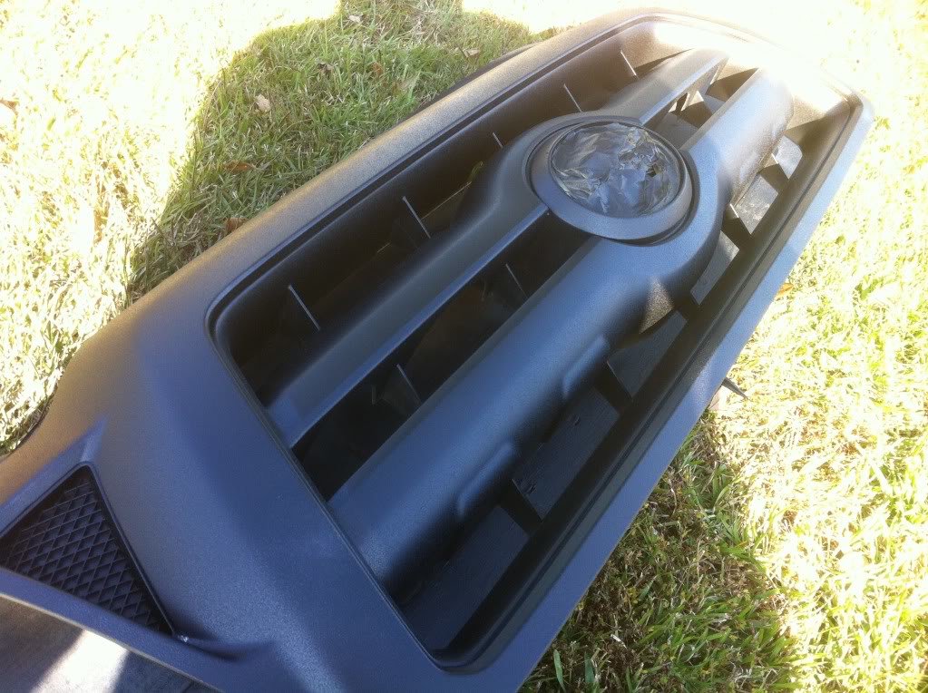

    4. I took off the emblem just so it would be clean looking once i put it back on, and i taped up the alot where the emblem goes so the bed liner wouldnt affect it being flush with the grille
    (after 3 coats)

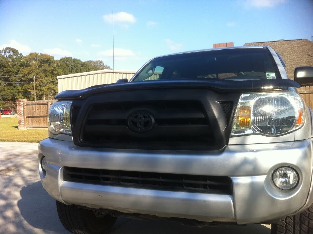

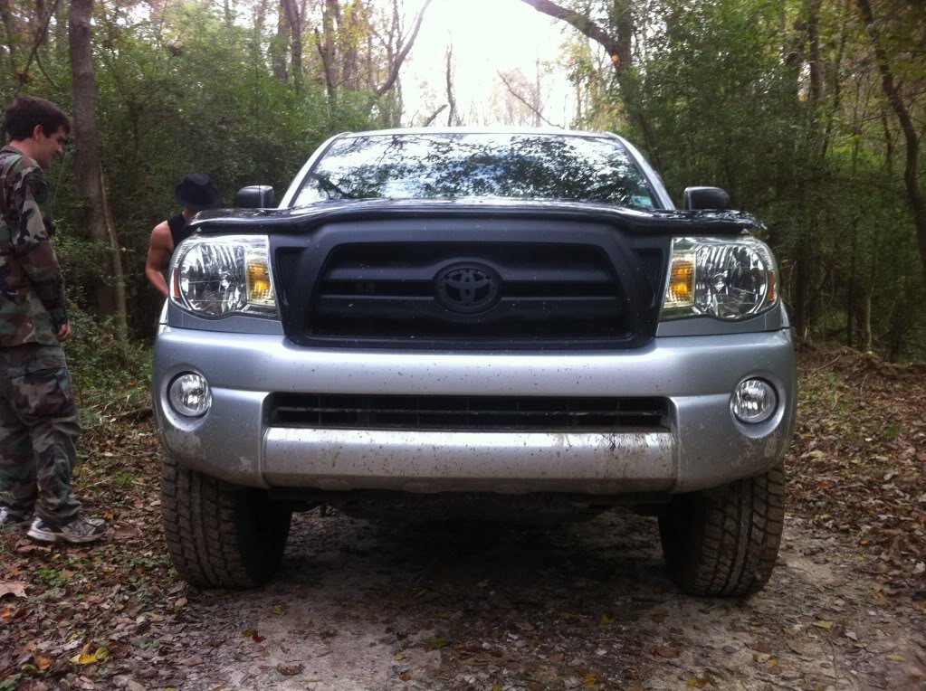

    FINISHED PRODUCT without emblem
    well there it is

    looks great! did you rough up the cchrome?

    no i actually just wiped it down with rubbing alcohol, i didnt have an sand paper or anything close by so i figured three coats would suffice and its held up pretty well!

    I actually used this can of bed liner on my previous grill. It held up for a while but slowly started to chip. It was hard to wash also since its pretty rough. I ended up throwing that grill out and replacing it. Hope urs holds up though!

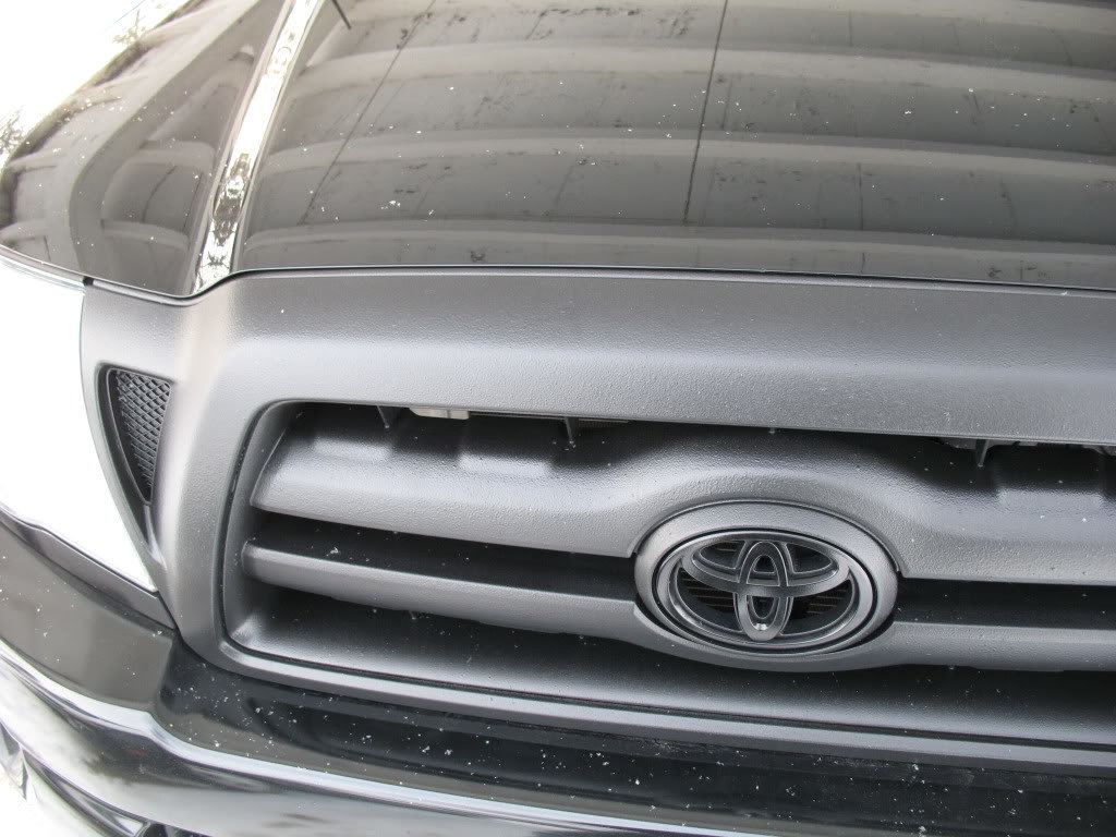

    just did mine last night....i dig it alot i used 4 coats of duplicolor truck bed spray....thanks for giving me the idea OP IMG_8603_b0020b48cfed7ae8110a4a798abae1c729cde74e.jpg

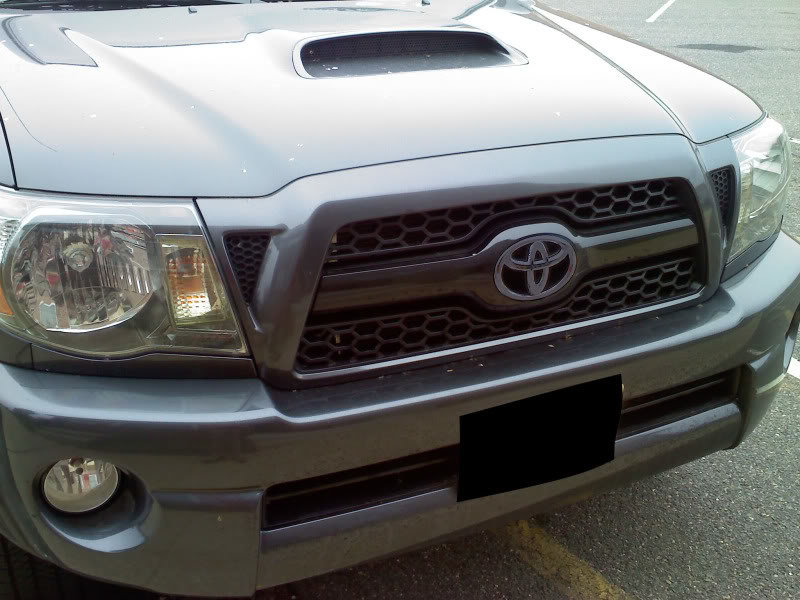

    I've been debating this for awhile. I have a magnetic gray metallic 2011 Taco and I've been considering color matching the Toyota logo on the grill to match the body of the truck. I'll photoshop something up soon and post.
  20. Apr 20, 2011 at 7:51 AM
    #20
    sbates
    sbates Well-Known Member
    Dec 13, 2010
    #47635
    62
    Steve
    NJ
    2011 Tacoma TRD Sport
    Extang Tonneau Cover, aFe Pro Dry S air filter, Weathertech Floormats, De-badged, Plasti dipped Toyota emblem black, Plasti dipped a/c control panel black, 48-led Dome Light
    What do you guys think?
