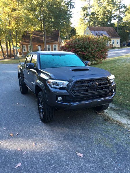

    TacoTuesday86
    TacoTuesday86 [OP] Well-Known Member
    Sep 29, 2015
    #165454
    68
    2016 TRD Sport DCSB M/T MGM 4x4
    The plasti dip holds up great I use it on all kinds of stuff. The beauty of it is, that when it starts to look like shit you can peel it off and re spray. It looks like a factory grill vs spray paint that would look like hot garbage

    JKrammes
    JKrammes Active Member
    Feb 3, 2015
    #147825
    39
    Jeremy
    Pa
    I used Krylon Fusion black to paint my center wheel covers on my '06 TRD Offroad. That held up great and looked real good too.

    Denver

    plastidip holds up pretty well if you do it properly.
    I used it on my front grill it still looks the same 3 years after.
    Just need to make sure to do a proper good even coating and a few layers
    proven21 and TacoTuesday86[OP] like this.

    Did you take the grill assembly apart to dip it as separate pieces? or just dip it as one piece like you show in your first photo?
  11. Oct 19, 2015 at 10:36 AM
    #31
    awdj
    awdj Well-Known Member
    Oct 9, 2015
    #166237
    579
    20' Tacoma TRD PRO
    Looks like he just removed the grill assembly as once part. Also, I don't think he dipped the assembly in plasti-dip, he most likely used the spray can variant.

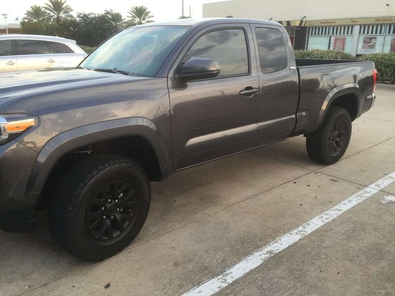

    There's a matte black you can buy them just put a clear coat they make to give it shine. I dipped the factory alloys matte black and the side badge. image.jpg

    TacoTuesday86
    Sep 29, 2015
    #165454
    68
    How many cans did you use on the wheels
  17. Oct 19, 2015 at 7:41 PM
    #37
    TacoTuesday86
    Sep 29, 2015
    #165454
    68
    I removed the assembly and and the bezel and sprayed them seperate then re installed it

    erictski
    erictski Well-Known Member
    Aug 19, 2015
    #162189
    81
    Eric
    NE WI
    2016 DCSBOR Black
    Nice that must have made for cleaner edges it looks great

    16 Tacoma DC SB tss
    None
    Used 3 cans for the whole job. Light coats every 15 minutes. Did about 10 light coats. It's a job that requires patience more than skill.
