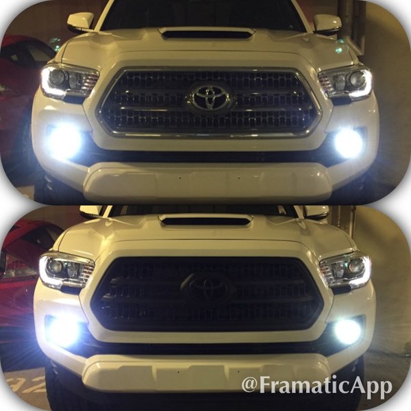

    Loving the black grill and LED fogs.
    killthehippies likes this.
