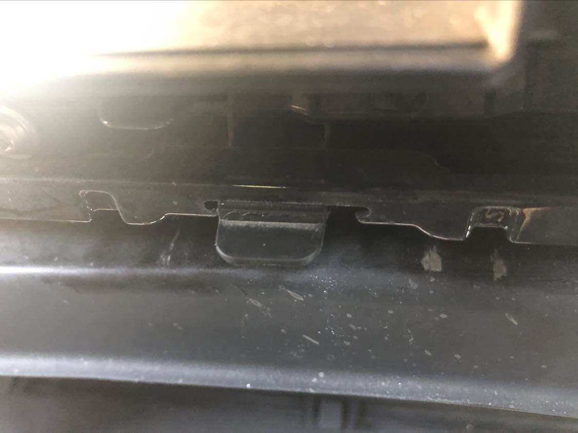

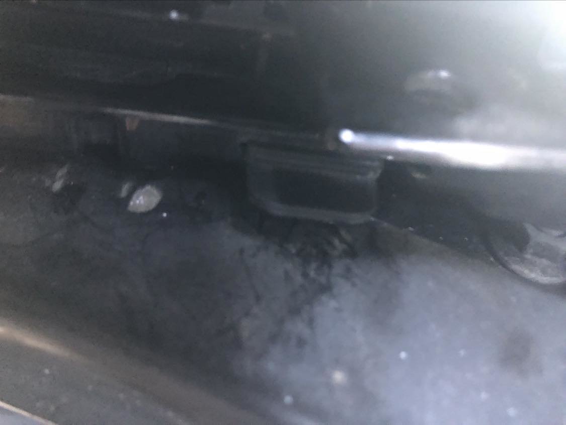

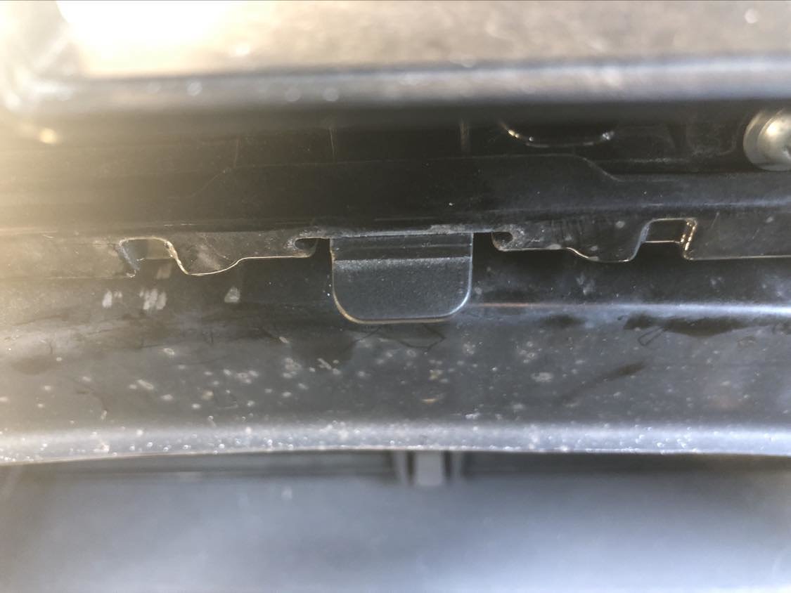

    I trying to take my grill off and these tabs seem to be holding my grill to the lower bumper. How do I push these tabs out? I did it before but I don't remember it being this hard to pull off

    thanks i got it off. I had to use a small flat tip screw driver to pry the tabs off
