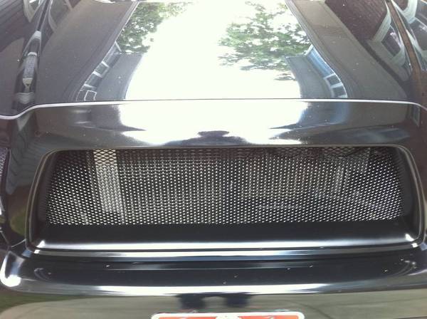

    Here are some pics of my progress so far. You can see the orange peel and defects in the clear coat. These are all just after drying. No compound was used yet.
    I got both the paint and the grill material from ebay.
    Grill
    This was the cheapest grill mesh i found. It was a 12x48 in piece that i cut down. Won't matter for satoshi. It's not too bad, but it came with the edges slightly gnarled and the paint was flying off while i dremeled it apart. It's not powder-coated, it's painted. I think I'll probably opt for a denser mesh in the future.
    Paint
    The paint matches pretty well for a rattle can. I'm super new to paint of any kind so judge the color not the technique.
    And here's whats left of the tabs for re-mounting the front. :confused:
    All the pics were taken with my iPhone 4. Not bad.

    I'm DONE!
    For now at least. I might repaint over the winter. Plus I need do move the horns and paint the radiator.
    You can see the orange peel. It's not too bad. In fact, it resembles the paint on the fender flares. Ebay paint is close but not perfect and the ultimate compound did bring out a little more shine. Not perfect but screw it, it's done.
