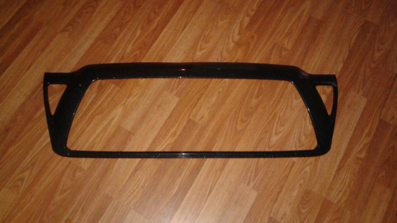

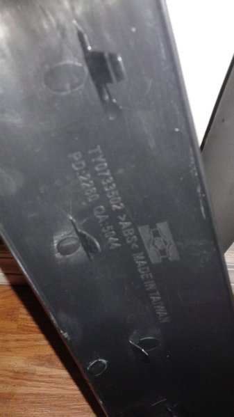

    I got a new grill for my truck (guy I bought it from cut out the spot for the emblem). I got the whole assembly. Went to install but the surround has little tabs all around that just fit into holes, but there is no way to fasten it to the main body of the grill. So it fits in but just falls out. I tried bending the tabs to try and lock it in place but that only lasted about a week before it started coming off.20150610_162424.jpg20150610_162346.jpg

    you have to use a soldering iron to melt those tabs to the slots in the outer surround. look up homertacos videos on grill assembly, that shows you what you need to do.
