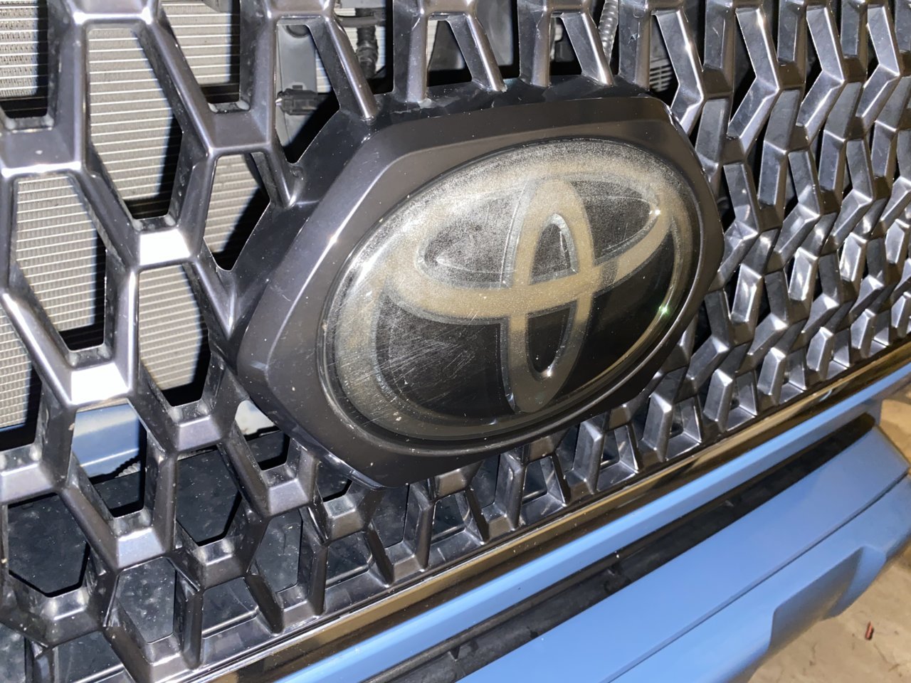

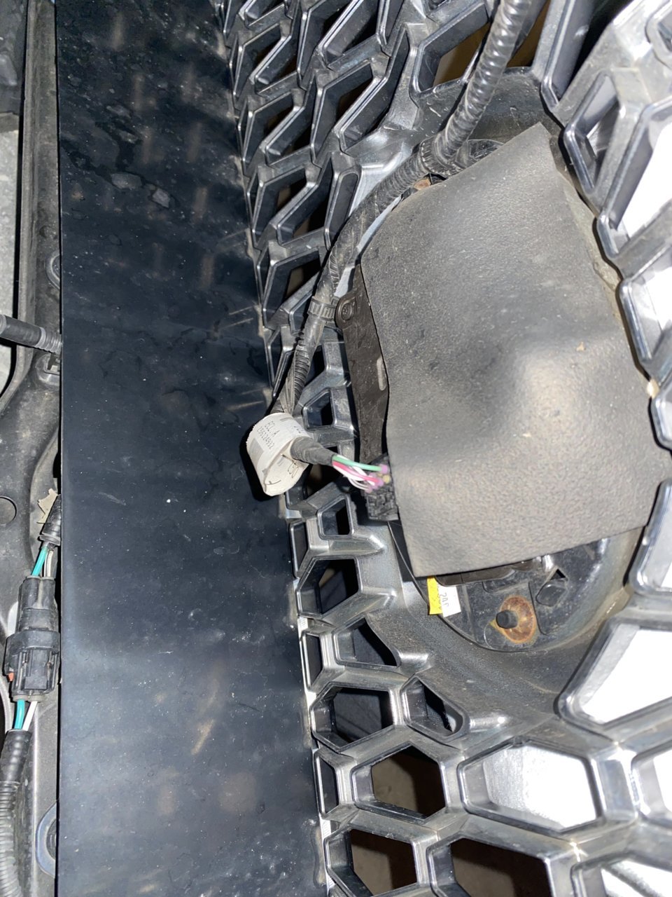

    I have a 2019 TRD sport that I wanted to change the grill out because it’s cloudy. Seen lots that are metal. So when I open the hood there is a connection going to the back of it. Does ANYONE know what this is for?

    The Toyota Safety Sense radar sensor is located in the back of the emblem. That's what the plug is for.
    You'll want a grille that can acommodate that, and some people have problems with aiming and calibration after swapping grilles.

    Yea. It’s your TSS radar. It is used for adaptive cruise control

    If the foggy logo is bothering you, you can put tint or vinyl film over it. Neither interferes with the radar

    Find a used 20+ grill. Looks better and you'll get a new emblem. Or you could cover it with headlight tint.

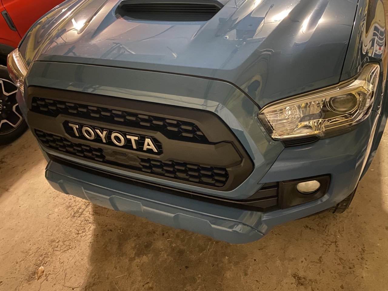

    Ordered and got it installed. I like the difference.
