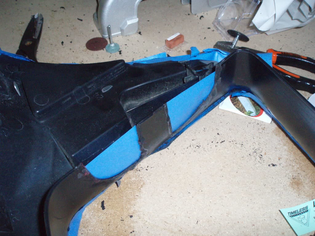

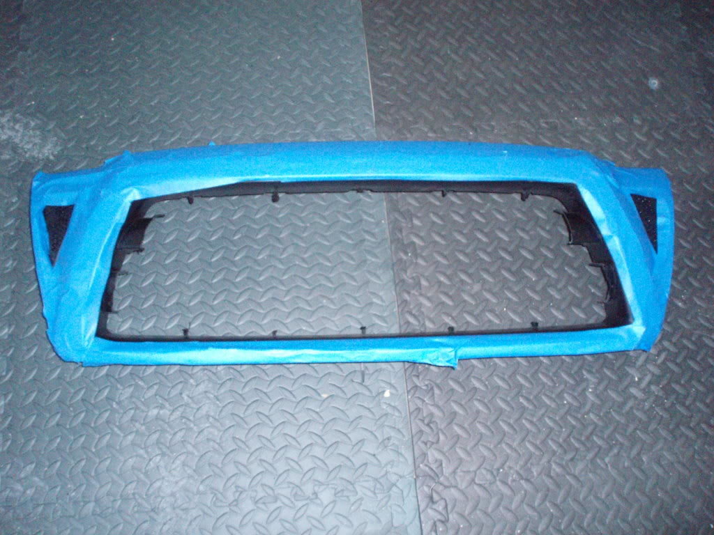

    well, I just installed mine. It looks AWESOME!!! Just some advice to anyone planning on using a dremel for the majority of your cutting, its REALLY tough! The cutting wheels aren't big enough. I just used my jigsaw for the big cuts then cleaned everything up with the dremel. I highly recommend completely taping up the painted portion of your grill or else you WILL scratch the hell out of it.

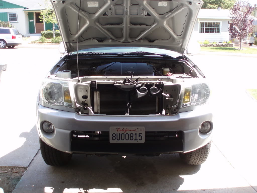

    At the start.

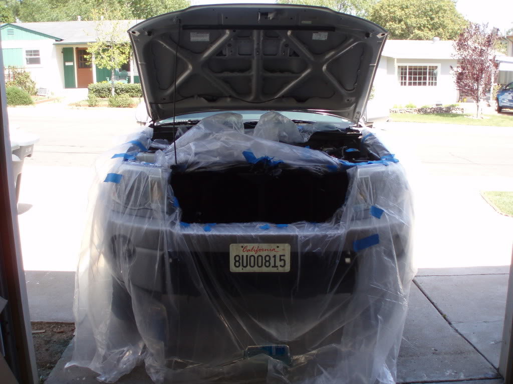

    Masked off for paint

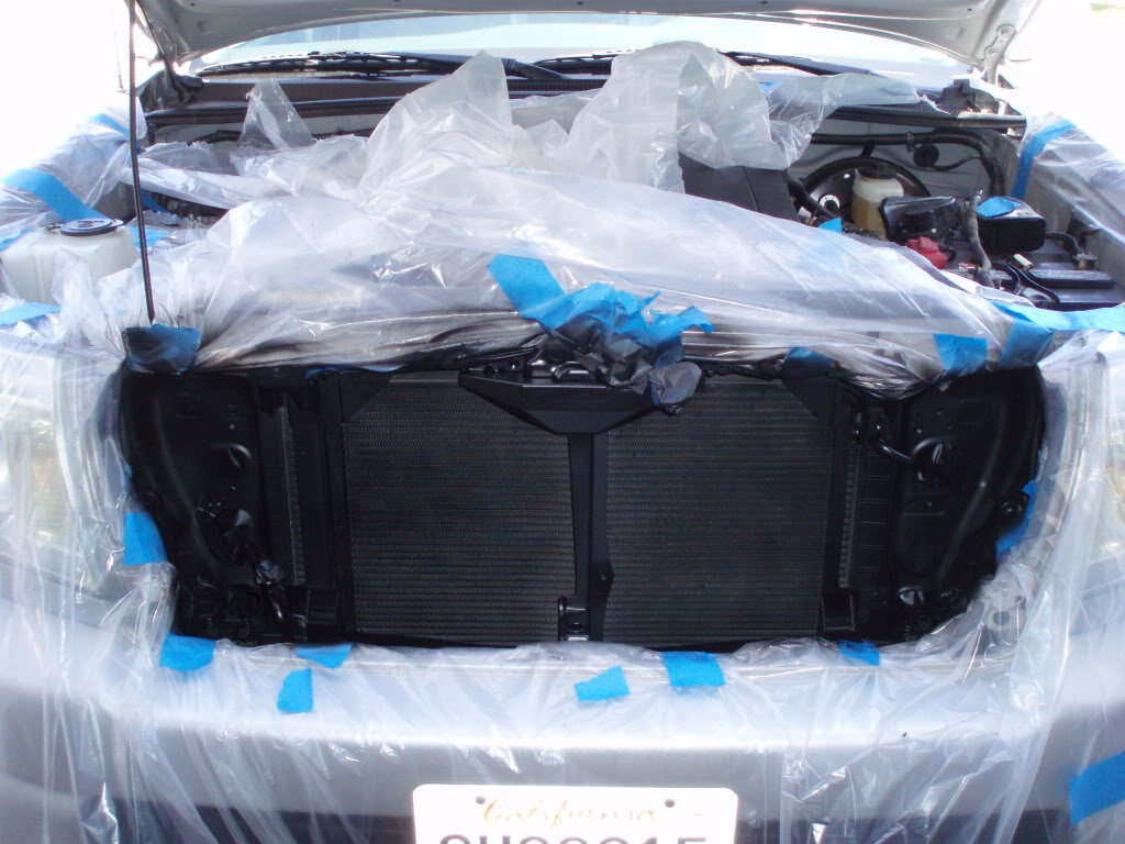

    several light coats of high temp "low gloss black"

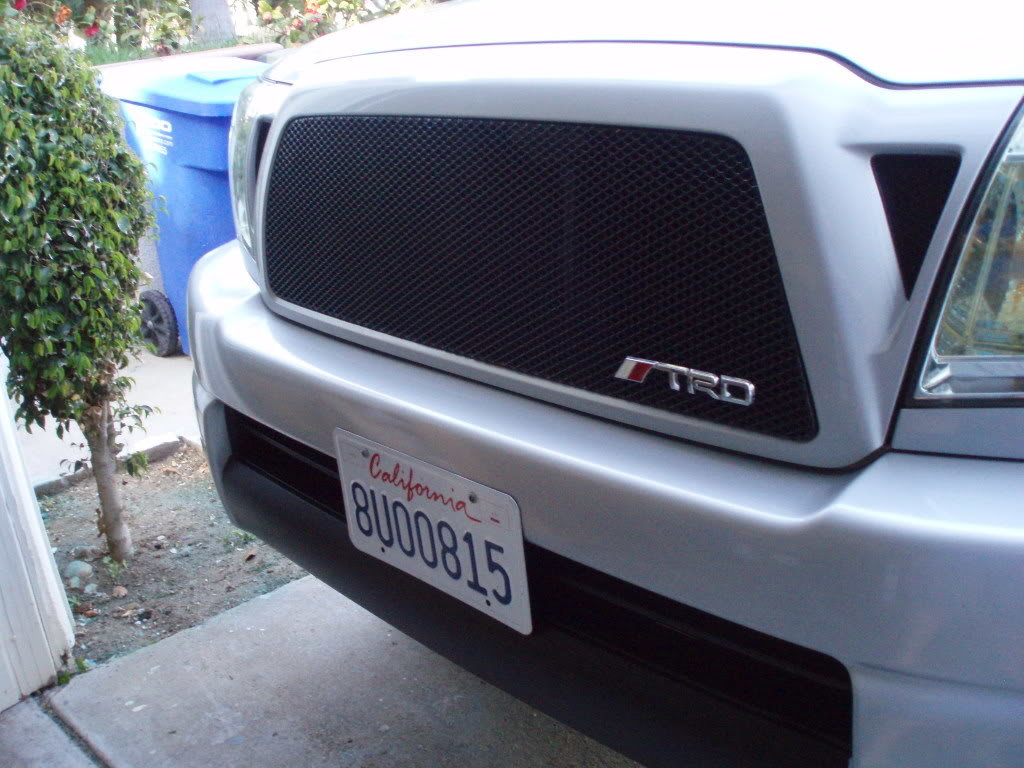

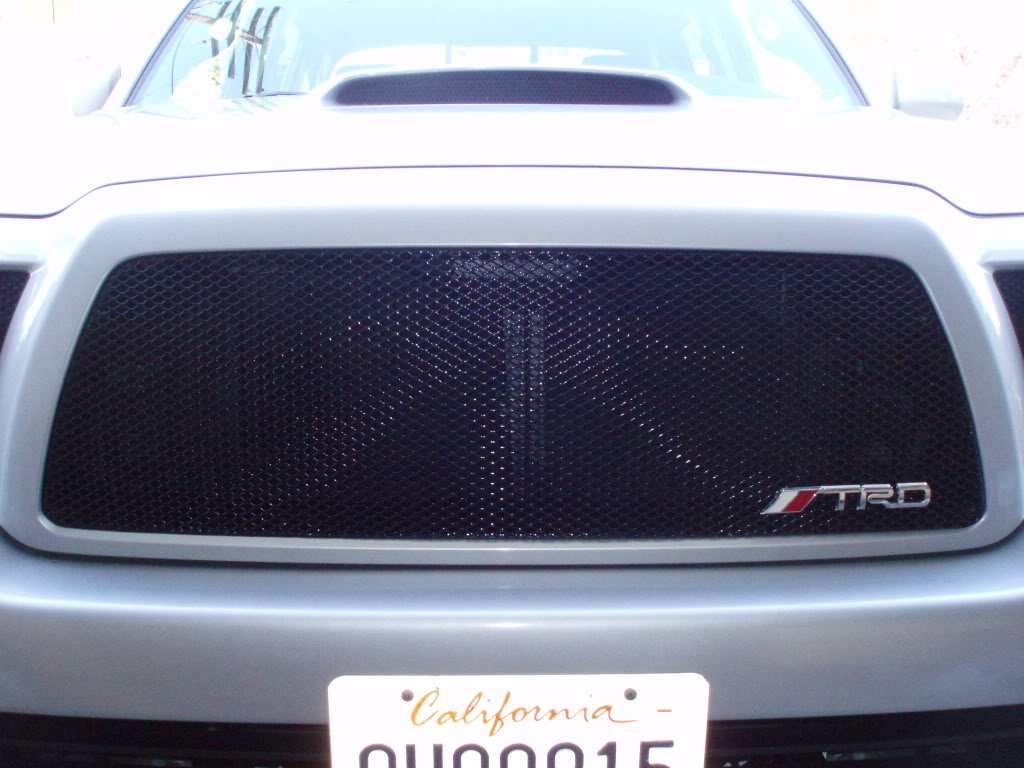

    I know this is lame but I didn't like the look of the two wholes on the side of the grill surround so I put tape over them and painted it;). My girlfriend is gone until tomorrow morning so without another vehicle I couldn't go out and get fiberglass and body filler to do it properly. I used what I had. I don't think it came out bad. I haven't decided if I'll go back and do it properly. I'd suggest to anyone that you patch these gaps like you would for a satoshi grill. I may just be acting OCD but you can totally see them through the grill. if you don't cover them then you will see the gray part of the back of your headlights.

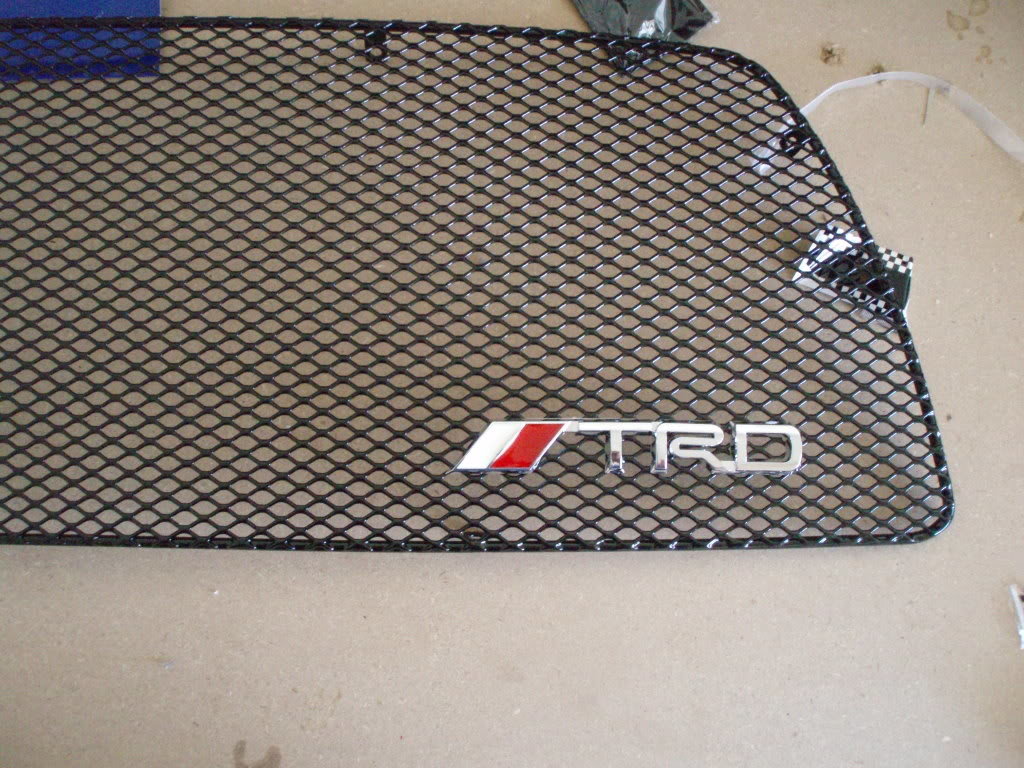

    TRD Grill symbol from ebay arrived over a week ago.
    I decided to move the horns while I was there. Simple mod just a little time consuming.

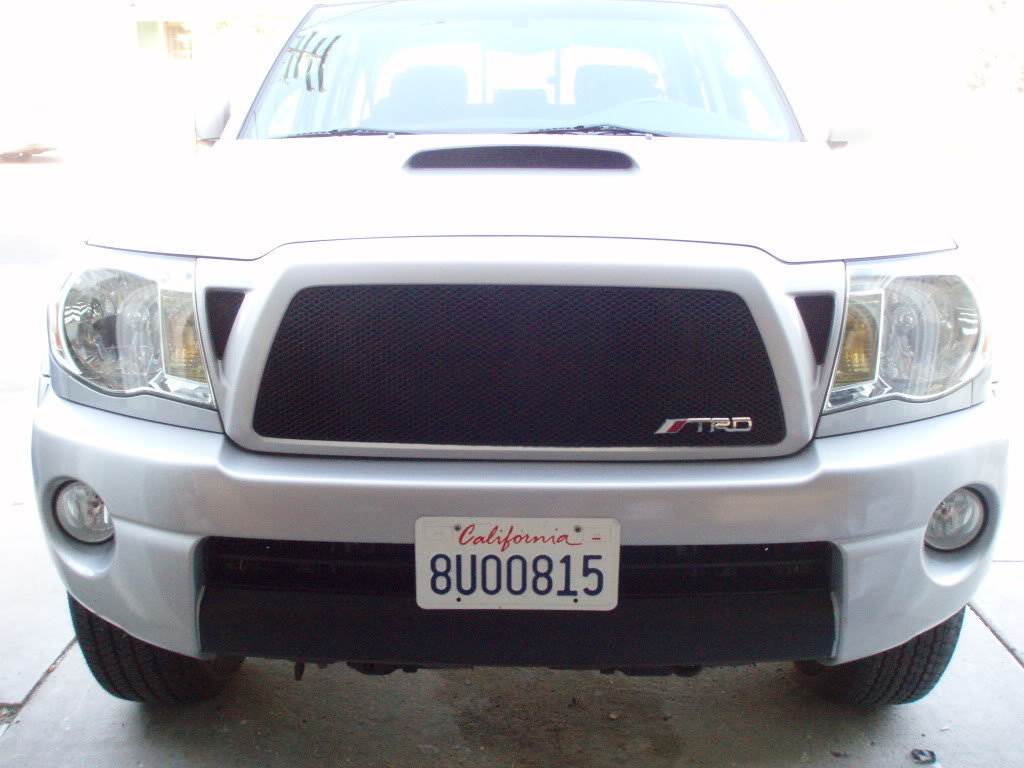

    looks great! How did you affix the TRD logo? Just double sided tape or what?
