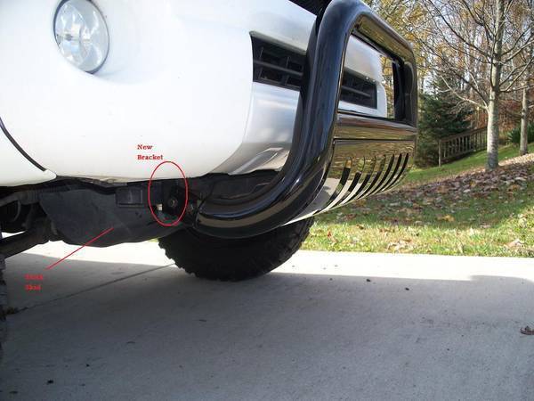

    I just ordered a Smittybilt bull bar feom prformance for trucks.....i got it for $154.99 shipped...i had to wait for about a month because i think they are made to order but it was worth the wait....easy to install and you do leave your stock skid in place...dont even touch a skid plate bolt....actually you only loosten 4 nuts all together that are on the truck...if you look down between your grille and radiator, you will see an aluminum block that bolts your frame to your bumper...take off the two outside nuts and put on the bracket....they provide another longer bolt to secure the mounting bracket then 4 bolts for the bull bar...ill attach a pic that shows the mounting bracket...hope this helps...and a link to where i got the bull bar

    The Arctic bar is similar to this where you mount it - the 4 bolts he is talking about mount directly to the bar, no adapter necessary.
