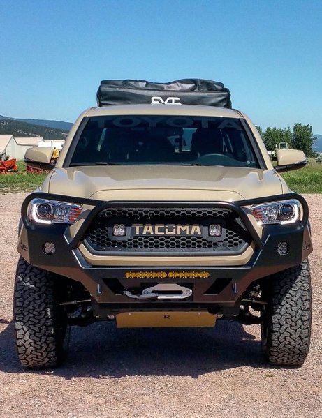

  15. Jun 12, 2017 at 12:20 PM
    bilplat
    bilplat Simply Driving Into Mordor
    Nov 30, 2016
    #203675
    247
    Bill
    Denver, CO
    '17 White A/T 4x4 TRD OR DCSB
    ARE Hard Top
    I know this isn't very helpful because of my lack of same-price alternatives, but I've heard many times on this site that these types of guards are actually "damage multipliers". Because of the lack of upper support (the thing only attaches to your frame at the bottom), these usually end up bending when in an actual collision with a bull, resulting in more damage to your front end than would occur without.
    I'm speaking from knowledge I've gained from lurking on this site and not from any real-world experience, so take it as you will.
    Humboldt_Homie, Bagow, RobP62 and 5 others like this.
  16. Jun 12, 2017 at 12:30 PM
    #16
    Thunder Fist
    Thunder Fist Well-Known Member
    Feb 11, 2017
    #210312
    5,613
    David
    Birmingham, AL
    2017 MGM TRD OR DCSB
    Like, so many.
    That's very inexpensive for a reason. We do have a group buy going on for the SSO Slimline bumper, it's close that price and is a much better product, but it doesn't offer much in terms of actual protection. SSO and others (C4, I know) do offer full protection front bumpers. They will be more expensive but they will certainly offer much greater protection.
    Check out the SSO Slimline and some of the other bumpers by them and C4 Fab. Heck, you can contact those guys on here if you want. They'll be happy to discuss your options.
    Buy once, cry once.

  18. Jun 12, 2017 at 12:42 PM
    #18
    skeeter1228
    skeeter1228 [OP] Active Member
    May 21, 2017
    #219572
    28
    Dan
    2017 TRD Offroad 4x4
    I like this c4 bumper much more (looks wise) than my ranch hand, but doesn't appear as sturdy and is twice the price. I guess I'm a little biased to the ranch hand because I've owned one and seen how it handled a deer.
    Plain Jane Taco likes this.
  19. Jun 12, 2017 at 12:49 PM
    #19
    Thunder Fist
    Feb 11, 2017
    #210312
    5,613
    David
    Birmingham, AL
    Like, so many.
    That C4 bumper is the real deal. It'll be much sturdier than the one you posted. ARB has one as well, but I think it's $1600.
    Hopefully some guys running the C4 will chime in and you give you their first hand thoughts. You can see some their stuff on YouTube.
  20. Jun 12, 2017 at 12:52 PM
    #20
    bilplat
    Nov 30, 2016
    #203675
    247
    Bill
    Denver, CO
    ARE Hard Top
    https://www.tacomaworld.com/threads...ront-bumper-installation-instructions.445309/
    Here's C4's installation instructions for that bumper. I'm basing this purely off two minutes of scanning the instructions, but I bet the C4 bumper can handle a deer collision way better than any bull guard. 1) it attaches to your truck at more spots (frame cross member AND aluminum crash bar member) and 2) its thicker plate steel, designed for taking hits from boulders while off-roading and to be used as a lifting point/winch support. I doubt any bull guard manufacturer will recommend using their product as either.
