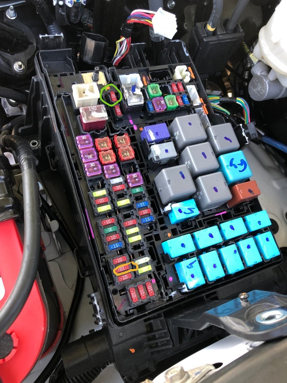

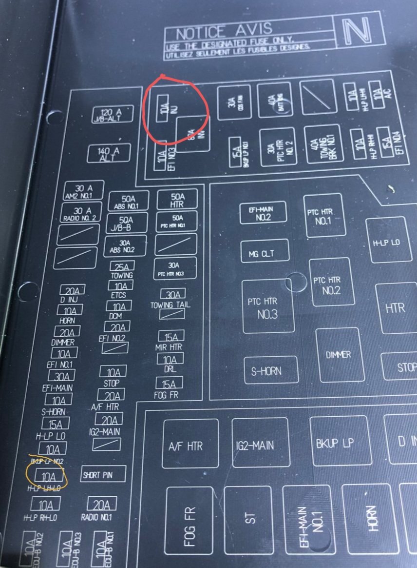

    I put mine on the headlight fuse (orange circle)
    Could also do Inj fuse (red circle)

    Your fuse block diagram is different than mine. What year truck?

    Uh that's not my fuse box lol. I ripped that from Google. Let's try again. Green circle is inj and orange circle is headlights. Using the headlights for raptor lights only turns em on when headlights are engaged, which is what I wanted

    Green circle only turns on when ignition is on
