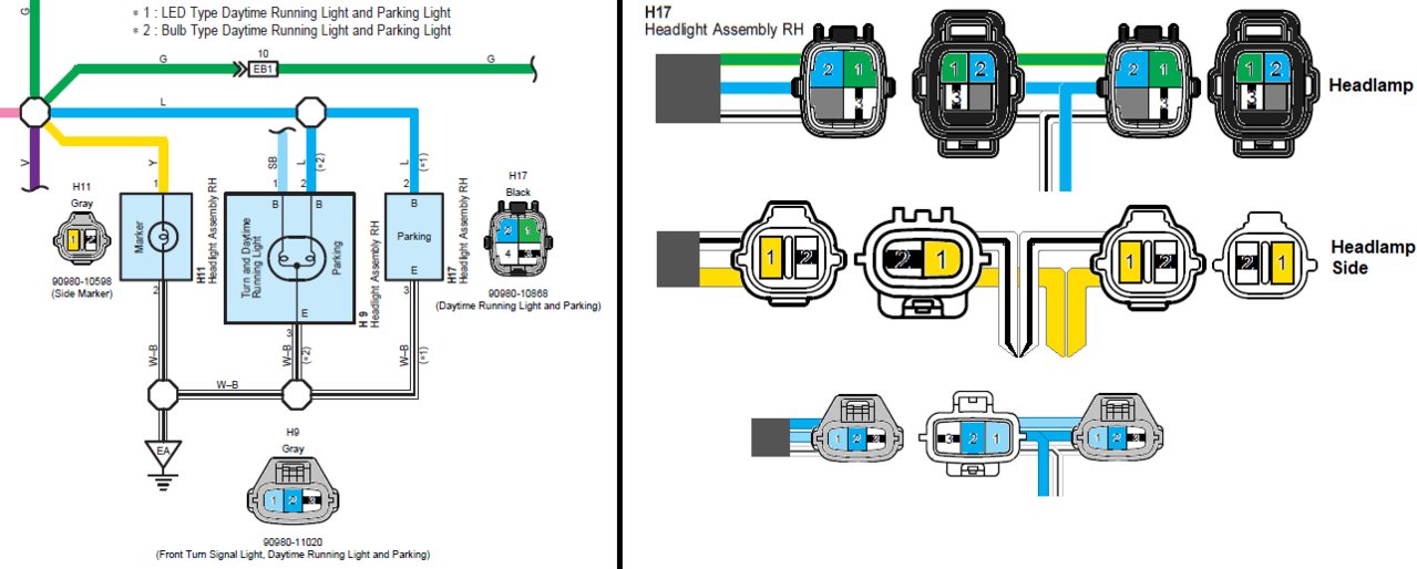

  10. Aug 19, 2022 at 3:06 PM
    Tacospike
    Nov 19, 2018
    #273198
    14,418
    512
    Two Trucks

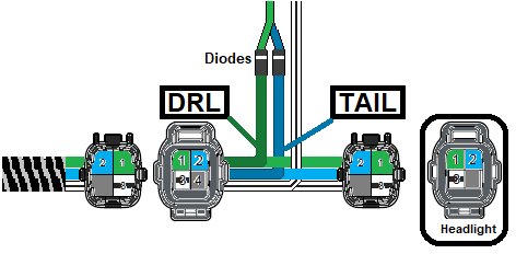

    Options to tie into the TAIL (Parking) circuit:

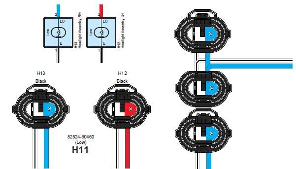

    Low Beam "tap":

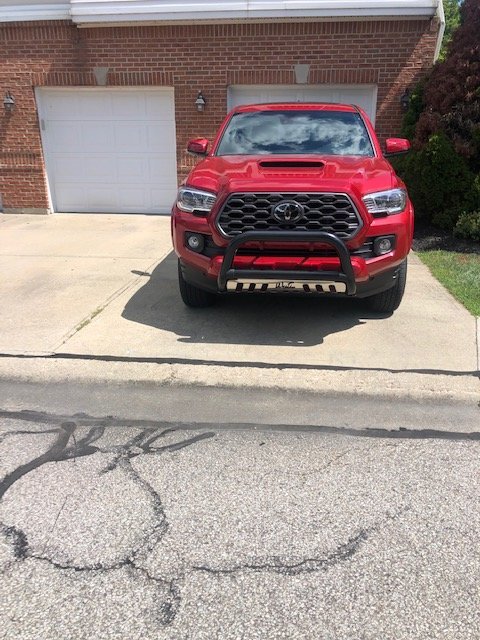

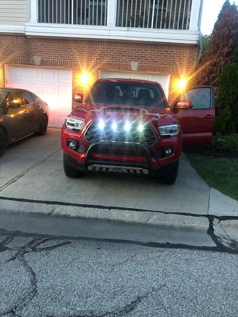

    Sorry for the fuzzy pic when lights are on. 2021 TRD Sport.

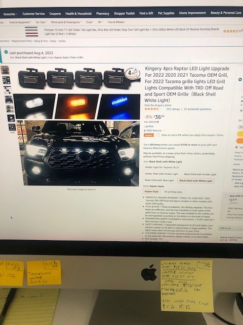

    This is what I used. They snap in from the back quite snugly. I paid less than $30. I guess Jeff Bezos needs a new yacht.
