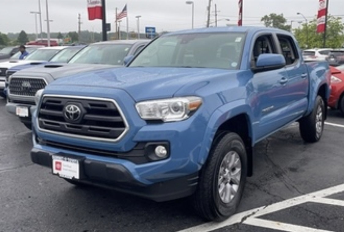

    Hi all, just traded in my 2nd gen and picked up a 3rd gen 2019 SR5. Not very keen on the grille though.. would prefer the look of a sport or off road. I believe the sport grille would just be a drop in replacement but would the off road grille work? Just want to get it straight before I start looking for one to buy.

    The sport grill is the off road grill, and vice versa. All OEM grills are interchangeable on any model

    except for the pro, right? Because of the sensors?

    The Pro grille just moves the sensor down a few inches (to account for lift, I believe). All grilles will fit all models.

    OP, check out this old thread on Pro grilles. You will see many posts of Sport and Off Road owners that were putting on your SR5 grille because they did not like all the chrome of the original grille. However, mods are very personal so do what makes you happy.

    Good morning. Will the bezel from a 2020 fit around the grill of a 2022? Its chrome as you know oem and I wanna go black
